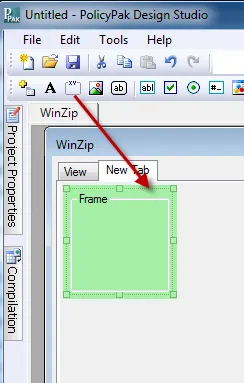

While editing your AppSets, you might want to put elements in a scrollable panel, or Netwrix Endpoint Policy Manager (formerly PolicyPak) DesignStudio might capture a scrollable panel that you want to edit. In Figure 154, you can a frame being added with the "Frame" button.
adding_space_to_scrollable
Figure 154. Adding a frame button.

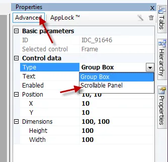

Frames can be changed to scrollable panels by selecting the "Advanced" button, and then changing the type to "Scrollable Panel" as shown in Figure 155.
adding_space_to_scrollable_1
Figure 155. Changing the frame to a scrollable panel.

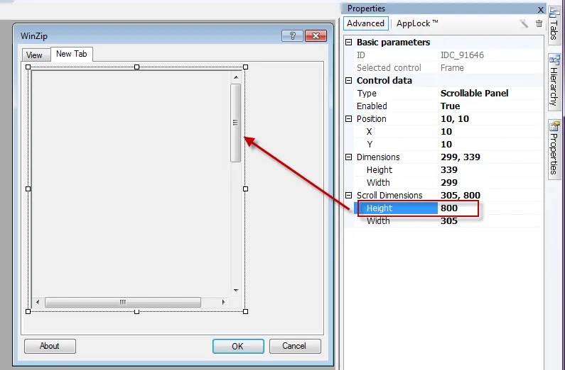

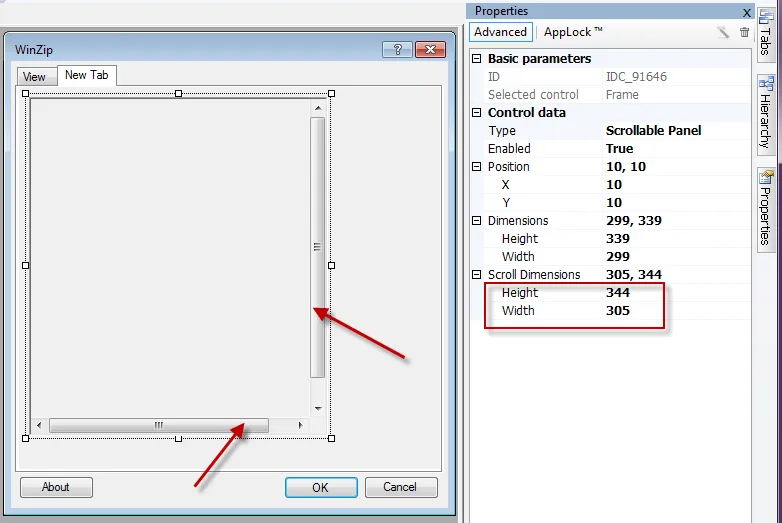

When you do this, you'll see the frame convert to a scrollable panel, as shown in Figure 156. DesignStudio will enter in some suggested values for the height and width of the panel; however, you are able to modify them. For instance, if you want to make a tall panel, change the "Height" value for more vertical space. You can also change the "Width" value and get more horizontal space. You can see an example of how to do this in Figure 157.
adding_space_to_scrollable_2
Figure 156. A frame converted to a scrollable panel.
adding_space_to_scrollable_3
Figure 157. Changing the dimensions of a scrollable panel.
