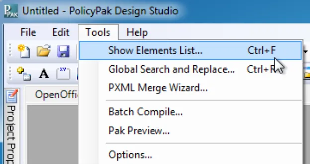

To that end, Endpoint Policy Manager DesignStudio has a "Show Elements List" feature (also known as "List All Elements"), which is found by selecting Tools|Show Element List. You can also use the keyboard shortcut Ctrl+F to go to this list, as shown in Figure 171.
using_designstudio_tools_7_624x330
Figure 171. Selecting the "Show Elements List" feature.

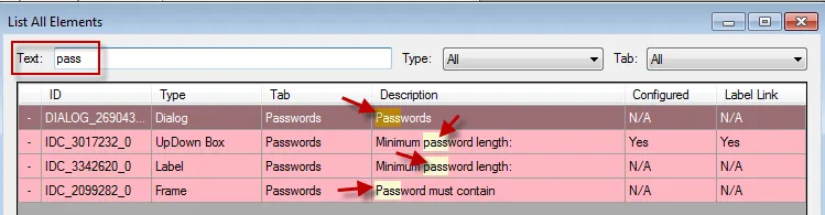

The List All Elements box shows you which elements will work in Endpoint Policy Manager Application Settings Manager Community Edition and which ones will only work when fully licensed (or in Trial Mode). Additionally, you can focus your search by text (which searches the Description field). In Figure 172, you can see the search for the word "pass," and every result has the word "pass" in the results in the Description field. You can also select the type of element, or search specifically on a specific Tab within your project.
using_designstudio_tools_8
Figure 172. Searching by text in the "List All Elements" box.

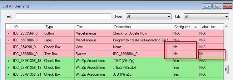

You can also use the "List All Elements" dialog to help determine which elements are not yet configured inside the AppSet. To do this, sort on the Configured column, then look for items that have "No" in that column, as shown in Figure 173. Double-click the item to zoom to the item, then right-click to run the Configuration Wizard to configure it.
using_designstudio_tools_9
Figure 173. Determining which elements have not been configured.
NOTE: Items with N/A in the Configured column cannot be configured, like labels, frames, and tabs. Items with N/A in the Label Link column do not need to be labeled, as they are self-labeling, like checkboxes, etc.

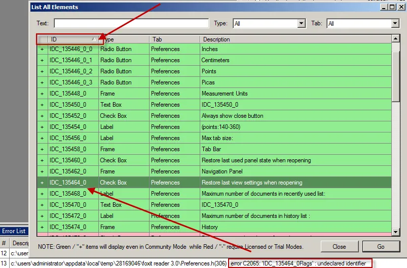

Lastly, in the rare instances when compiling your AppSet fails, you may be able to help troubleshooting efforts by locating the ID number of the element that is causing problems. In Figure 174, you can see compiler error list at the bottom showing an ID number with a problem. By sorting the "List all Elements" items by ID number, this element can be quickly found.
using_designstudio_tools_10
Figure 174. Sorting elements by ID number.
NOTE: The color coding is only to express if the element will work in Community Edition or Licensed Mode and Trial Mode.
NOTE: Sometimes disabling the item can help you continue to compile the AppSet. You should send any failed compiles to support@endpointpolicymanager.com along with your pXML file for inspection.
