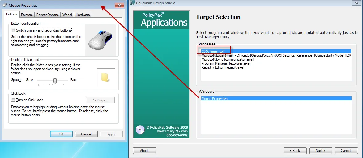

When you start a new project after running Endpoint Policy Manager DesignStudio, you are asked to select the application and the correct window, as shown in Figure 59. Sometimes the process name is not obvious.
Be sure to capture the Options or Configuration window of an application, and not the main page, which will often not capture at all and is likely not be what you wanted to capture. Remember that you will mostly be capturing options, properties, and configuration pages.
Figure 59. Selecting the target application and window.
NOTE: See the section entitled "Special Applications and Project Types" for more information on how to manage Control Panel items, like the mouse properties shown in Figure 58.

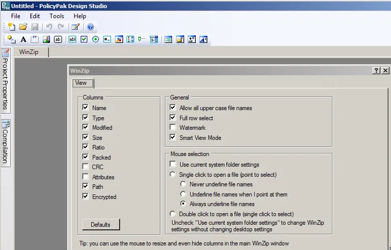

In most cases, your application's look and feel is exactly captured, as shown in Figure 61.
Figure 61. Capturing the look and feel of the application.
Endpoint Policy Manager DesignStudio usually captures the existing states of the elements as well, such the status of a checkbox or radio button.
