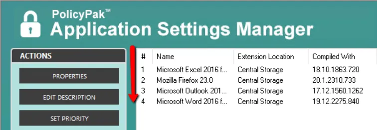

However, you could occasionally have multiple AppSets overlap each other with certain settings you've engaged. As a result, you might want to ensure that the delivery of those settings occurs in a particular order. As seen in Figure 55, Endpoint Policy Manager Application Settings Manager enables you to specify which AppSet is delivered in which order.
Figure 55. The order in which the Paks (in this scenario) are delivered.
Paks within a GPO are processed in order from lowest to highest.

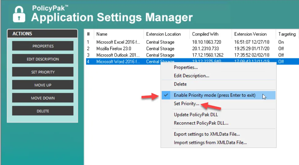

To change the priority of a particular AppSet, simply right-click on it within the GPO and select either "Enable priority mode (press Enter to exit)" or "Set priority," which are both shown in Figure 56.
Figure 56. By clicking "Enable priority mode (press Enter to exit)," as shown here, you can change the priority of a specific Pak.
When you select "Enable priority mode (press Enter to exit)" you can then move the AppSet up and down using the arrow keys. When you are satisfied with the position, press Enter to complete the edit.

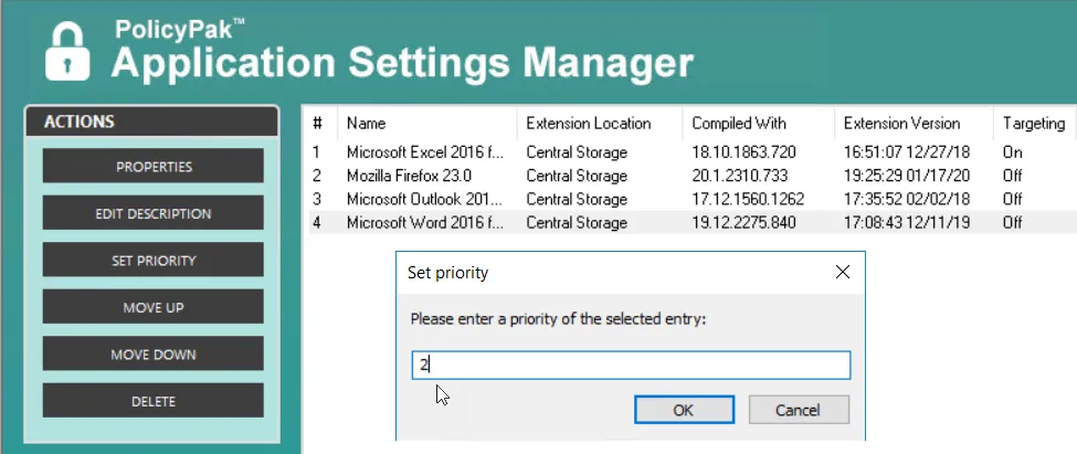

You can also select "Set priority," which will enable you to specify a numeric value, as shown in Figure 57.
Figure 57. By clicking "Set priority," as shown here, you can change the priority of a specific Pak by setting the numeric value.
The AppSet you've selected will take that priority number, and the rest will be lowered in priority.
