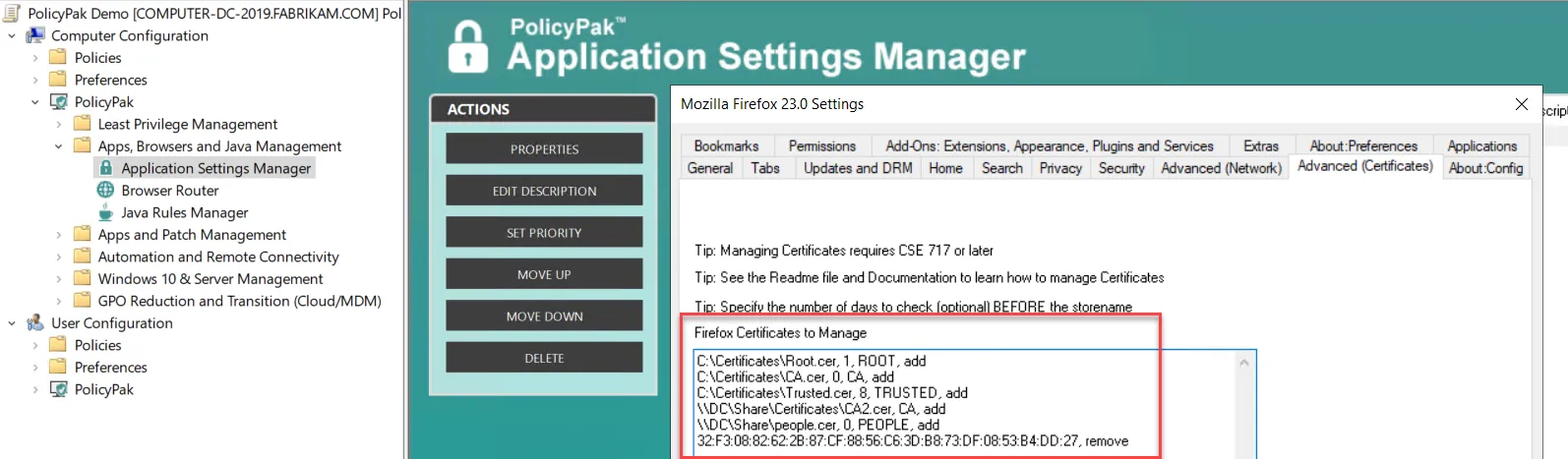

To manage Firefox's certificates, you need to specify the location of the certificate to import (source) and the location where you want to deliver it (target). The source location can be local, on a file server, etc.
certificates_1
Figure 43. Specifying the Firefox certificate location.

You can also specify how often (in days) the source certificate file should be checked for changes using the following: \\DC\Share\Fabrikam-CA.cer, 1, ROOT, add. If the optional parameter is not specified, it defaults to 0, meaning that the client-side extension (CSE) will re-read the certificate file every time Firefox starts. Note that if the file is unavailable or the remote location is offline, the launch of Firefox is not slowed down. Additionally, you might want to deliver certificates to all these stores, as shown in Figure 44.

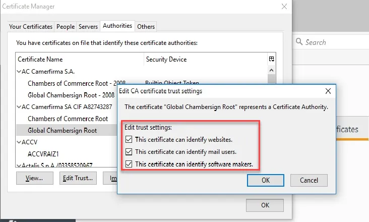

certificates_2
Figure 44. Editing the trust settings.
To do so, use the following syntax: \\Server\Share\FF.cer,1,C;C;C,add. Note that the certificate authority is omitted in this correct syntax. For more information on this advanced syntax, see the following

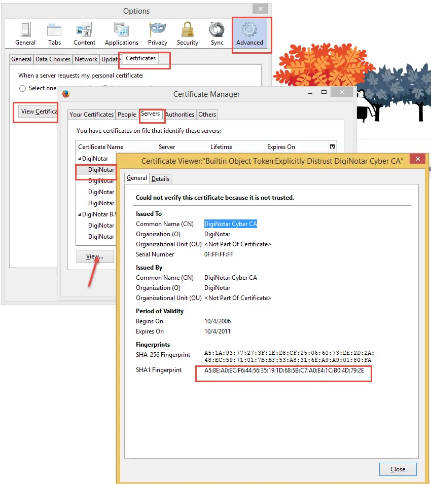

To delete a certificate, you must know its SHA 1 fingerprint. You do not need to specify where the certificate is currently stored; if the fingerprint matches a certificate in any store, it is removed.
certificates_3
Figure 45. SHA Fingerprint location.

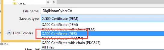

Endpoint Policy Manager can only work with binary-encoded DER certificates. If you have a certificate of another type, you may import it first into Firefox. Then, you can immediately export it as a DER file, as shown in Figure 46.
certificates_4
Figure 46. Explorting a certificate as a DER.

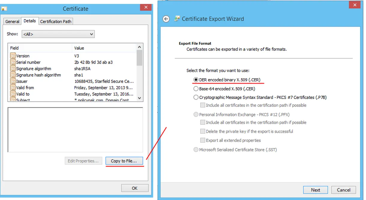

You can optionally perform the same type of export by looking at the file itself in the Details tab of Explorer, and then selecting the "Copy to File" button. Then, select "DER encoded binary X.509 (CER)," as shown in Figure 47.
certificates_5
Figure 47. Exporting via Explorer.

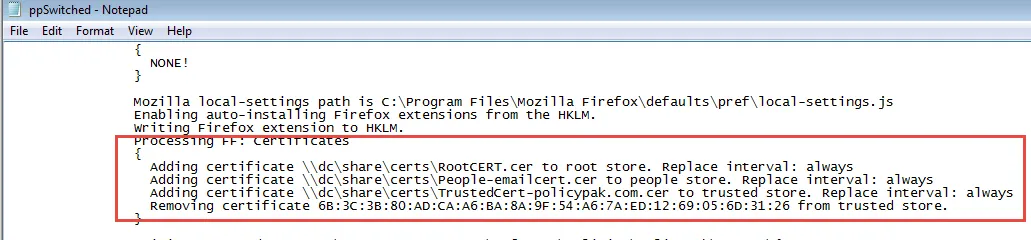

If you are not seeing the results you expect, you can look in Endpoint Policy Manager's logs (see Book 3: Application Settings Manager for more information) as well as Firefox's log. An example of Endpoint Policy Manager's log showing that certificates are correctly being added can be seen in Figure 48.
certificates_6
Figure 48. The Endpoint Policy Manager log with certificate details.

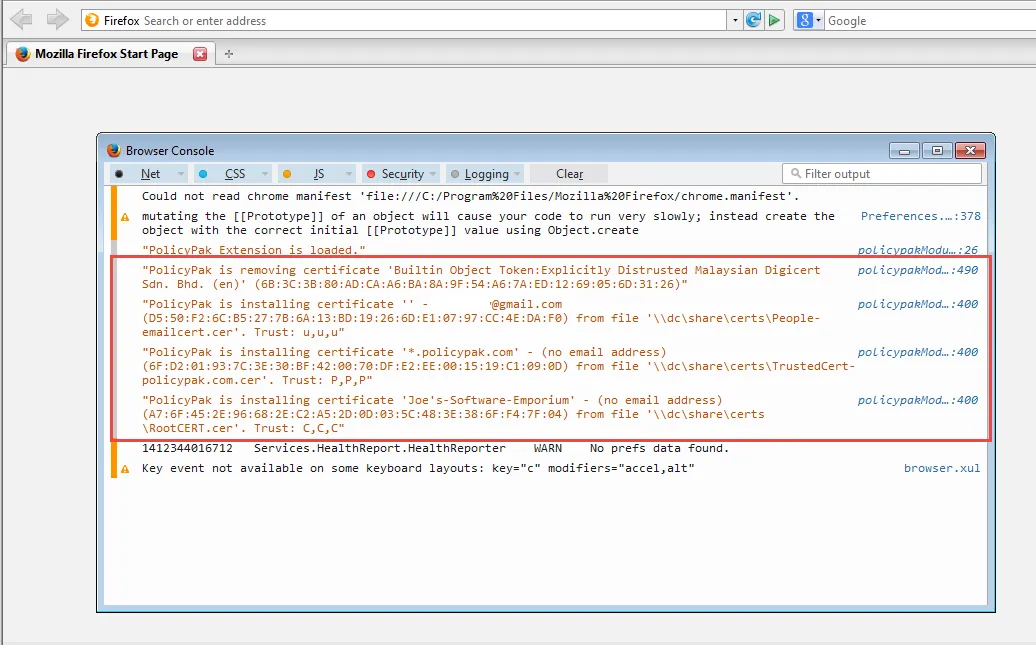

You can also use Firefox's log by clicking Ctrl+Shift+J on any page. In the log below (Figure 49), you can see certificates being added to the proper stores.
certificates_7
Figure 49. The Firefox log with certificate details.
