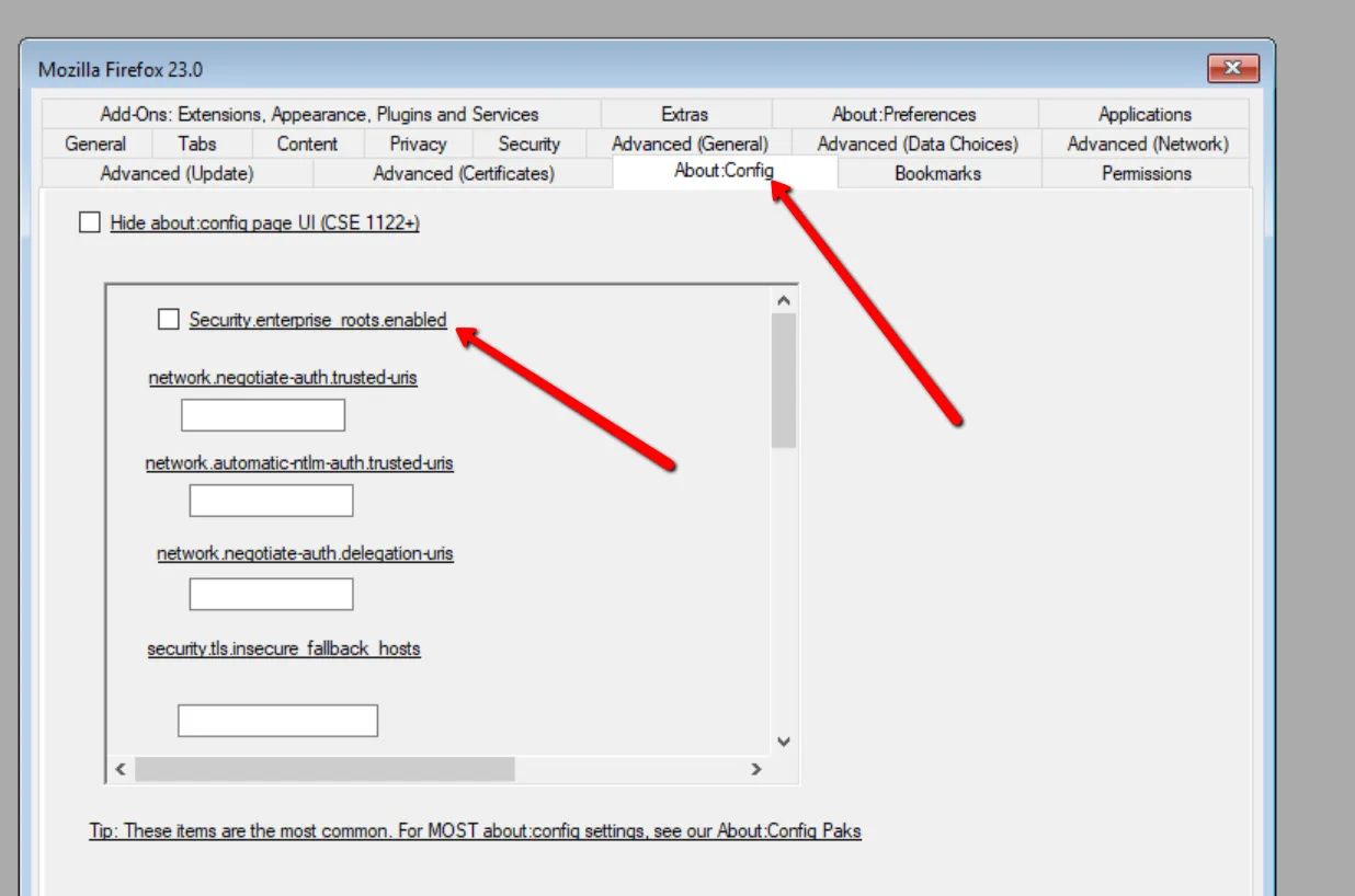

Way #1:
Inside the main Firefox Pak itself
Way #2:

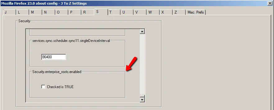

Using the Firefox About:Config Pak J thru Z.
It is the last entry in the S: category
