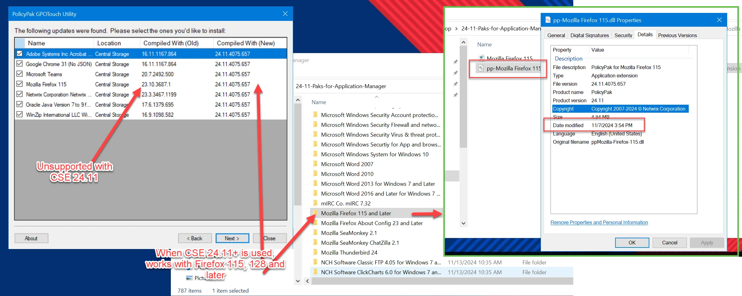

Update for 24.11 CSE
Firefox 128 has made a breaking change requiring an update to the CSE and the Firefox 115 and later Pak to continue functioning.
The only supported configuration going forward for Firefox 128 support is CSE 24.11 (or later) and the Firefox 115 and later pak, which is compiled (and signed) from Netwrix with date stamp 11/7/2024 and later.

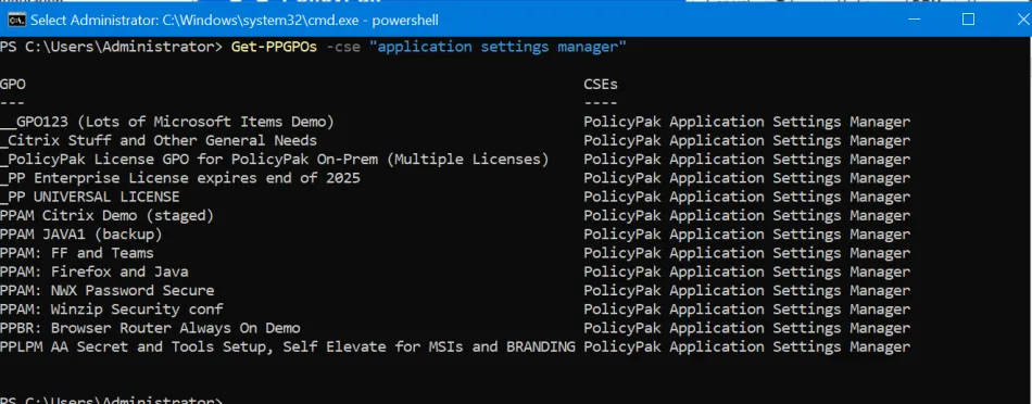

You'll want to first discover all GPOs with Endpoint Policy Manager Application Settings Manager Data, and those with specific Firefox 23 AppSets. That being said, automation can only help you discover which GPOs contain Endpoint Policy Manager Application Settings Manager data. After that, you must open each Group Policy Object one by one and manually look for FF23 AppSet data.
Overview of using the Endpoint Policy Manager PowerShell cmdlets to discover Endpoint Policy Manager data within GPOs see the Endpoint Policy Manager User PowerShell to find all Endpoint Policy Manager GPOs topic for additional information.
939_1_image-20231101213809-1_950x372
The specific command you'll want to run is Get-PPGPOs -cse "application settings manager".

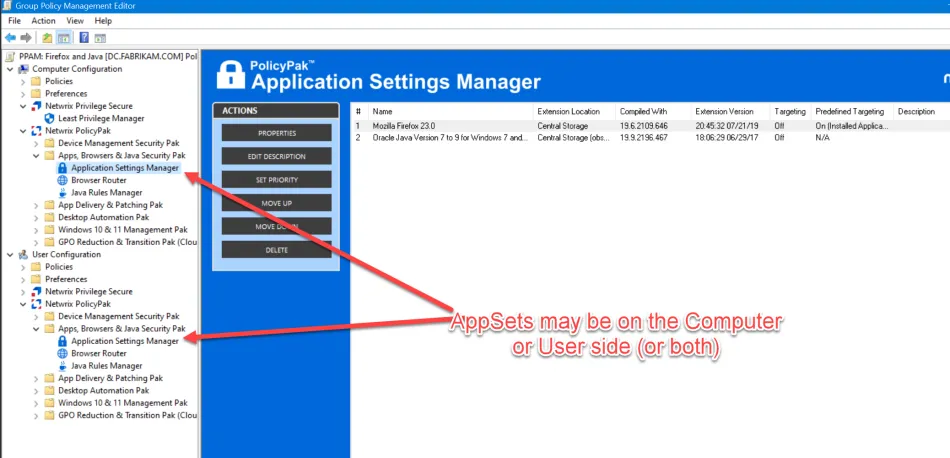

Each Group Policy Object at this point will need to be opened to look for Firefox 23 AppSets. Here is an example of the FF23 AppSet on the Computer side, though it may also reside on the User side.

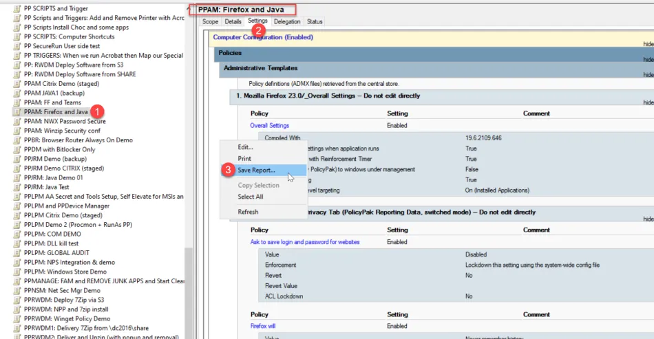

Back up 1: Viewing the Group Policy Object Report and saving the HTML report.
939_3_image-20231101213809-3_950x493
This won't be your only backup, but it will express exactly what is in your Group Policy Object with regards to your settings.

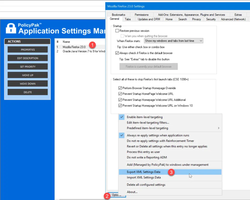

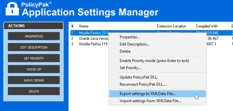

Back up 3: Export the settings for each FF23 AppSet you already have.
Open each FF23 AppSet and locate the Options button. Then click Export XML Settings Data and save the file out.
939_4_image-20231101213809-4_950x761
See the What are the two ways to export AppSet settings and why would I use one over the other?
NOTE: You will use the resulting XML file in an upcoming step and not only for backup purposes.

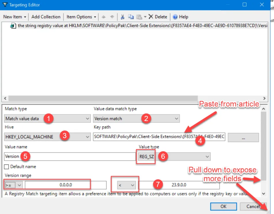

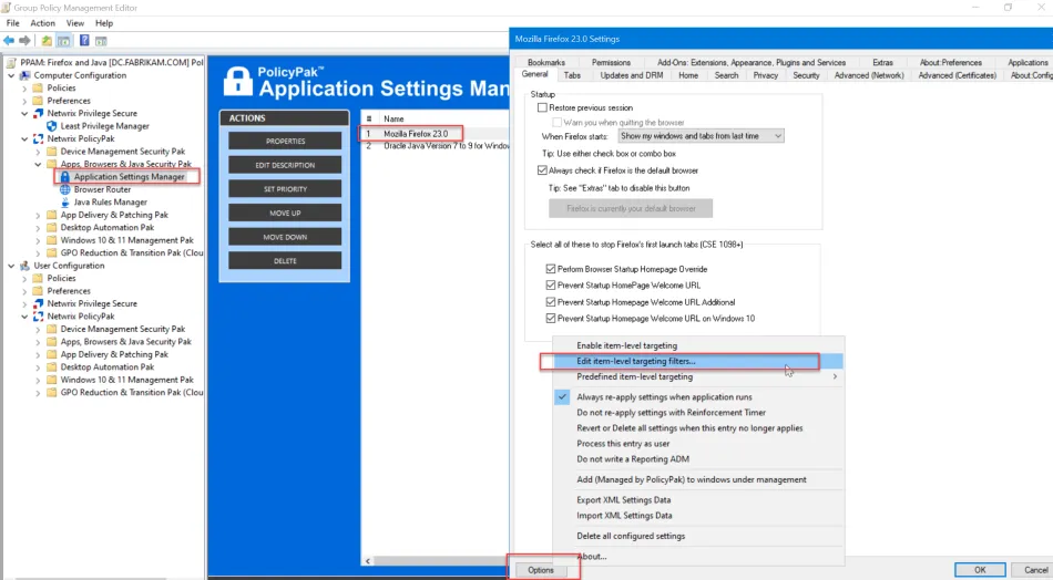

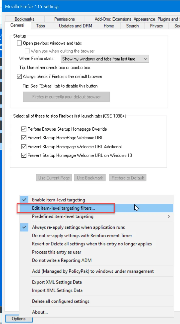

Find your existing FF23 AppSet in your Group Policy Object(s) and select "Edit item-level targeting filters…"
939_5_image-20231101213809-5_950x524
You can test for the presence or absence of Endpoint Policy Manager CSE version 23.09.0.0 with a Registry match query for:
  • Match type: Match value data
  • Value data match type: Version match
  • Hive: HKEY_Local_Machine
  • Key Path: SOFTWARE\PolicyPak\ClientSide Extensions\{F8357AE4-F4E0-49EC-AE9D-61078938E7CD}
  • Value Name: Version
  • Value Type: REG_SZ
  • Version Range: GREATER THAN 0.0.0.0 and LESS THAN 23.9.0.0

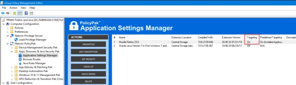

When done save the values. You will know you have ILT set when you see the Targeting column change to ON.
939_7_image-20231101213809-7_950x273

Optional: Testing the ILT Filters on FF23 using the Endpoint Policy Manager Item Level Targeting Validation Tool
Tip: You can also export the FF 23 settings to XMLdata File format and use part of the output to verify the Item Level Targeting will evaluate to TRUE or FALSE. To do this, right-click the entry and select Export settings to XMLData file and save the file. Then use the Endpoint Policy Manager Item Level Targeting Validation tool to test how ILT will operate. See the Troubleshooting ILT with the ILT Validator Tool topic for additional information.
NOTE: You will have to trim the ILT part of the output to eliminate the <ILTFilters> at the beginning and </ILTFilters> at the end.

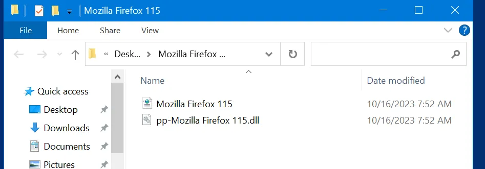

After you download the FF 115 AppSet from the Endpoint Policy Manager portal, it will appear like this. You only need the .DLL file and not the XML file.
939_10_image-20231101213809-10

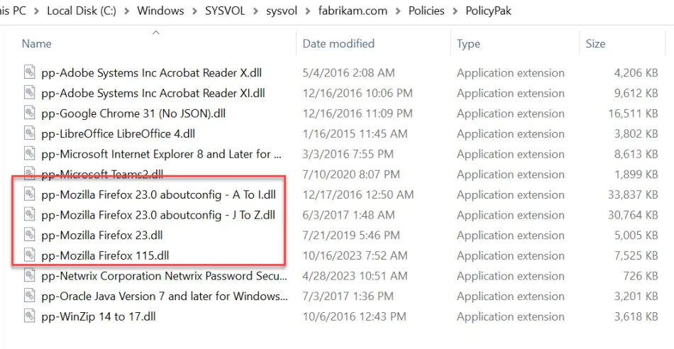

For example in the Endpoint Policy Manager Central Store you simply add the pp-Mozilla Firefox 115.DLL.
NOTE: You may leave your existing pp-Mozilla Firefox 23 aboutconfig A to I and J to Z.DLL files in place without modification.

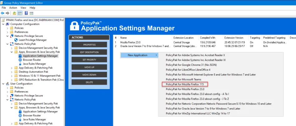

Next time you open the Group Policy editor you should see Endpoint Policy Manager For Mozilla Firefox 115.
Using the FF 115 AppSet

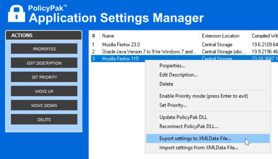

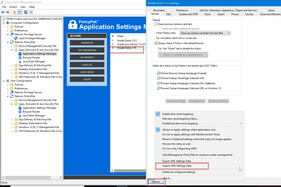

Now you can create a new entry for the FF 115 AppSet, import the previously exported FF23 settings into the FF115 AppSet and also set Item Level Targeting on the FF 115 AppSet so it only applies to computers with the latest Endpoint Policy Manager CSE.
After creating the entry, double-click into it to open it up and select Import XML Settings Data.
939_13_image-20231101213809-13_950x633
Then select the previously exported settings from the FF 23 AppSet. You should get a SUCCESS message.

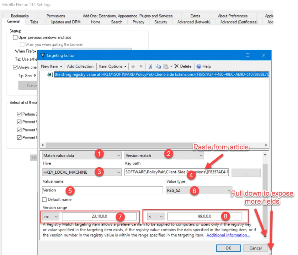

Next, set the Item-level targeting in the AppSet.
939_14_image-20231101213809-14
FF AppSet 115 should be applied only to machines with Endpoint Policy Manager CSE version 23.10.3687 or Greater and can be determined with a Registry match query for:
  • Version Range: GREATER THAN OR EQUAL TO 23.10.0.0 and LESS THAN 99.0.0.0

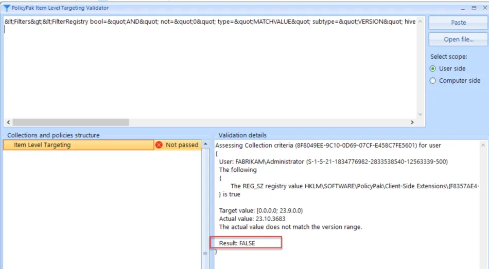

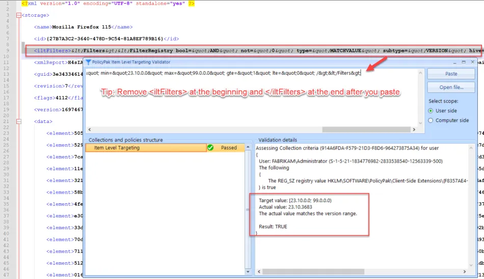

You can also export the FF 115 settings to XMLdata File format and use part of the output to verify the Item Level Targeting will evaluate to TRUE or FALSE. To do this, right-click the entry and select Export settings to XMLData file and save the file. Then use the Endpoint Policy Manager Item Level Targeting Validation tool to test how ILT will operate. See the Troubleshooting ILT with the ILT Validator Tool topic for additional information.
Note that you will have to trim the ILT part of the output to eliminate the <ILTFilters> at the beginning and </ILTFilters> at the end.
You can test the ILT evaluation by using the Export settings to XMLData file for the Mozilla Firefox 115 entry.
939_16_image-20231101213809-16_950x543
Then you can use the ILT Evaluator tool to ensure your ILT evaluation is properly crafted and the AppSet will only target machines with the latest Endpoint Policy Manager CSE.
939_17_image-20231101213809-17_950x549

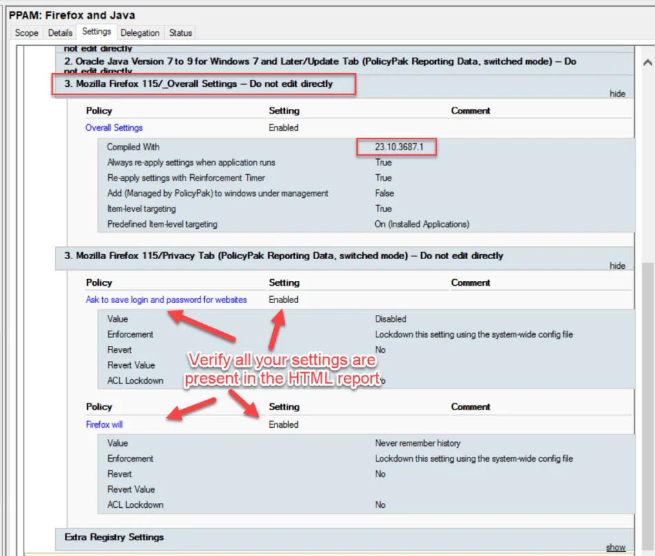

HTML Settings Report Manual Comparison
In one of the backup steps we recommended you export the FF23 GPMC HTML report. At this point you may also want to double-check the FF115 GPMC report for any discrepancies or omissions in the export/import process.
If you don't see an expected value this could be because (1) the FF115 Pak was updated to remove some values which appear to be unsupported in modern Firefox versions or (2) Some part of the Export from FF23 and import to FF115 didn't work as expected.
In such a case as case 2, please manually open the FF115 Pak and manually update your settings to correct for any non-imported settings.
