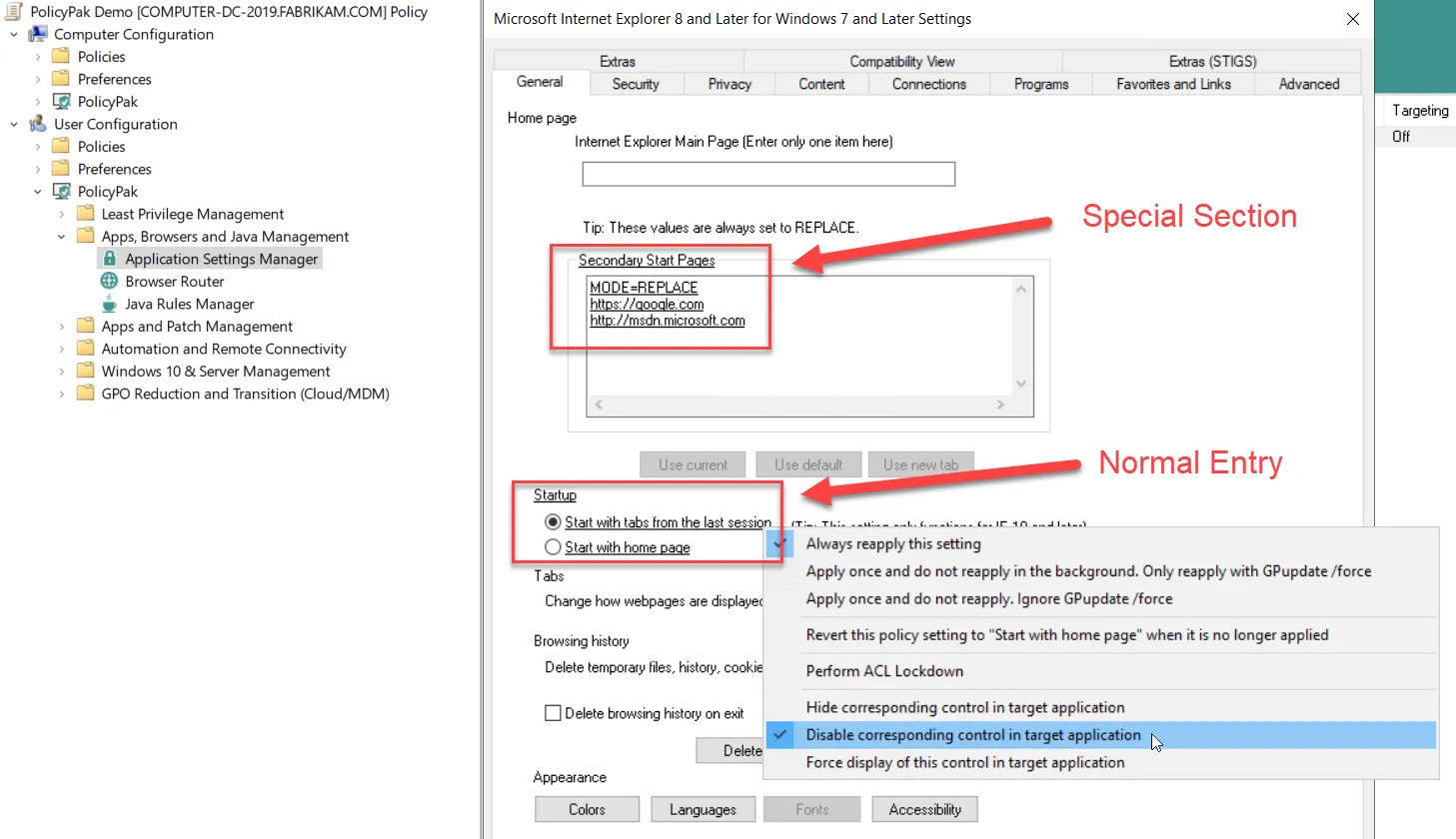

Normal Sections in the IE AppSet
In the normal sections of the IE AppSet, you can click on items to select a setting. However, the IE AppSet also has some special sections. You can see an example of a special section in Figure 2.
normal_sections_in_the_ie
Figure 2. Special and normal sections in the IE AppSet.
The normal sections act just like sections in all other Netwrix Endpoint Policy Manager (formerly PolicyPak) Application Settings Manager AppSets. By clicking on a setting, it becomes underlined, and you can set special values like "Revert this policy setting to the default when this is no longer applied" or "Disable corresponding control in target application." The rest of this document will describe how to use the special sections in the IE AppSet.
