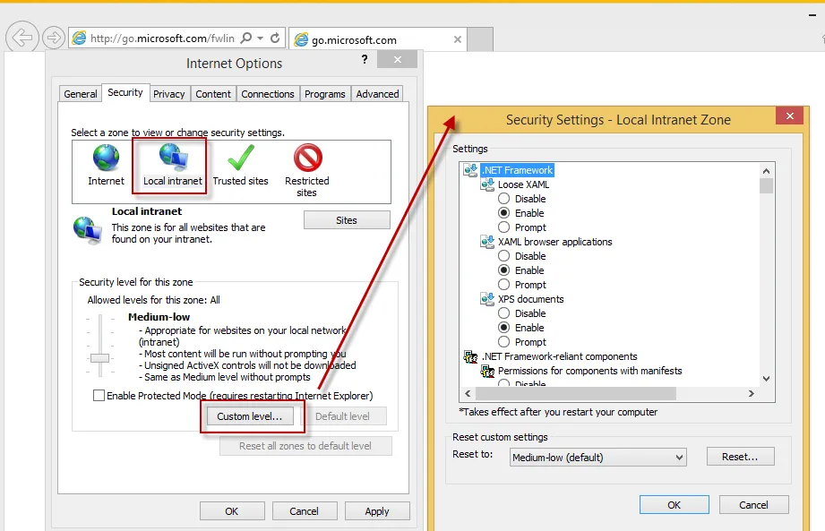

The Security tab lets you set levels for all four zone types. The dialog within IE can be seen in Figure 6.
ie_appset_tab_by_tab_2
Figure 6. Custom security settings for all four zone types.

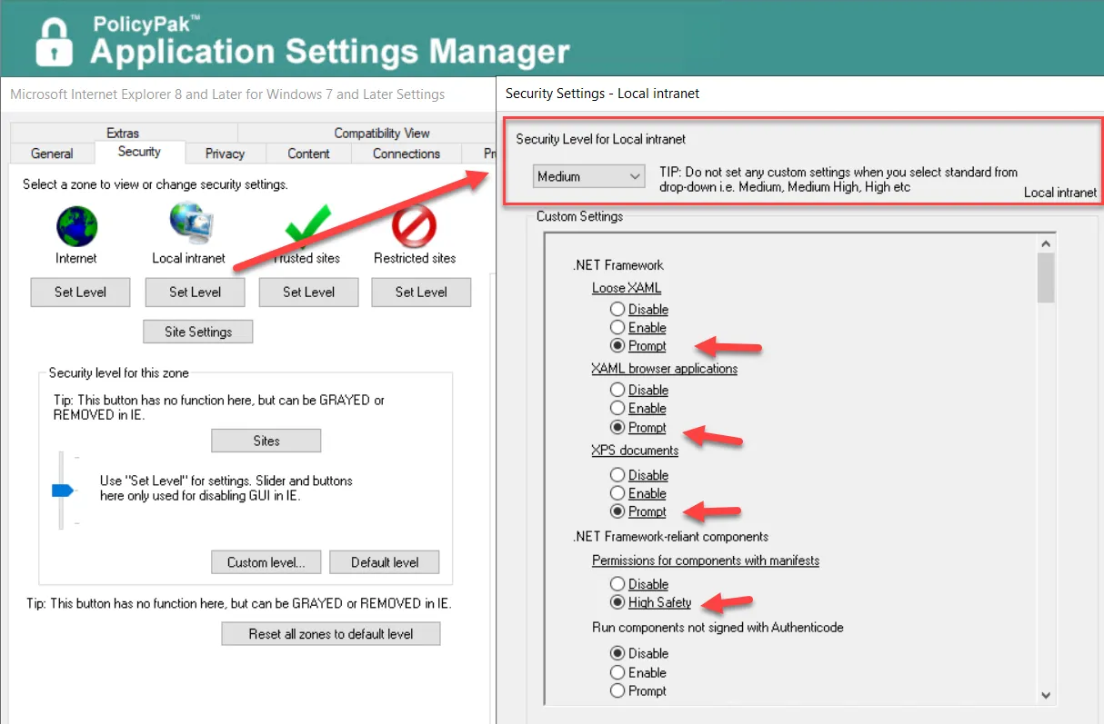

Using the Endpoint Policy Manager IE AppSet, click on "Set Level" for the corresponding zone and select your level (or select "Custom"). Do not set any custom settings when you select a standard option from the drop-down menu, such as Medium, Medium High, etc.
ie_appset_tab_by_tab_3
Figure 7. Custom settings for the local intranet zone.

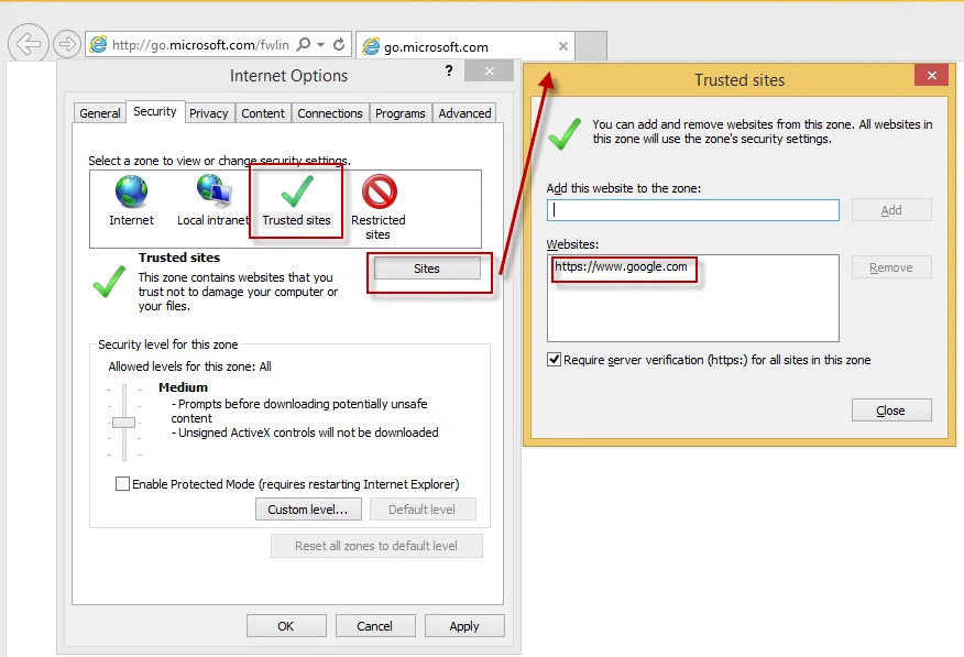

Internet Explorer has a rich way of adding site to zone assignments, as shown in Figure 8.
ie_appset_tab_by_tab_4
Figure 8. Adding site to zone assignments in Internet Explorer.

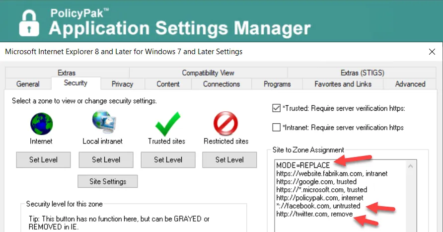

The IE AppSet Security tab Site to Zone Assignment is shown in Figure 9.
ie_appset_tab_by_tab_5
Figure 9. Setting site to zone assignments in the IE Pak.
On the first line, you can specify MODE=REPLACE or MODE=MERGE. If you don't specify, the default is MODE=MERGE. All other lines should take the form ofhttp://or https:// followed by a comma and one of the following words:
  • intranet
  • internet
  • trusted
  • untrusted
  • remove
This will deliver the web page into the corresponding zone or remove the web page from any zone if "remove" is specified.
