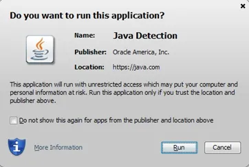

Java: How to disable Java prompt "Do you want to run this application?"
Visiting a site with Java enabled content you may see this prompt, confirming if you want to run the JRE code located on that location.

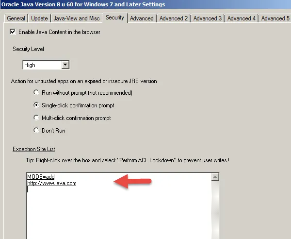

Solution:
Setting up these couple of settings will get away this prompt. First add the location in the trusted sites in exception list. Then set the "Enable – hide warning and run with protection" under "Sandbox vs. Trusted Security verification".
