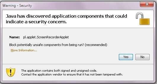

If you get the following pop-up:
158_1_uhae4
the pre-configured Java AppSet can adjust for that. However, know that we are not magically "increasing" your security here, simply delivering the value that forces Java to stop the pop up.

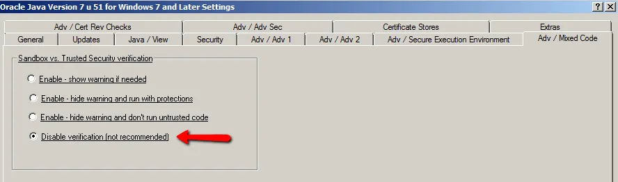

The setting located in our pre-configured AppSets for Java is:
Java 7 Pak technique:

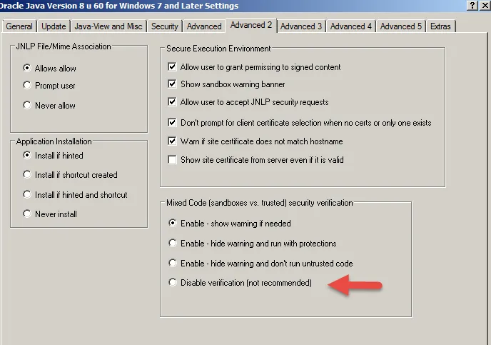

Java 8 AppSet technique:
158_3_13-8
