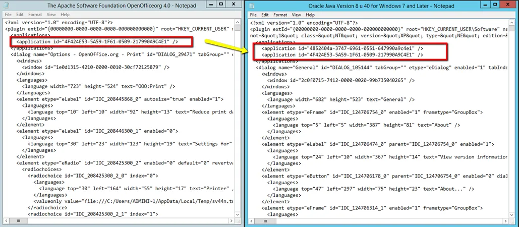

Step 4 – Add the application ID from the OpenOffice pak to the Java Pak as seen below using Notepad. Note the AppID in the might be different than what is in this screenshot and/or have multiple AppIDs. Simply preserve the existing ID, and append as seen here.

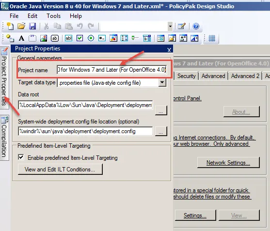

Step 5 – Open the Java Pak XML in the Endpoint Policy Manager DesignStudio. Update the Project name so it's clear what it's doing. Then recompile.

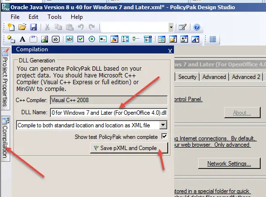

Step 6 – Give the Pak a new DLL name and Recompile the Pak

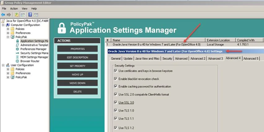

Step 7 – Use the new Pak in Endpoint Policy Manager Application Settings Manager . Your ThinApp package's Java will automatically be configured at this point with the settings you dictate.
