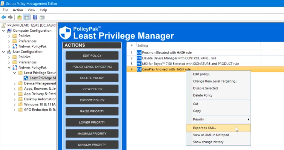

Exporting existing Endpoint Policy Manager settings within Group Policy to XML and importing them into Endpoint Policy Manager Cloud.

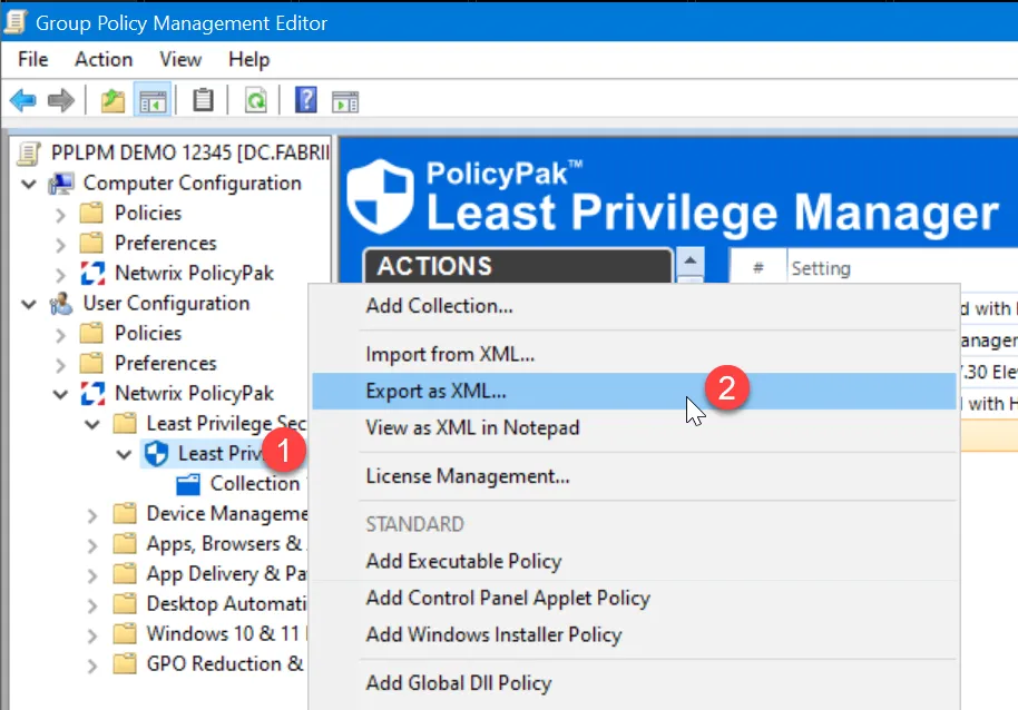

Continue to export your existing invested Endpoint Policy Manager settings into XML format.

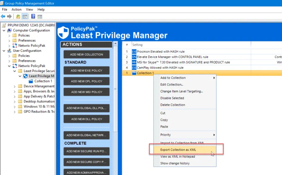

You can export one setting at a time like this:
You can export a Collection like this:
Or you can export a whole category like this:

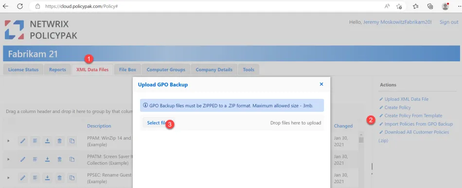

Optional: Backup and Restore entire GPO to Endpoint Policy Manager cloud
You might also have a GPO with a lot of settings, which contain Microsoft and/or Endpoint Policy Manager settings. You can transfer the whole contents of that GPO with a GPO Backup and Endpoint Policy Manager Cloud Import.
The result will be a de-constructed GPO with all relevant parts as XML, available to re-link later to Company or Azure groups.
See the How to import GPOs to Endpoint Policy Manager Cloud topic for additional information.

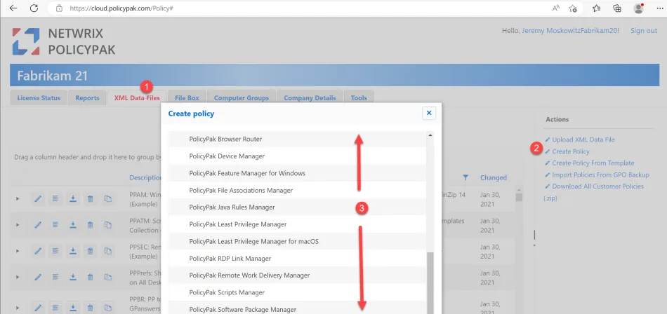

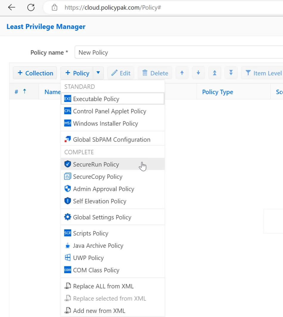

Use In-Cloud Editors to create and update rules (for most policies)
Now that all your rules are lifted and shifted from GPO Editor to XML to Cloud, you can use the in-cloud editors to perform most new policy types and edit existing policies.
Here’s an example of how to use the Endpoint Policy Manager Cloud in-cloud editors to create and edit Endpoint Policy Manager Least Privilege Manager items.
See the Use Endpoint Policy Manager Cloud to deploy PP Least Privilege Manager rules topic for additional information.

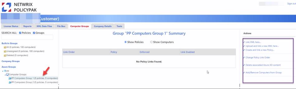

Using Endpoint Policy Manager Cloud to create company groups and/or use the Endpoint Policy Manager Cloud to Azure connector

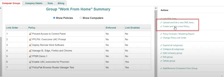

Now you can craft your Company Group assignment and then adding computers to it.
See the Working with Groups topic for additional information.
An example of crafting your own Company groups, linking existing XMLs, creating new policies and Adding/Removing computers from these Company Groups can be seen here.

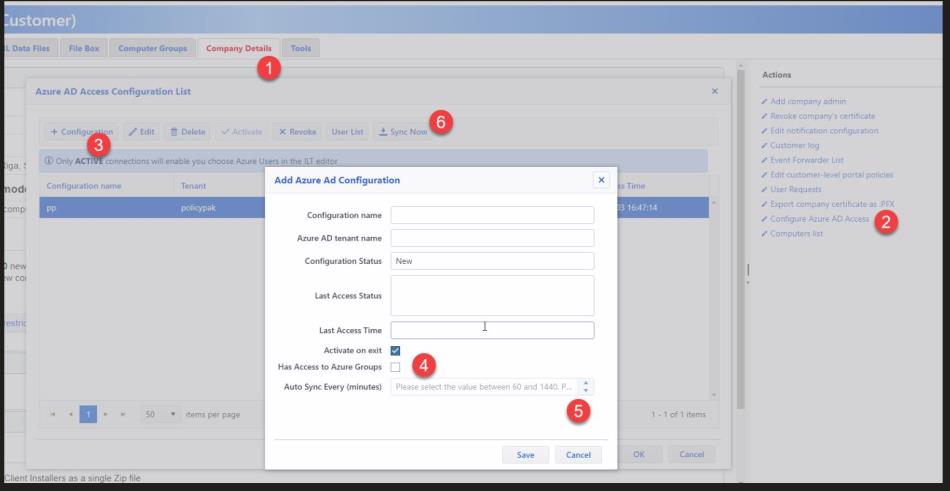

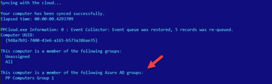

Another option is the ability to mate your Endpoint Policy Manager Cloud instance with your Azure Instance and use Azure Groups as well. You can establish a connection between Endpoint Policy Manager Cloud and Azure using these steps:
Then Azure groups will appear at the same level as Company Groups and you can link XML to those Azure groups.

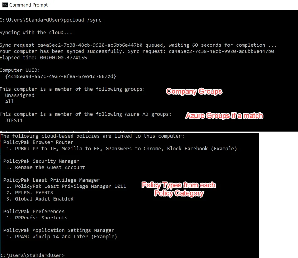

Provided the Endpoint Policy Manager Cloud Client is on the machine (one of the next steps), the
computer will pick up the policies in either the Computer Group or Azure Group. (PPCLOUD /sync
will show these details.)

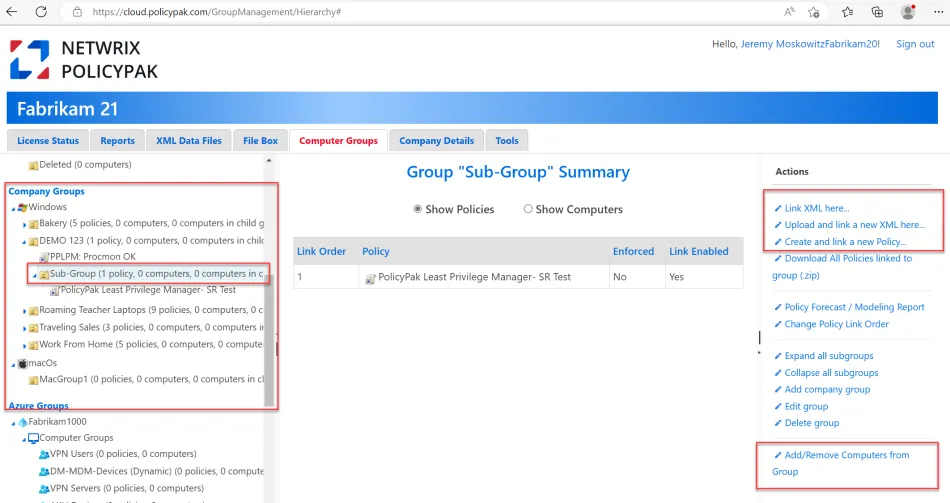

Linking Endpoint Policy Manager Cloud XML to Endpoint Policy Manager Cloud Company Groups or Azure Groups
Because your XML policies are now uploaded to Endpoint Policy Manager Cloud, you are ready to link them over to the Company Group or Azure Group of your choice. Remember that Endpoint Policy Manager Cloud acts nearly the same as on-prem GPO with the following attributes:
- Groups are like OUs, though a computer may be in two Endpoint Policy Manager Cloud Groups (where in on-prem AD it may only be in one.)
- Block Inheritance is available
- Enforced is available
- Precedence is available

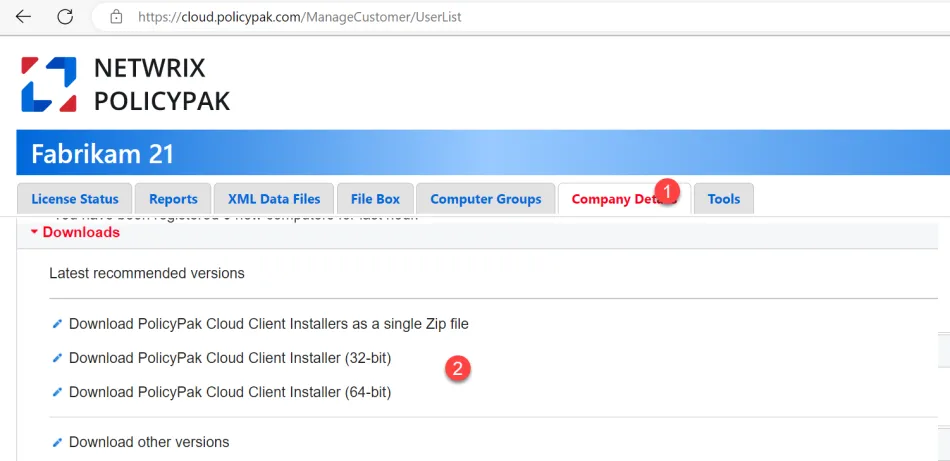

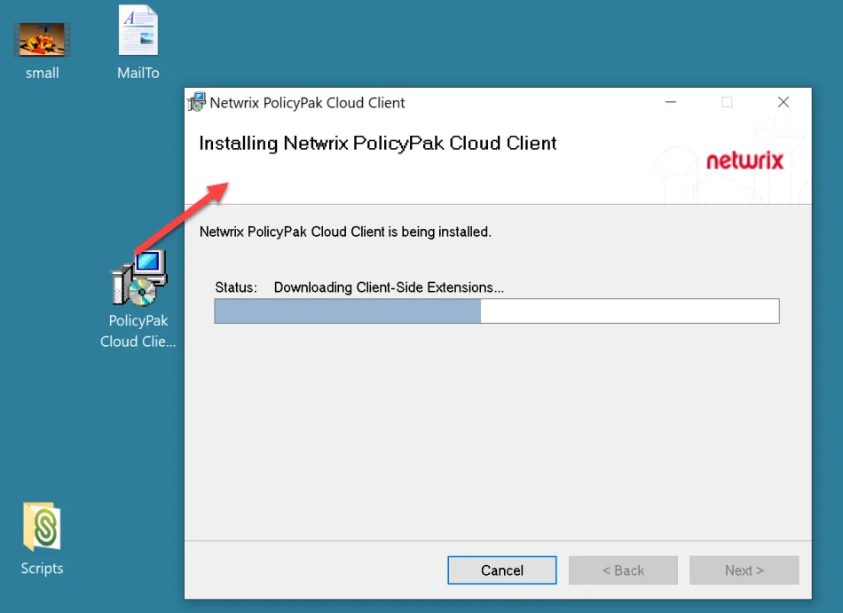

Deploying the Endpoint Policy Manager Cloud Client and/or CSE to endpoints
Now you’re ready to deliver the Endpoint Policy Manager Cloud client to your machines, which will join the machines to Endpoint Policy Manager Cloud.
NOTE: If the machines already have the Endpoint Policy Manager CSE installed, there is no need to uninstall the Endpoint Policy Manager CSE. It is permitted to pre-install the CSE on the machine before the Endpoint Policy Manager Cloud client and could actually save you a lot of time during Endpoint Policy Manager Cloud client rollout.
There are a myriad of ways to install the Endpoint Policy Manager Cloud client, since it is just an MSI. When the Cloud Client is installed it will automatically install the Endpoint Policy Manager CSE if it is not present on the machine like what’s seen here.

On the client
Method one is akin to GP update and you simply run PPCLOUD /sync
(performs a SYNC then displays)
or Endpoint Policy Manager Cloud /status (no sync, just displays), and you can see any specific
machines' current state and policies.
See the Manually Syncing with PolicyPak Cloud topic for additional information.[](https://helpcenter.netwrix.com/en-US/bundle/Endpoint Policy Manager_AppendixE/page/Manually_Syncing_with_Endpoint Policy Manager_Cloud.html)

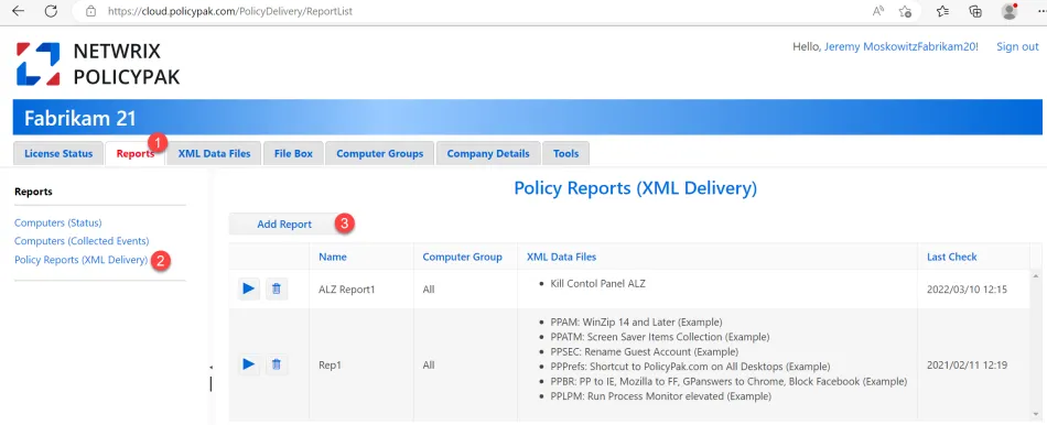

Additionally, you may mass report upon machines using the Endpoint Policy Manager Cloud reporting mechanism.
See the Endpoint Policy Manager Cloud Reporting Demo topic for additional information.
Either method will inform you if the settings you lifted and shifted to Endpoint Policy Manager Cloud are now on the endpoint.

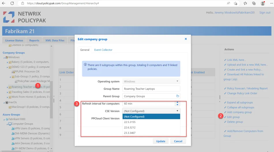

Keeping Endpoint Policy Manager Cloud Client and Endpoint Policy Manager CSE up to date
Finally, it is important to keep the Endpoint Policy Manager Cloud Client and the Endpoint Policy Manager CSE up to date. Endpoint Policy Manager Company Groups control the versions of the Endpoint Policy Manager Cloud Client and Endpoint Policy Manager CSE.
You should always do small scale testing of upgrades of the Endpoint Policy Manager CSE and Endpoint Policy Manager Cloud Client version to ensure safety before you roll it out to everyone via the All group.
See the Using Rings to Test and Update the Endpoint Policy Manager Client-Side Extension and/or Cloud Client (And How to Stay Supported) topic for additional information on the Microsoft Ring methodology, which aligns to Endpoint Policy Manager best practices.
See the Endpoint Policy Manager Cloud Groups CSE and Cloud Client Small-Scale Testing and Updates topic for additional information on how to perform small scale testing before large scale upgrades.
