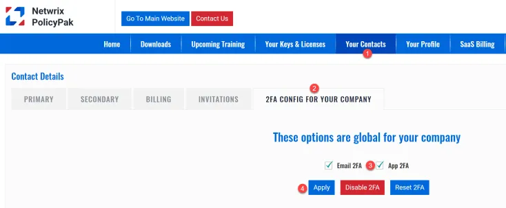

Step 3 – Navigate to Your Contacts > 2FA Config For Your Company tabLocate the 2FA Config tab under Your Contacts, then click App 2FA and click Apply.
Step 4 – You are prompted for another code to authorize App 2FA enablement.
Step 5 – Enter the code and click Commit Changes to complete the process.
Step 6 – A message appears in the lower right and App 2FA will be checked, indicating it is now enabled for all users.

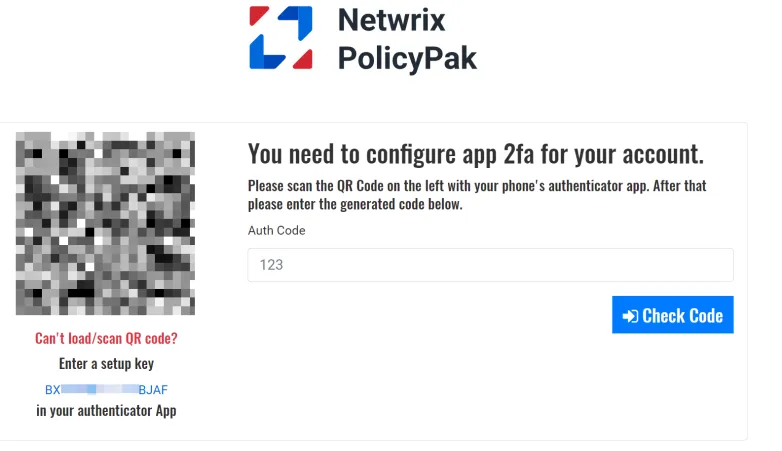

Step 7 – Once App 2FA is enabled, users who log in get the screen shown earlier, where they can choose which method they want to authenticate with:  Email or app.  If they choose app and have not yet setup their authenticator app, they will be prompted to do so.  Scan the code with the app and supply the code shown in the app.  If for any reason the QR code is not displayed properly, most apps allow the use of the alternate code that you will see displayed.
461_5_image-20220908160453-12_782x451
Step 8 – After supplying the code from the app they'll be returned to the logon screen where they will see an acknowledgment if the Authenticator app setup was successful.

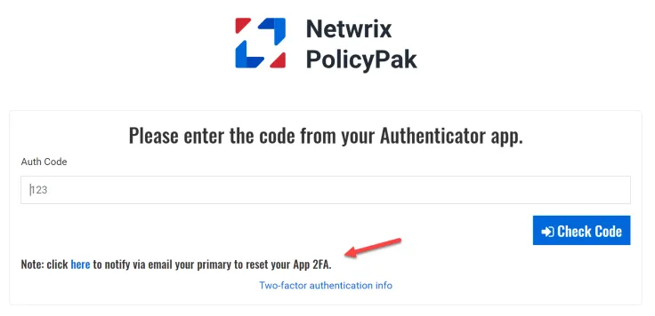

Step 9 – When they log in and choose the authentication app method, they will be prompted to enter the code from their authenticator app.
461_7_image-20220908121115-5_763x335

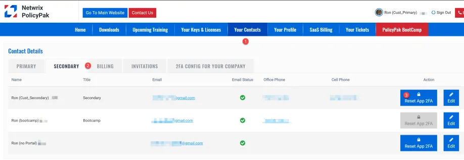

Resetting 2FA for an Individual Secondary
If an individual needs to have their App 2FA reset, they can request that when logging in. Clicking the link send a notification to the Primary on the account.
461_8_image-20220908121906-6_736x356
The Primary can then log in to the Portal and perform the reset as shown below.  Navigate to Contacts, select either Secondary or Billing, locate the individual and click Reset App 2FA.

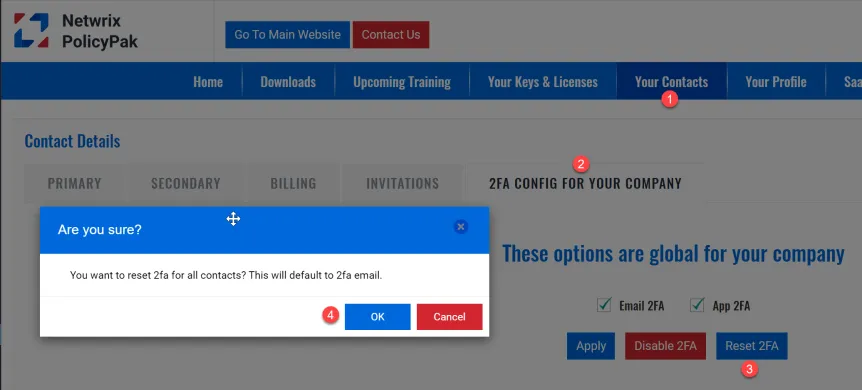

Resetting 2FA GLOBALLY
If you ever need to reset 2FA, you can do this by clicking Reset 2FA.
NOTE: This will reset the 2FA setting for all users. Everyone will need to re-setup their authenticator app.

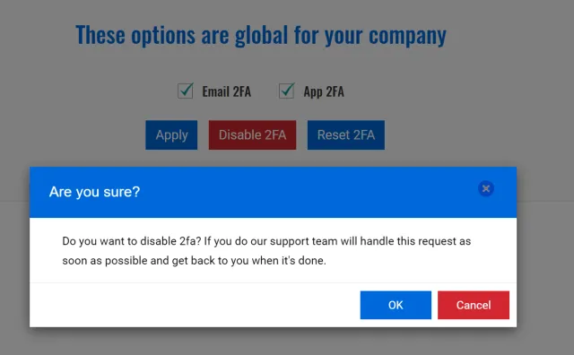

Disable 2FA
Though we strongly advise against it, you can disable 2FA completely on your account.  Do this by clicking Disable 2FA and confirming your request.  The request will be submitted on your behalf and handled by the support team.  You will hear from them when the request is completed.
461_11_image-20220908134421-9_640x396
You will get a confirmation email anytime 2FA is disabled for your account.  Please note that this is for the entire account so 2FA will be disabled for ALL users/contacts as indicated below.
