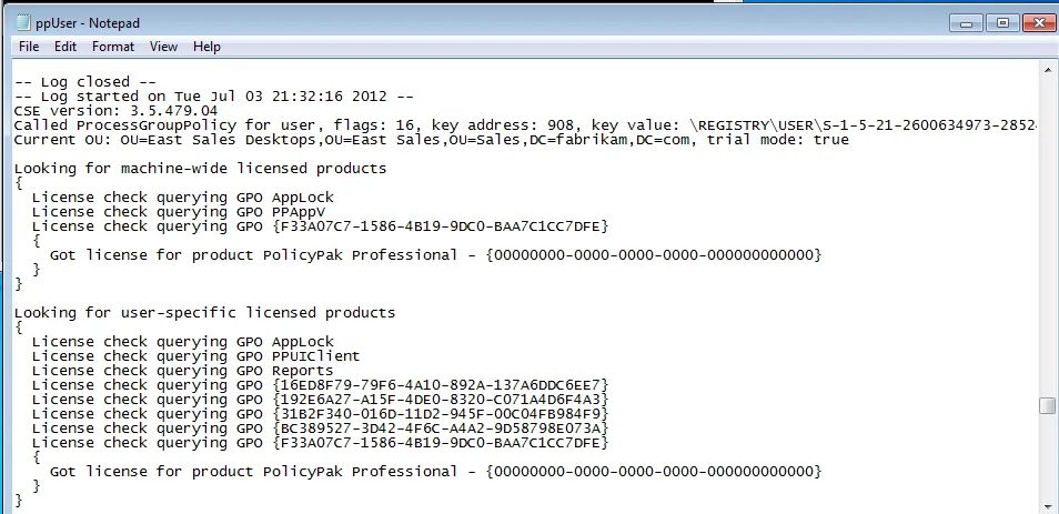

You can see an example of the contents of the logs in Figure 101.
Figure 101. An example of the logs.
