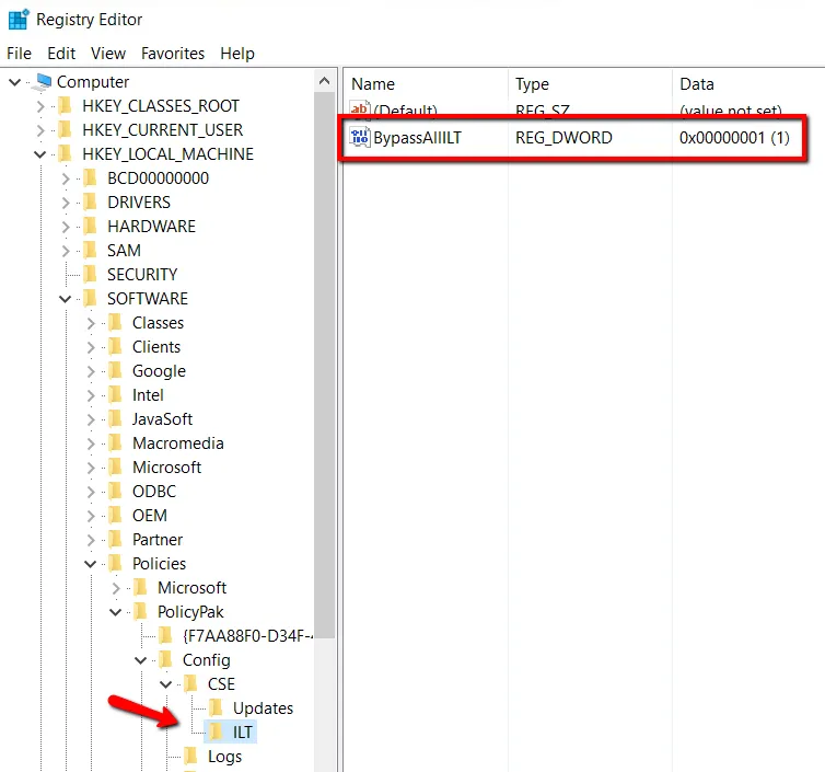

An example of using one of these entries—the BypassAllILT entry, which would turn off all ILT
processing—can be seen in Figure 102. Note that the ILT key will not exist by default and must be
created before the value is set within it.
Figure 102. An example of a BypassAllILT entry.
