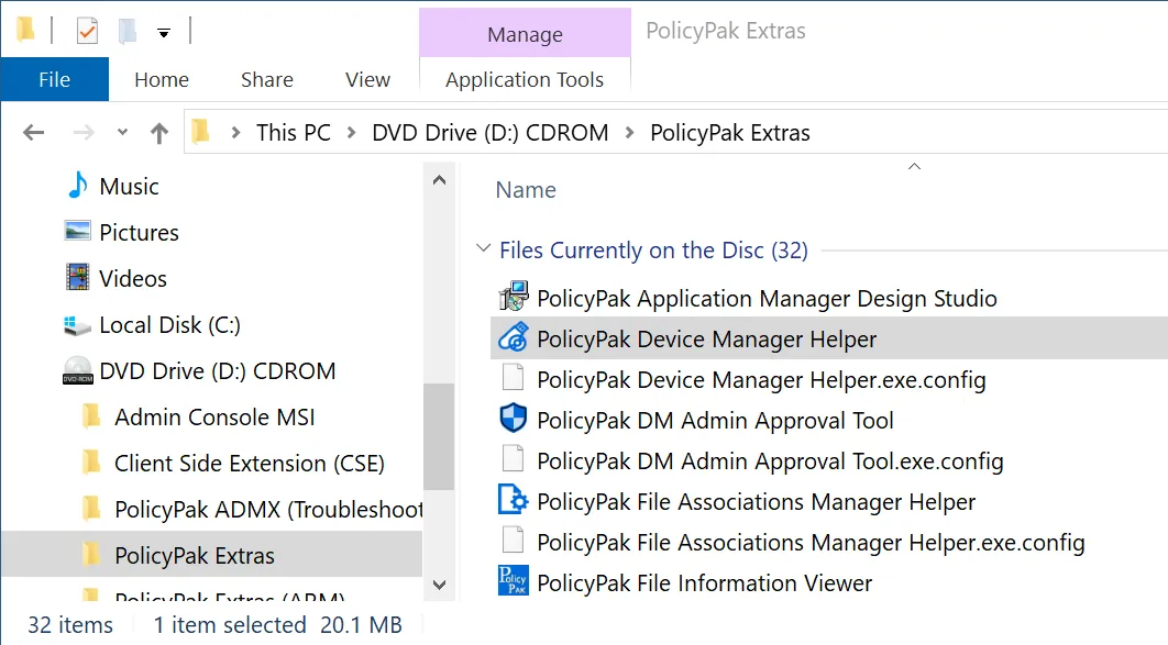

The Endpoint Policy Manager Device Manager Help Tool can be found in the download in the Endpoint Policy Manager Extras folder.

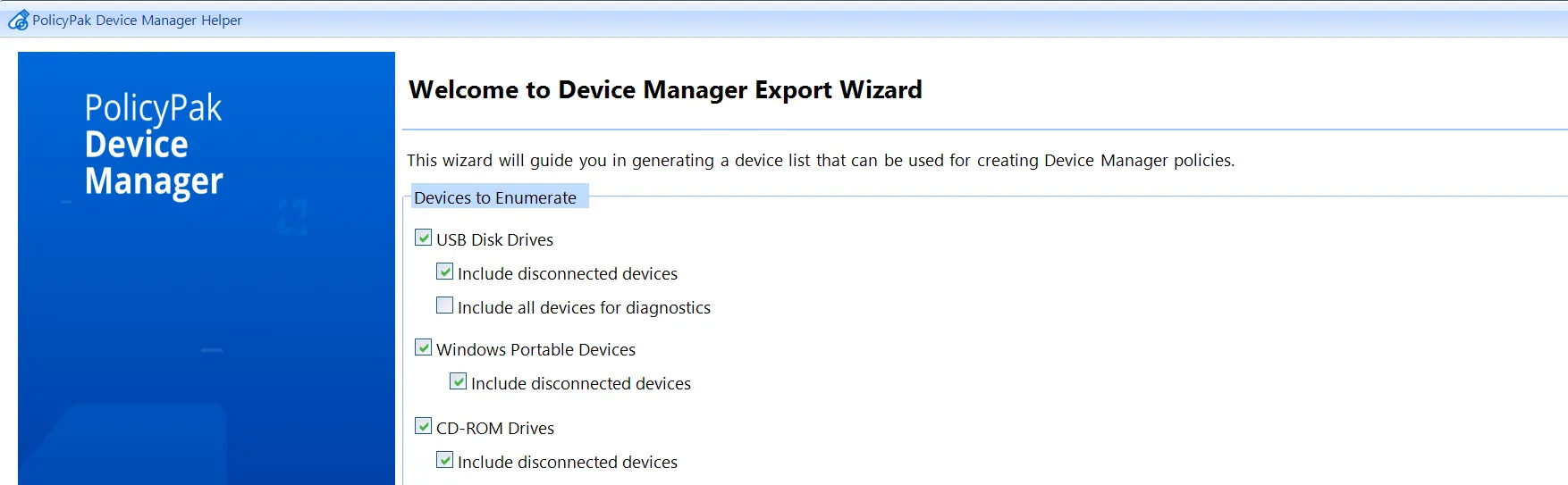

Step 1 – Open the Endpoint Policy Manager Device Manager Helper.
The Device Manager Export Wizard displays details for each selection: Disk Drives, Portable Devices, and/or CD-ROMs. Only pages for detected devices are shown.
The Device Manager Helper tool enables you to quickly gather Instance Paths for connected and non-connected devices.

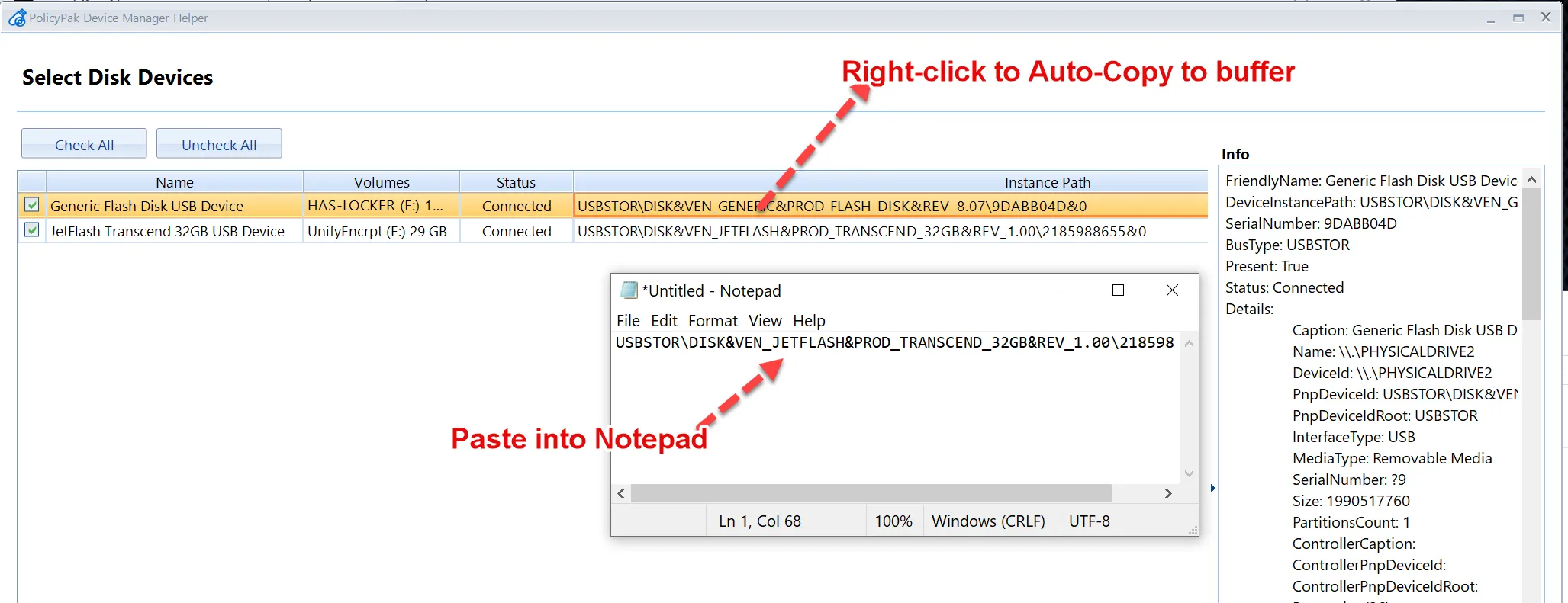

Step 2 – On the Select Disk Devices window, right-click to automatically copy the detail to the buffer for later pasting.

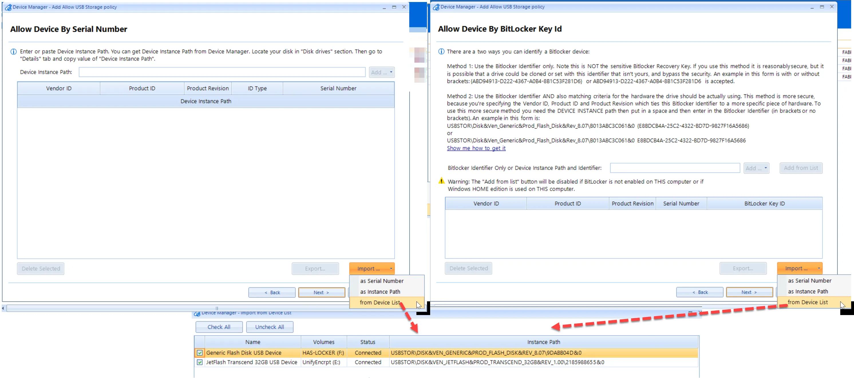

You can also save the list of all devices at the end of the Wizard using the Save application list to this XML option.
Then, you may use this list using the previously described wizard pages such as Allow Device by Serial Number and Allow Device by BitLocker Key, as shown in the example screen below.
