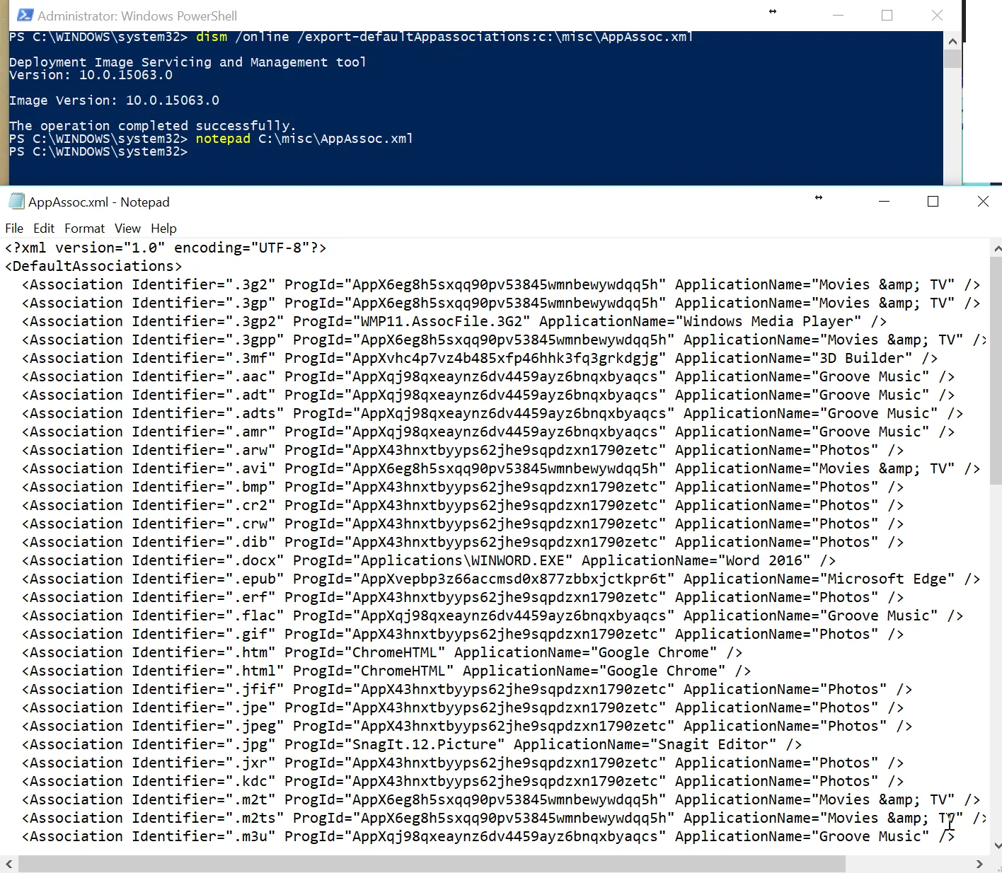

Step 3 – Use the built-in command DISM and export the associations to an XML file. The command would be something like:
Dism /Online /Export-DefaultAppAssociations:<XML path>\AppAssoc.xml
Step 4 – Use Group Policy to ensure that specific computers use this XML file.
The exported file from this process might look something like this:

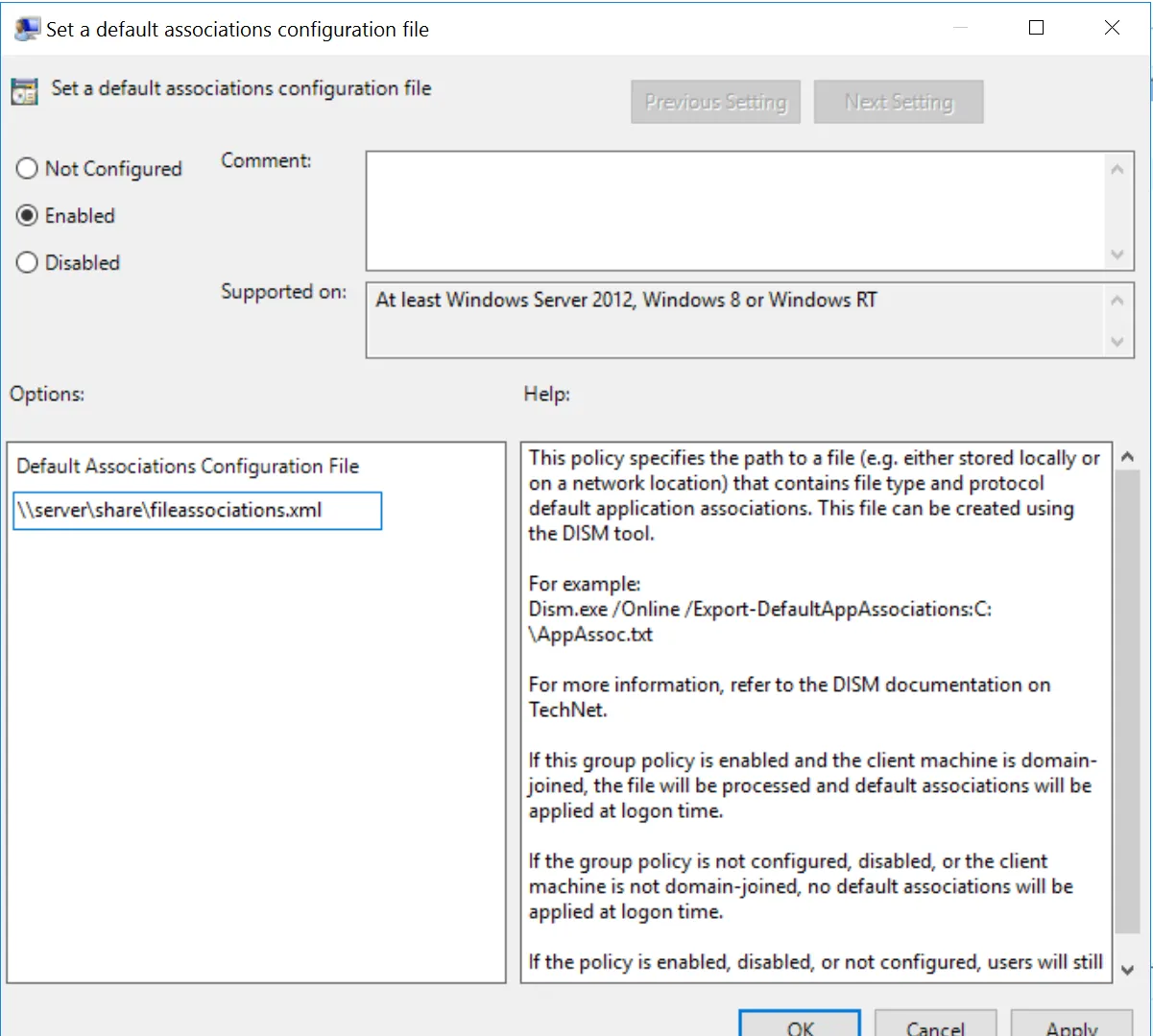

Step 5 – Next, you would use the Group Policy setting called Set a default associations configuration file.
about_policypak_file_associations_3
