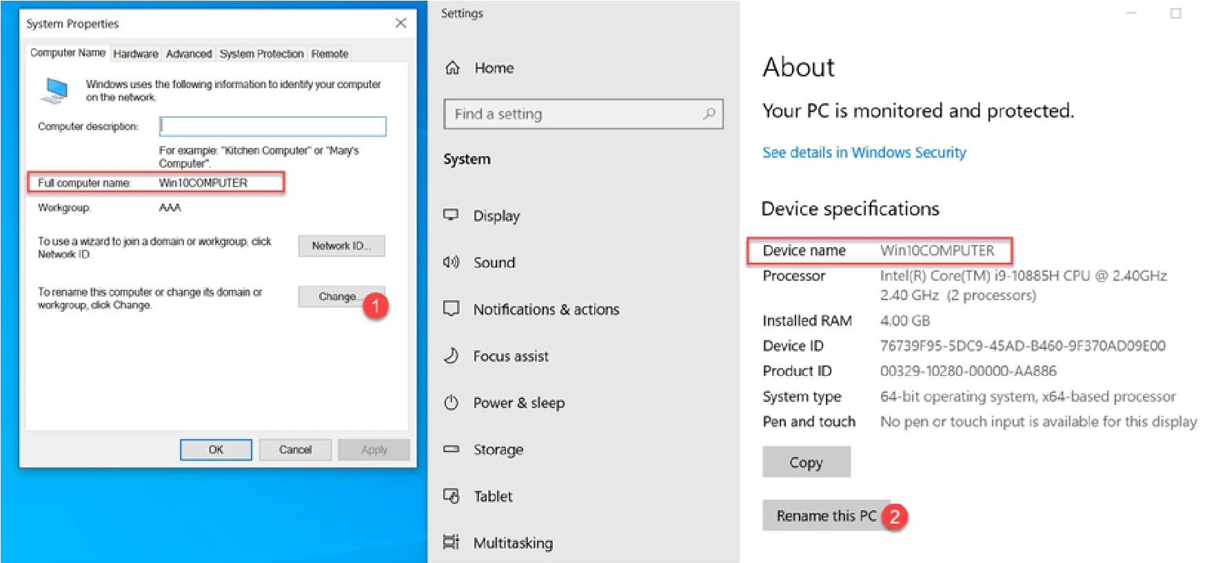

To get an endpoint computer to act licensed, simply rename a computer to have COMPUTER in the name. When the computer has the word COMPUTER in the name, Endpoint Policy Manager will act fully licensed on this computer.
Here are the two methods of how to rename a computer in Windows to have Computer in the name.
prepareendpoint1
After the example computer is renamed and rebooted, you are ready to install the Endpoint Policy Manager CSE (Client Side Extension.)

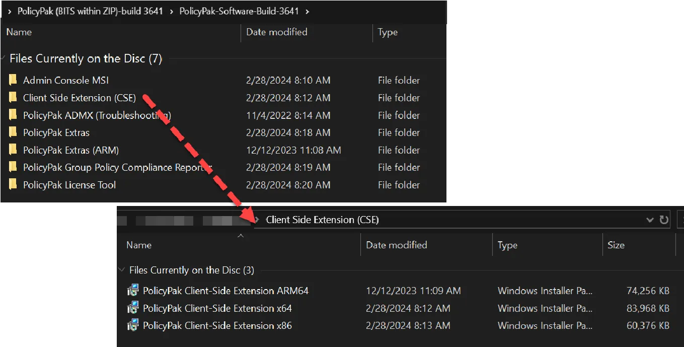

Locate the Endpoint Policy Manager Build folder and the Client Side Extension (CSE) folder.
prepareendpoint2
Next, install the Endpoint Policy Manager CSE on the endpoint. Use x64 for 64 bit and x86 for 32 bit machines.

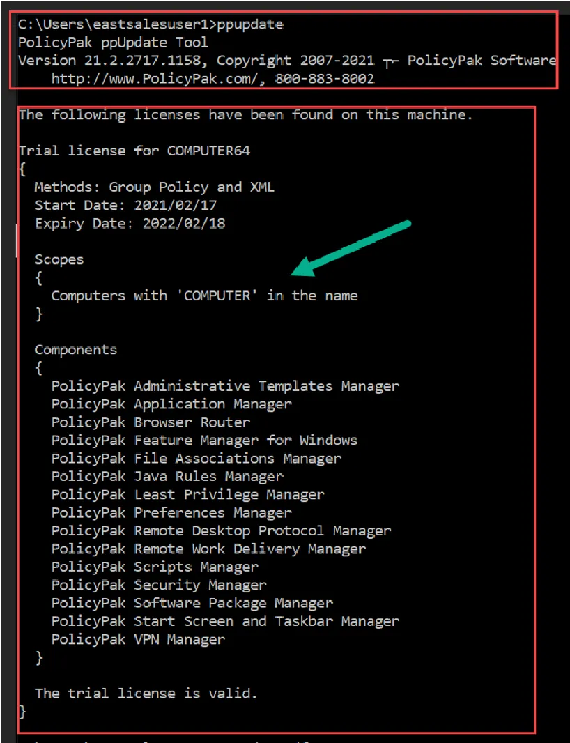

After the Endpoint Policy Manager CSE is installed, you can test verify that the license is valid because you renamed the computer to have COMPUTER in the name. Open a new command prompt and type the command ppupdate. You should see something similar to the output shown here.
prepareendpoint3
The important points to look for are:
  • Verify you see the words “The trial license is valid.”
  • Verify you see the Expiry date is in the future.
  • Verify you see all the Components of Endpoint Policy Manager listed.
NOTE: The trial expires 90 days after the build of Endpoint Policy Manager was created - NOT 90 days after you perform the installation. Therefore, be aware of your Expiration date since it could be sooner than expected.
