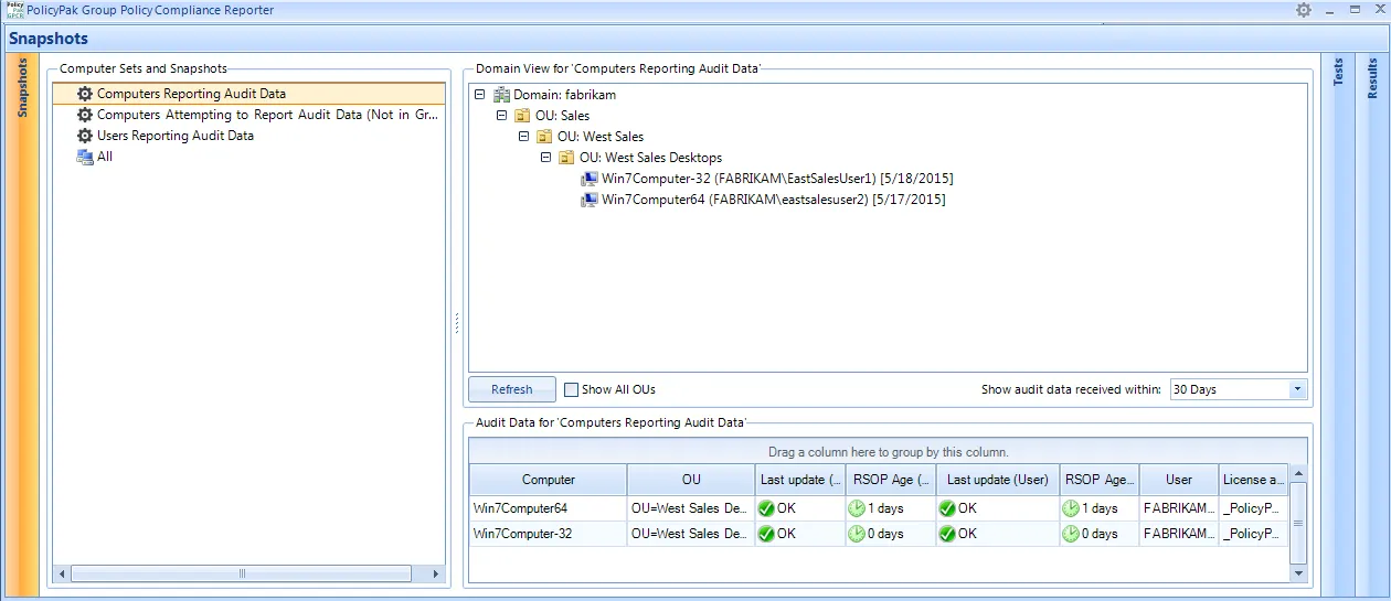

There are some built-in reports to help determine which computers (and their users) are delivering auditing data. In Figure 54, the report entitled "Computers Reporting Auditing Data" will show computers that are in the security group and have successfully delivered auditing data to the server.
gpcr_server_with_push_mode_18
Figure 54. Computers reporting auditing data.

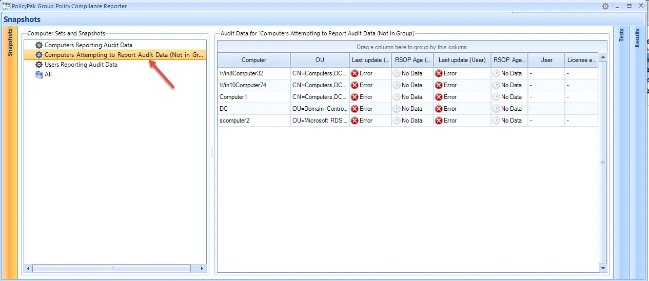

The report entitled "Computers Attempting to Report Audit Data (Not in Group)" will show computers that ran PPGPCR.Auditor.exe and had their data received by the server but dumped because they were not in the security group, as shown in Figure 55.
gpcr_server_with_push_mode_19
Figure 55. Data is dumped for computers not in the security group.
NOTE: If you add a computer to your own Active Directory security group you will need to reboot it for the computer to know it has changed group membership.

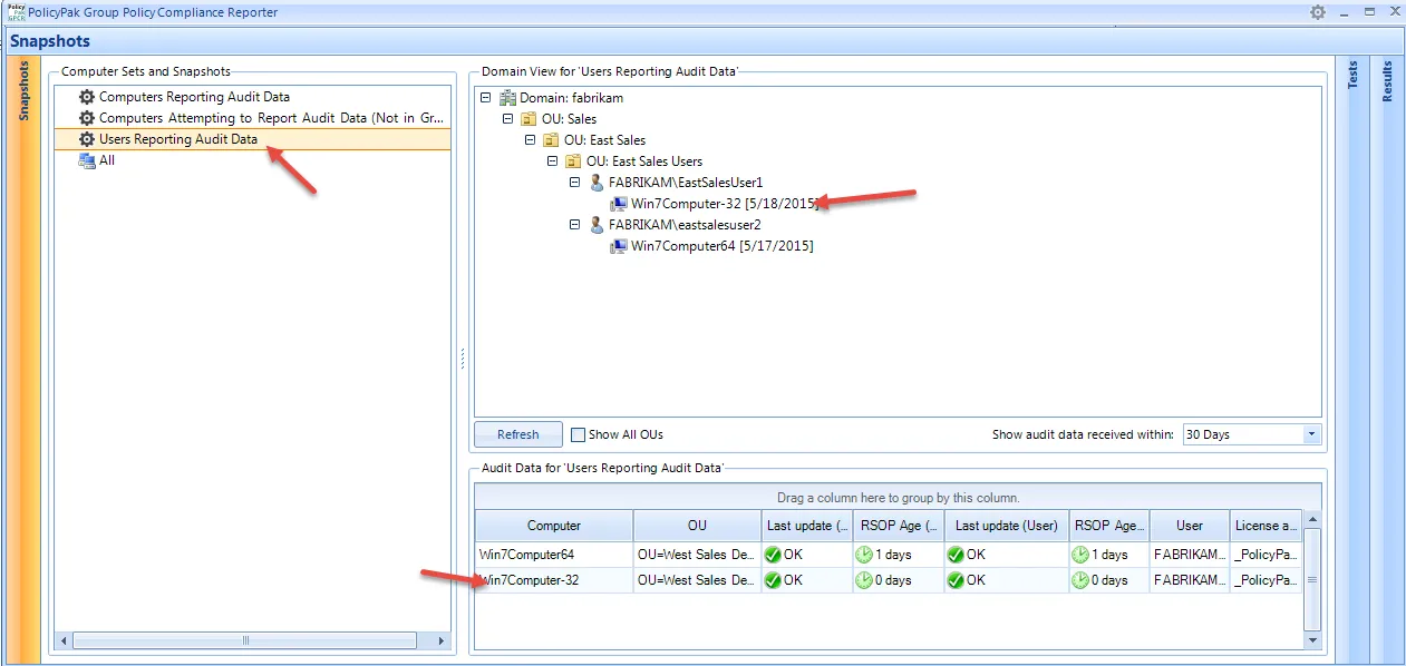

There is a final report entitled "Users Reporting Audit Data," as shown in Figure 56. This enables you to quickly view which users' data you have on file and which computer they last used to log in with.
gpcr_server_with_push_mode_20
Figure 56. Users reporting audit data.
