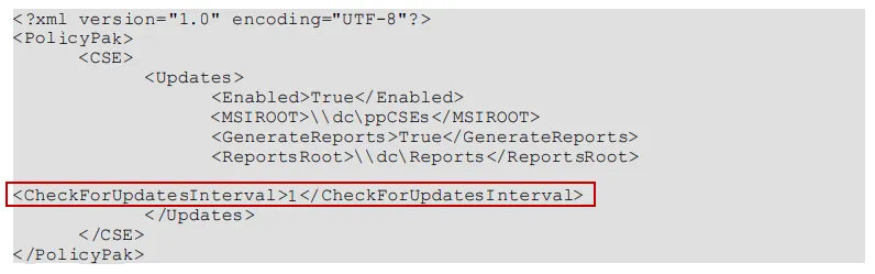

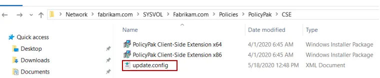

If you wish to configure or fine-tune the CSE auto-download process, you may create a file called
update.config
, which must be placed within the Netwrix Endpoint Policy Manager (formerly
PolicyPak) Central Storage CSE folder, as seen below.
This file can be manually created in order to configure or fine-tune the CSE auto-download process.
This file should be created in the Endpoint Policy Manager Central Storage CSE folder, and the file
name update.config
must match exactly, otherwise, the file is ignored. The CSE attempts to read
this file once every 90 minutes, but that is configurable in the update.config
file itself.
NOTE: The interval in our example below is set to 1 minute.
Breakdown of the parameters for the update.config
file and how to use them:
Parameter | Function | Values | Default if Not Present |
Enabled | Enables/disables auto-update | True or False | Enabled (True) by default |
CheckForUpdatesInterval | Sets a schedule for when the CSE will perform an auto check for a new version | Interval (in minutes) when checking for an update | The default value is 360 (6 hours). In the sample above, the value is set to 1 minute for testing purposes. |
MSIROOT | Enables you to point to any share of your choice to house the CSE update (instead of using the Endpoint Policy Manager Central Storage and CSE directory) | Any share name, such as \\server123\PPCSES | Defaults to \\sysvol\sysvol\ <domain name>\policies\ PolicyPak\CSE directory |
GenerateReports | Facilitates reports to show success or failure of machines' updates | True or False | Disabled (False) by default |
ReportsRoot | Sets a share up to receive CSE update reports | Any share name, such as \\server123\Reports | This is not defined and will not generate reports if GenerateReports is not set. |
CheckForConfigInterval | Tells the CSE how often to check for updates within this configuration file | Any interval (in minutes) | Defaults to 90 minutes |
CSE32FILEname | Optional value if you wish to expressly change the name of the 32-bit Endpoint Policy Manager Client-Side Extension MSI | Any file name ending in MSI | By default, the auto-update mechanism is looking for Endpoint Policy Manager Client-Side Extension x86.MSI |
CSE64FILEname | Optional value if you wish to expressly change the name of the 64-bit Endpoint Policy Manager Client-Side Extension MSI | Any file name ending in MSI | By default, the auto-update mechanism is looking for Endpoint Policy Manager Client-Side Extension x64.MSI |

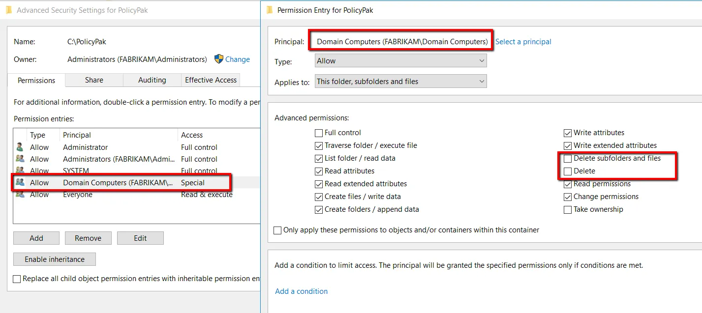

Setting up the Reports Share and verifying reports are working:
The share for reports should have the following permissions:
- Administrator should be set to Read/Write (owner)
- Domain Computers should be set to Read, Write, Create (but not Delete)
- NTFS permissions should allow for All.
NTFS permissions should be set up as shown below, where Domain Computers has all rights, except Full Control.
This way, domain computers (that is, endpoints) will be able to write reports but not delete reports that they create. When enabled and configured, inside the share, you'll see log files named in the following way:

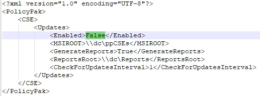

file and would like the client to know about those changes. Note that this command will not perform the actual update of the CSE, instead it will simply read the file and honor the new schedule and any changes.ppupdate /cseupdatenow
. When run from a target computer, this command will instruct the CSE to reread theupdate.config
file and perform any needed updates immediately.ppupdate /cseupdatenow /force
NOTE: This is necessary only when the update.config
file's enabled variable is set to False
and, thus, not performing any updates normally.
