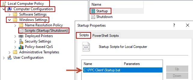

Step 7 – Run GPEDIT.MSC  and add an entry under Computer Configuration > Windows Settings > Scripts (Startup/Shutdown). Select the startup.bat file for Startup script and select the shutdown.bat for the Shutdown script, then click OK to save the settings.
332_8_image-20210529214259-8
332_9_image-20210529214259-9

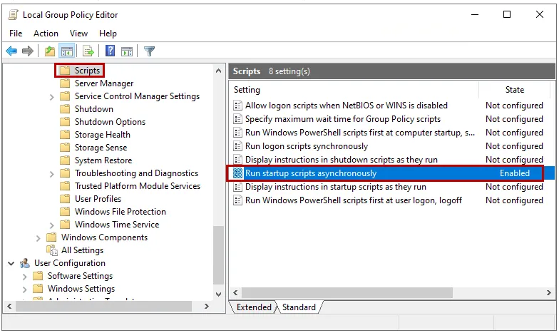

If you receive a blank screen at login on the Master image machine or VDI, you can try logging out and back in, or you can try the following to see if it resolves the issue.
Using GPEDIT.MSC, verify that the following setting Run startup scripts asynchronously is enabled under Local Computer Policy > Administrative Templates > System.
332_11_image-20210529214259-10
