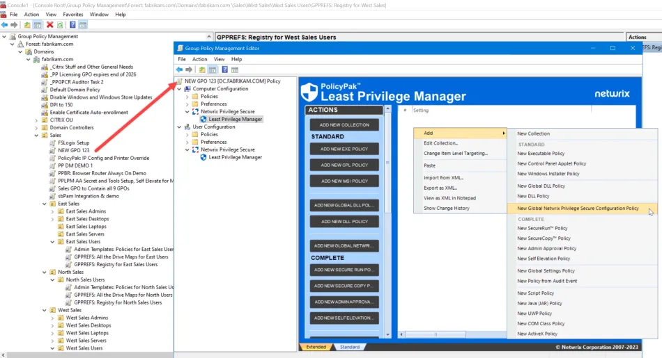

First, you need to configure the Endpoint Policy Manager CSE using Global Netwrix Privilege Secure Configuration Policy and have it affect endpoints. This is the switch which turns on Privilege Secure on the Endpoints when the Endpoint Policy Manager CSE is installed.

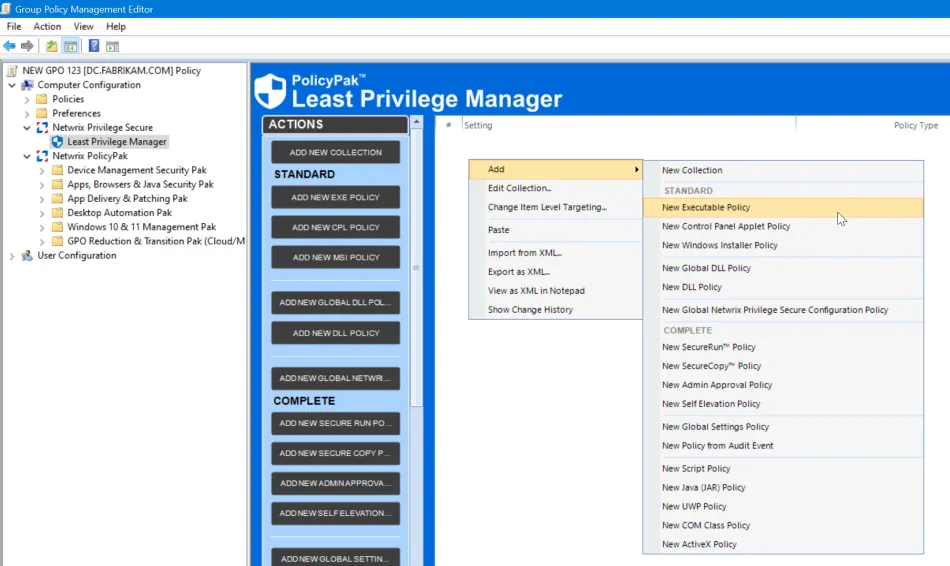

When that is done you can create policies which affect endpoints such as Executable, Windows Installer, etc. and have them work unlicensed. Rememberthat this only works when used in conjunction with Netwrix Privilege Secure. For example, an Executable policy may be started like this:

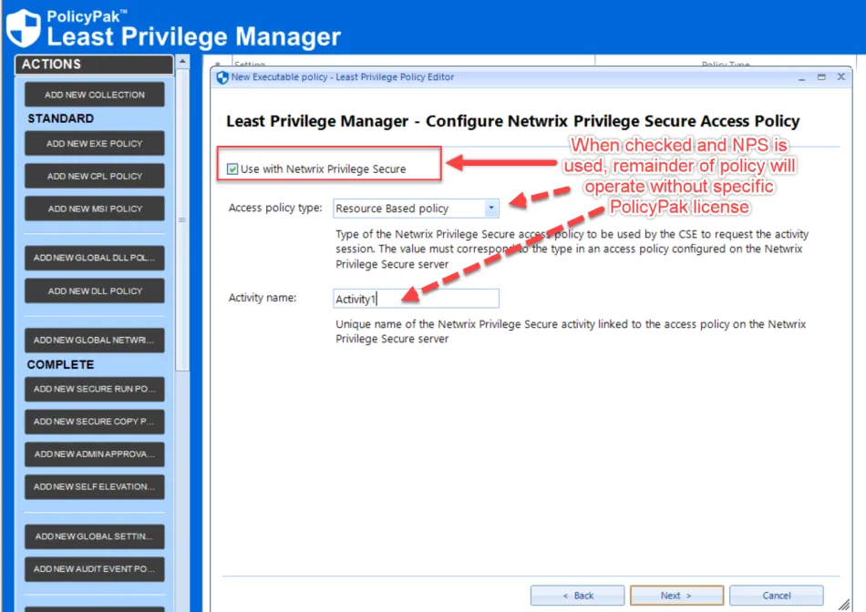

But one of the first screens you will encounter is this. Here you must select Use with Netwrix Privilege Secureas shown below.

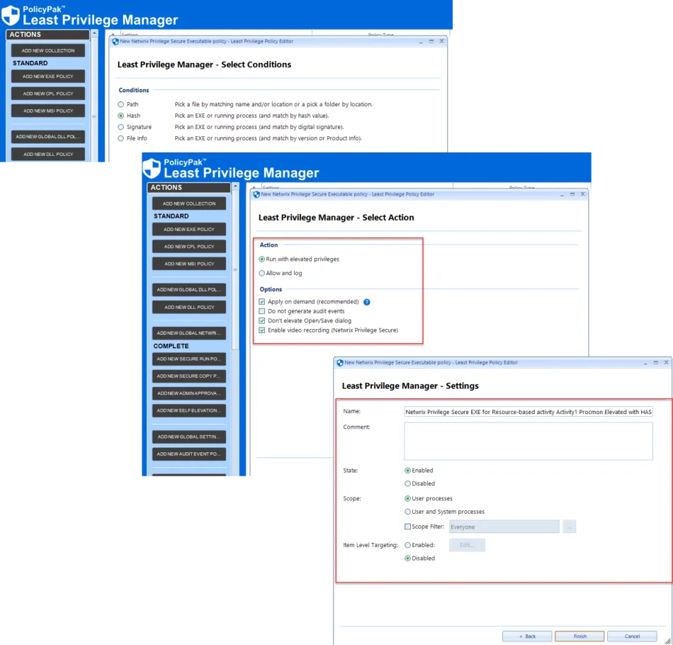

The remaining screens will work unlicensed, because the policy is conjoined with Netwrix Privilege Secure.

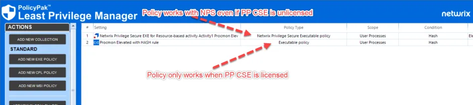

Another way to know what policies will work unlicensed vs. licensed is to simply look at the view of all the policies. Those which state Netwrix Privilege Secure will run fine when the Endpoint Policy Manager CSE is unlicensed. Those which do not have this listed means that the policy will be honored when the Endpoint Policy Manager CSE is licensed for Endpoint Policy Manager Least Privilege Manager.
