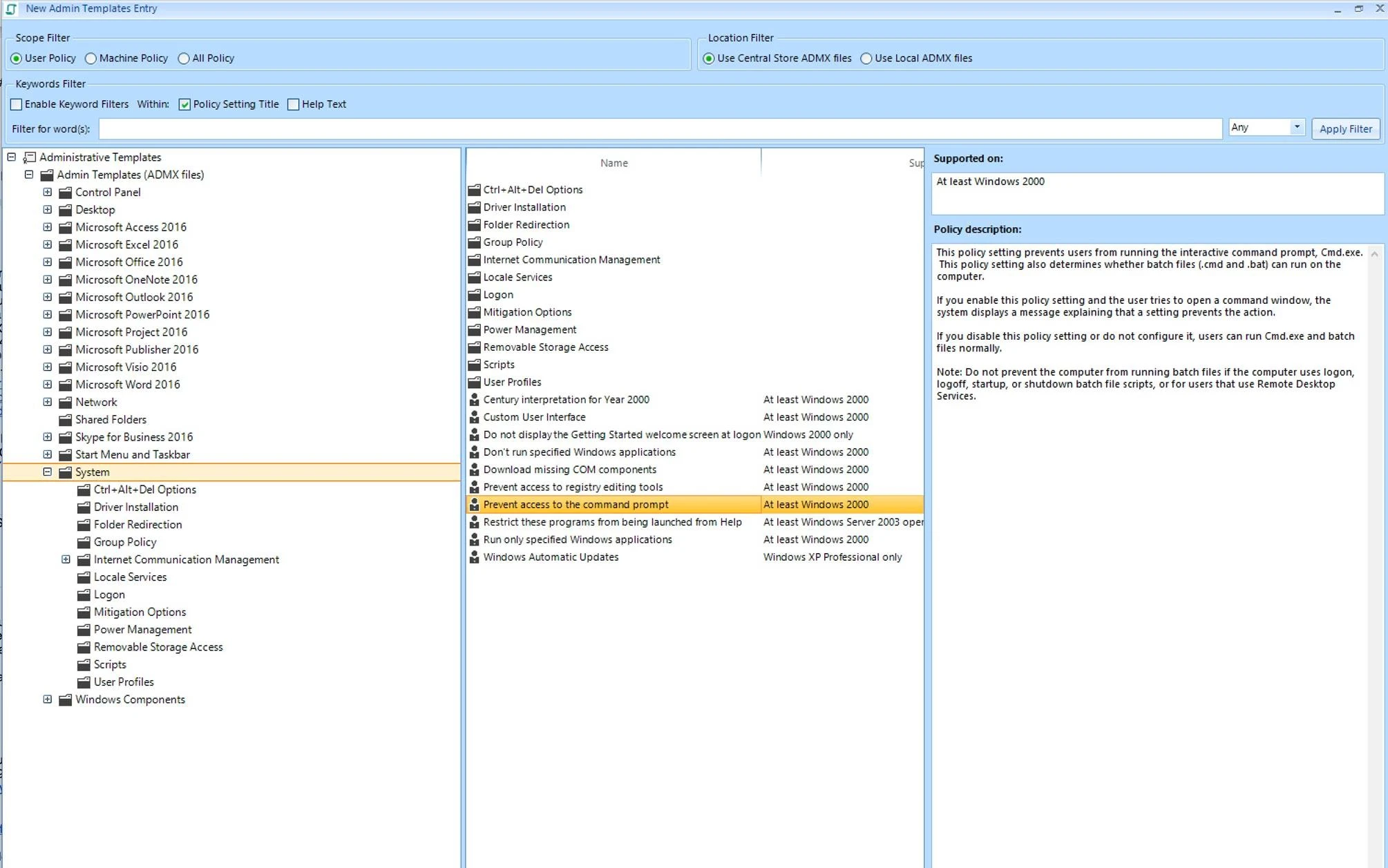

For example, you may wish to Prevent access to the command prompt for all standard users, as in the example below, and you want to use Item Level Targeting (ITM) to do it.
139_1_overall-faq-01-img-01

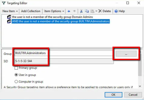

This is the combination that appears to work:
139_2_overall-faq-01-img-03
139_3_overall-faq-01-img-03
There are three important things to note from the examples above.
  • We are using an AND instead of OR
  • The Domain Admins group has been manually entered
  • The Administrators local group, on the other hand, was obtained by clicking the 3 dots to select it and get its SID

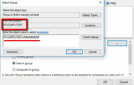

The catch with the last item is that since there is no local Administrators group on a DC, a DC cannot see that group to add it. Instead, you must install the GPMC and the PP Admin Console on a regular machine (that is a member of the domain, like a test W10 VM for example), edit the GPO, click the 3 dots, and then select the Computer name as the source, to capture the Administrators group that way.You only have to do this once to get the group and its SID, but it can't be done on a DC.
This is the sequence after clicking the three dots:
139_4_overall-faq-01-img-04
