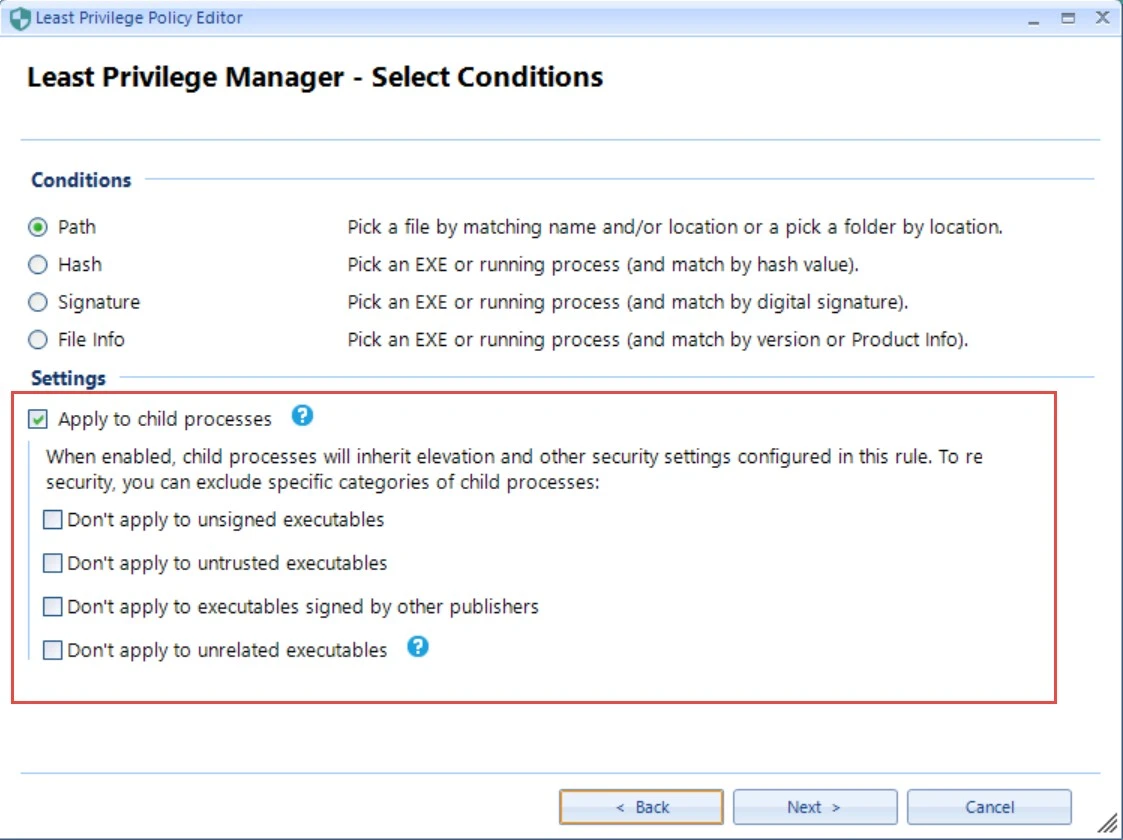

We suggest leaving the checkbox on for Apply to Child Processes when installing software. This
will enable a Setup.exe
to elevate anything it unpacks and needs to continue to install. However,
using Apply to Child Processes is not recommended when elevating specific applications where
users could open their own dialog boxes. Some examples of this would be REGEDIT
or Acrobat Reader.
In those cases, users could spawn a new process, which would also be elevated and perform functions
that work around your security.
If, however, you need to keep Apply to Child Processes on, you have some additional security mechanisms to prevent application to child processes in all circumstances.
- Don't apply to unsigned executables. If the application has no digital signature and is unsigned, do not apply the elevation level to child processes.
- Don't apply to untrusted executables. Don't pass the elevation status if the file's owner isn't on the SecureRun™ list (when SecureRun™ is being used). If SecureRun™ is not used, do not elevate to the child processes unless the file owner is TrustedInstaller, Built-in\Administrators, SYSTEM or %COMPUTERNAME%\Administrator.
- Don't apply to executables signed by other publishers. Don't pass the elevation status if the application is not signed by the same signed vendor who originated the process.
- Don't apply to unrelated executables. Don't pass the elevation status if the application is not in the same directory structure (including recursively).
