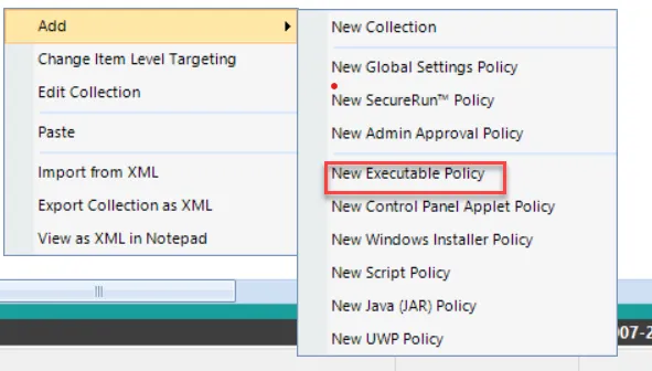

Step 3 – Create a new New Executable Policy.
203_1_image-20200229095829-1

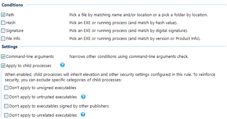

Step 5 – Select Apply command-line arguments, leaving everything else as-is and click NEXT.
203_5_image-20200229095829-3

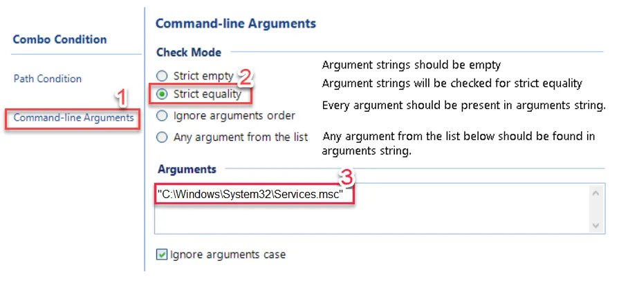

Step 8 – Click on Command-line Arguments, select Strict equality, and under Arguments type in the exact path to services.msc ("C:\Windows\system32\services.msc") and click NEXT.
203_11_image-20210521112229-2

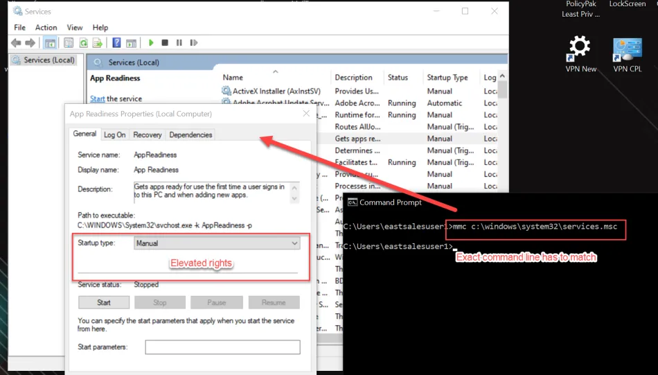

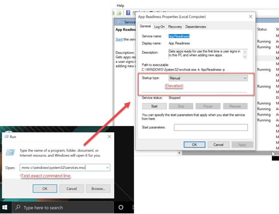

To test this out, you can use the RUN command.Be sure to type in the exact command you've specified in step 8. Only then will elevation occur.
203_14_image001_950x730
Additionally, you can test with a command prompt. Again, the command has to match exactly.

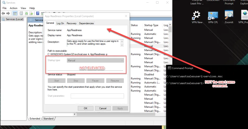

NOTE: If you attempt other avenues, like from the Start menu or alternate command lines, they will not work. In the example below it does not work because it is notthe exact same command line.
203_16_image003_950x496

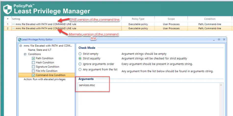

In order to make this work, you need to specify a second policy with alternate approved command lines. For instance, you could do this, which removes the requirement for c:\windows\system32\services.msc
203_17_image004_950x475

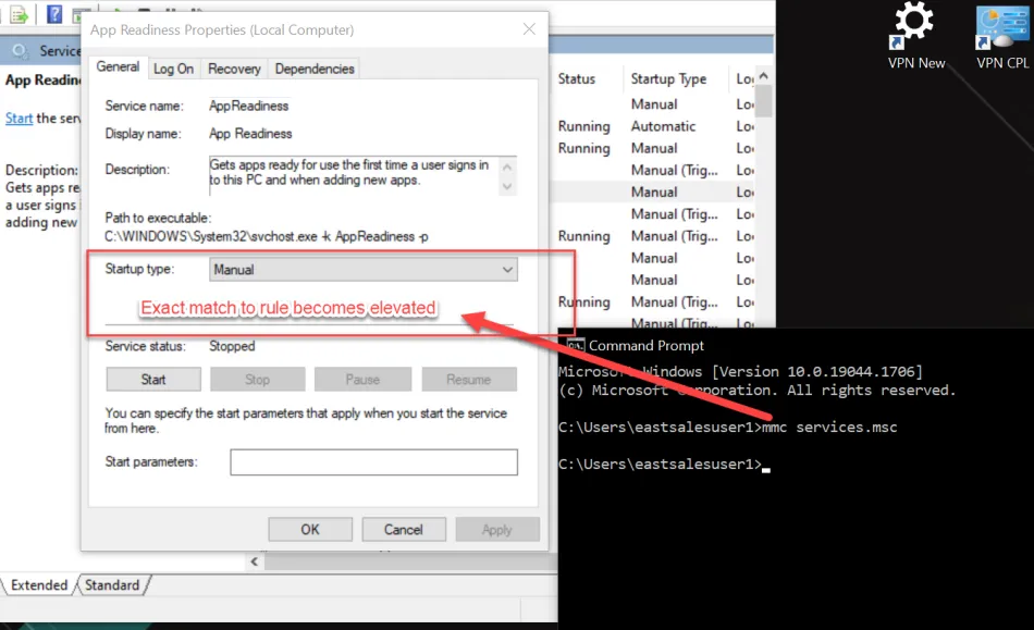

The result would be that the shorter command line: mmc services.msc is accepted and runs elevated.
203_18_image005_950x579

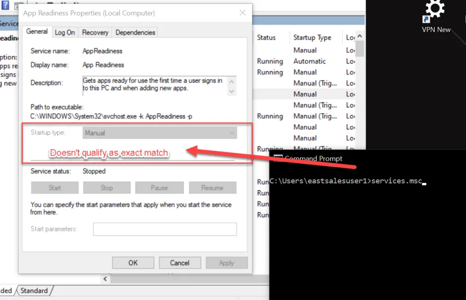

However, at no time would the shortest expression, of only "services.msc" work. The required MMC must appear before the command line.
203_19_image006_950x612
