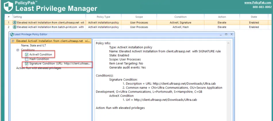

When an ActiveX control is digitally signed, and you use Netwrix Endpoint Policy Manager (formerly PolicyPak) Least Privilege Manager to deliver a rule to enable the ActiveX install, Internet Explorer (or IE mode in Edge) will permit the install. Here's an example of a rule where the item has a rule for the URL and for the Signature.
859_1_image001_950x422
Remember, When your ActiveX items are signed, you should have no problem.

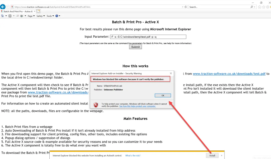

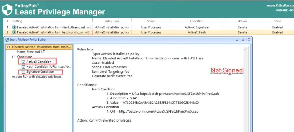

However, if you attempt an ActiveX rule where there the ActiveX item is not signed (see below)…
859_2_image003_950x429
You will get an experience like this…

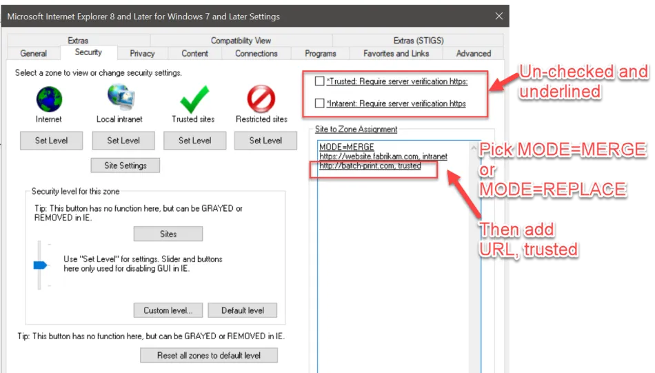

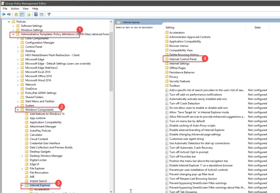

To overcome this, you need to decrease the security for Internet Explorer. You do this with Group Policy or Endpoint Policy Manager Cloud.
Go to User (or Computer) Admin templates > Windows Components > Internet Explorer > Internet Control Panel
859_4_image005_950x656

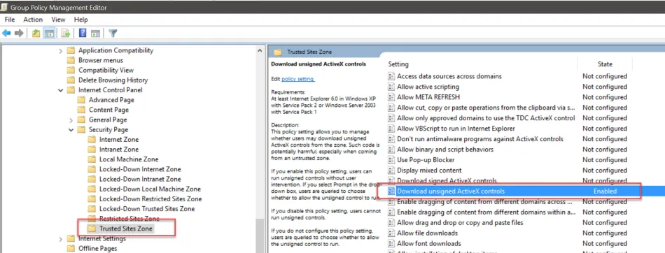

Then locate pick the Trusted Sites Zone.
CAUTION: Note that you are explicitly telling Internet Explorer to reducethe security here in order to enable your unsigned ActiveX control to be installed.
859_5_image007_950x362

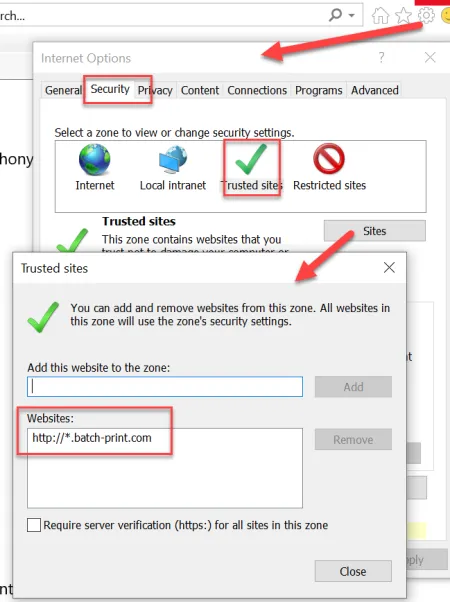

Lastly, you have to add the site to be trusted. You have a few options on how to perform this:
Step 1 – Explain to a user how to do it this one time on their PC.
  • Pro: good for one-off.
  • Con: Hard to explain to a user. Bad for having to do it for lots of users.
Step 2 – Use GPPreferences to add it as a trusted site.
  • Pro: Easy to set up.
  • Con: Wipes out other trusted sites.

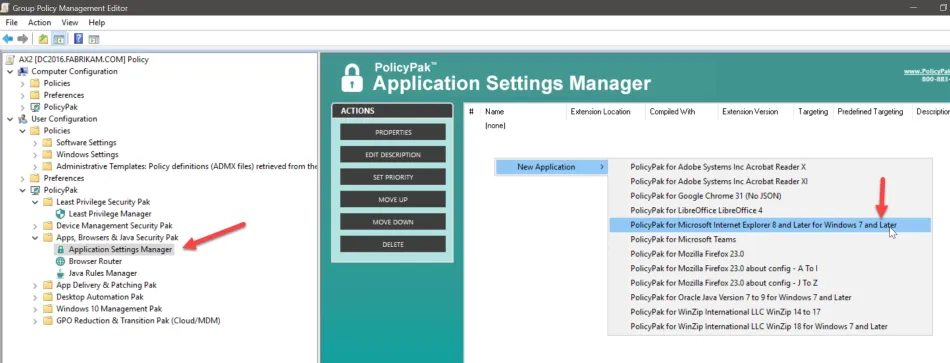

Step 3 – Use Endpoint Policy Manager Application Settings Manager to add it as a trusted site.
  • Pro: Will perform a merge of the existing sites if you want.
  • Con: Need to be licensed for the Apps, Browser and Java Pak along with Endpoint Policy Manager Least Privilege ManagerPak.
The goal is to get IE to recognize the URL to get into the Trusted Zone like this. (This is the RESULT of performing Option 1, Option 2 or Option 3 above.)
