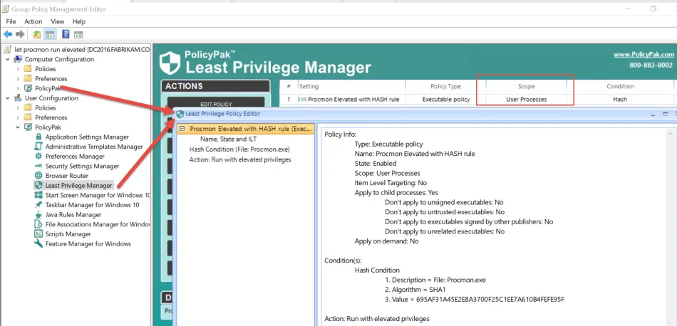

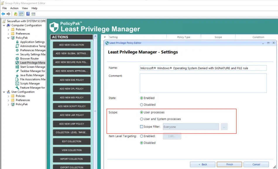

NOTE: The Policy Scope option is only available when used on the Computer side; on the User side it is greyed out because this setting is only meant to express to the COMPUTER (system) how to work with User, and User and System Processes. On the User side, the processes are always in the context of the User.
319_3_faq-img-03_950x571
In this topic, we are going over various use cases when you might use the Policy Scope option (which again, will only be un-gray / valid on the Computer side.)

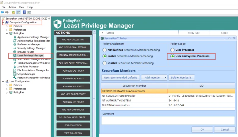

Scenario 1: Enhanced SecureRun / Prevent untrusted executables and scripts from running even by LOCAL SYSTEM.

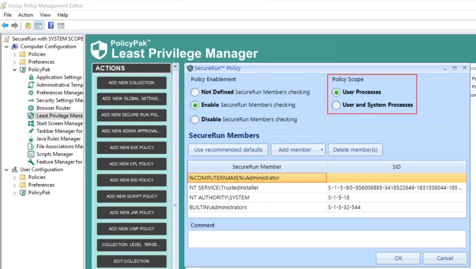

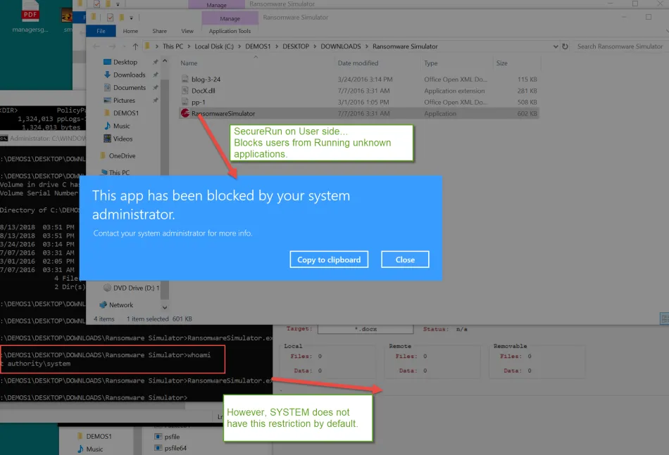

When you apply SecureRun on the user or computer side, you're saying "Block all untrusted executables started by users." But this does not, by default, block the attack vector of the System performing the attack. You can see the example below where the Standard User is blocked from an executable attempt, but System is still allowed.
319_4_faq-img-04_950x647

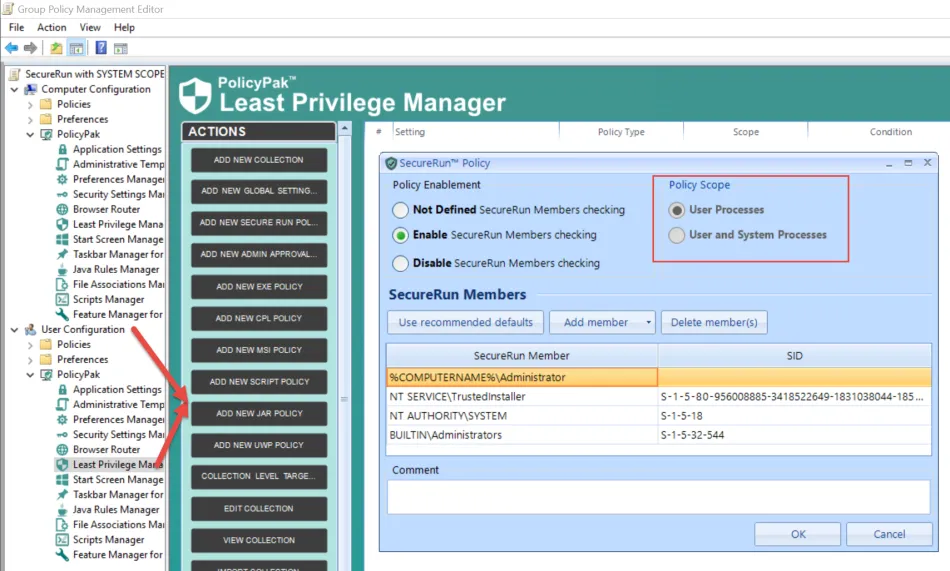

However, you can switch SecureRun on the computer side to now say "Block all untrusted executables started by users or LOCAL SYSTEM." You would do this on the Computer side, and specify User and System Processes, as shown below.
319_5_faq-img-05_950x547
The result is that both User and System attempts to run un-trusted executables will be prevented.

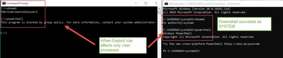

Scenario 2: Specific rule to block an app from being run, even as local System.
You might want to explicitly block attack vectors such as PSEXEC (which was used in WannaCry), or entirely block PowerShell.  If you specify to do this only on the User side (or set Computer side scope to User processed only), then only user processes will be affected:
319_6_faq-img-06_950x195

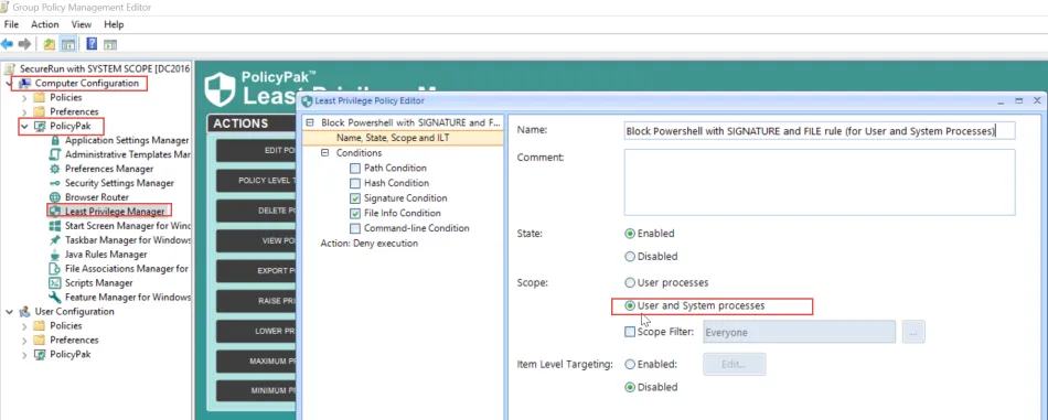

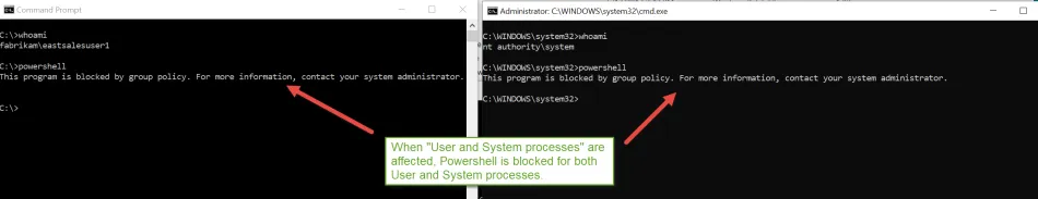

You can shore up this attack vector by making the explicit deny rule on the Computer side:
319_7_faq-img-07_950x381
When you do,  this happens:
319_8_faq-img-08_950x183

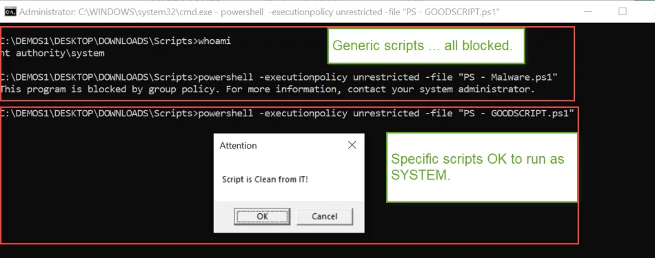

Scenario 2B: Block Powershell.exe completely, but allow Local System to run a specific .PS1 script
In the previous example, we blocked Powershell (or PSEXEC, etc.) from all user and system processes.

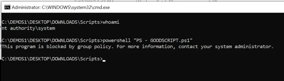

However, you might need to run some Powershell scripts as SYSTEM to perform some maintenance tasks.  Since PowerShell is now being blocked for all Computer side processes, you cannot run a specific script with PowerShel:
319_9_faq-img-09_950x271

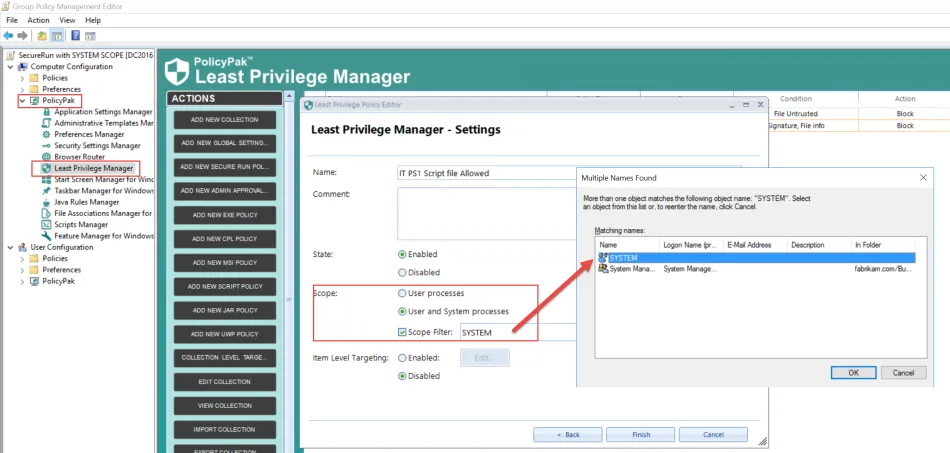

To enable this, simply add another rule to ALLOW AND LOG, for example, C:\SCRIPTS\ITSCRIPT1.ps1, and set the scope to User and System processes, but use the scope Filter to SYSTEM.
319_10_faq-img-10_950x453
Result:
319_11_faq-img-11_950x375

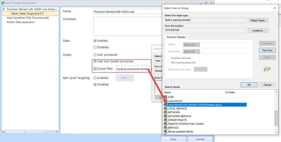

In this scenario you want to do work with Endpoint Policy Manager Least Privilege Manager (Elevate, Allow, or Block) but prevent other admins (local admins or domain admins) from overcoming your rule.
To perform this, you'll need to apply these two rules:

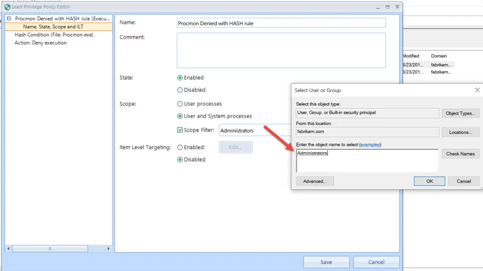

  1. First one BLOCKS ABC.EXE or ABC.CMD or ABC.MSI. This must be done on the COMPUTER side with SCOPE = USER AND SYSTEM. Then, filter the scope by group (more on this in a second.)
  2. Second rule ALLOWS or ELEVATES ABC.EXE or ABC.CMD or ABC.MSI. The scope doesn't matter. You can do this on the COMPUTER or USER side. (leaving the default filters in place.)
If you want toblock only LOCAL admins (but not domain admins) then Rule #1 needs to look like this. (Note that this group is not available when editing a GPO from a DC, and only available when creating the GPO from a Windows 10 computer):
319_12_faq-img-12_950x482
If you want toblock both local admins and domain administrators, then Rule #1 needs to look like this.
319_13_faq-img-13_950x534

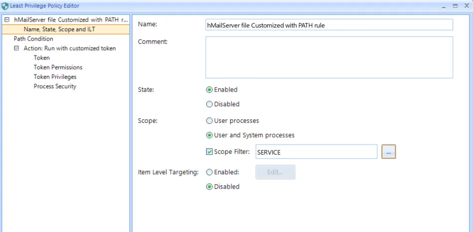

Scenario 4:  Elevating a Service account
You might have a service which requires specific privileges. Maybe your service, by default, uses Local System, and you want to give it less rights.
With Endpoint Policy Manager Least Privilege Manager, you can remove the powerful privileges of the service account and strip out LOCAL SYSTEM and grant a specific user the permissions required.
If you want a process to be run via special user account, follow these steps you would need to do the following:
Step 1 – Make a rule for an .exe from which the service runs.
We recommend to make a File Info + Signature rule, but PATH rules would work as well.
e.g. C:\Program Files\AppABC \AppService.exe
Step 2 – On the Actions page select "Run with custom token" and configure the TOKEN and/or exact PRIVILEGES the process needs like Load Driver Privilege (SeLoadDriverPrivilege), Bypass Traverse Checking (SeChangeNotify).
Step 3 – On the final page select Scope = User and System Processes
AND
Scope Filter should be trimmed to the specific account you specified to run the service runs as.
NOTE: It's also possible to use Scope Filter = SERVICES to make the rule apply to all services that run from the specified .exe regardless of the user.
319_15_faq-img-15_950x467
