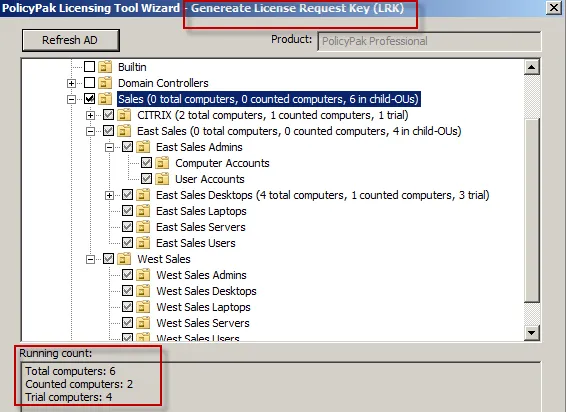

SOM_Name is the specific places you will be licensing Endpoint Policy Manager. This is what you are selecting here:

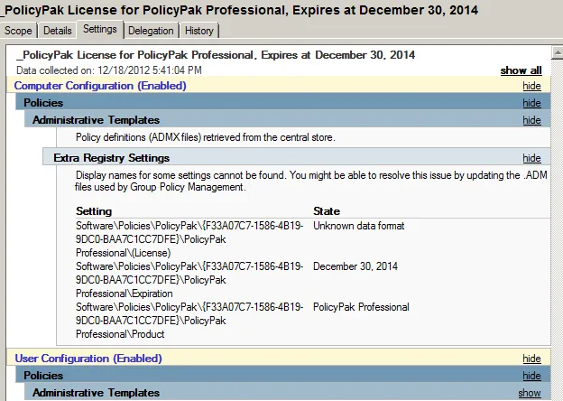

- The GPO that LT creates only has Endpoint Policy Manager Licensing Data(see image below).
- Having the license GPO linked won't affect servers or other clients. They'll get the data contained within the licensing GPO (which is nothing but licensing data). But then nothing special happens after that, especially since they're out of Scope of Management.

Here is the thing to remember: only computers in OU=Machines,OU=WEST,DC=fabrikam,DC=com are ever going to get licensed (today), because that's what you've selected in step 2 (Scope of Management).
So again, even though the GPO is linked to the domain level, only the computers in the Scope of Management will activate as Paid, because that's what you paid for.
