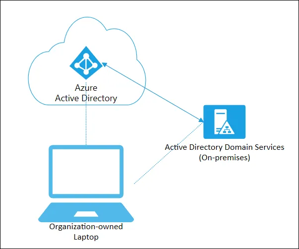

First of all, we here at Netwrix Endpoint Policy Manager (formerly PolicyPak) do not want to charge you twice. If a machine is joined to On-Prem AD and also joined to Azure AD (called Hybrid Azure AD joined), then you should only have to pay for the machine one time. Here is a Microsoft's diagram below (borrowed from https://docs.microsoft.com/en-us/azure/active-directory/devices/concept-azure-ad-join-hybrid ).

In this case, if you had exactly one machine like this ,you would need to:
  • Pay for one license (remember, you only need to pay once.) But…
  • Engage both PolicyPak licensing mechanisms for this computer: Endpoint Policy Manager Group Policy and Endpoint Policy Manager MDM.
We recommend you do not deliver the same Endpoint Policy Manager settings from both Group Policy or MDM. But you might want to enable the ability to get those licenses from both sources, then transition away from Group Policy to MDM over time.

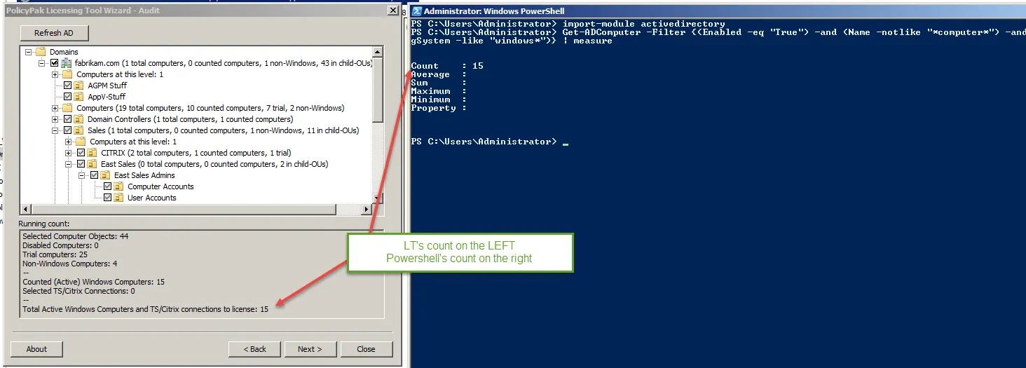

Step 1: Counting your on-prem AD & GPO machines
Typically, you do this with the Endpoint Policy Manager on-prem licensing tool (preferred), or if you need to, you can use PowerShell. SeeMy organization doesn't permit me to run the LT (Endpoint Policy Manager Licensing Tool) or provide the XML information it produces. What are my other options?

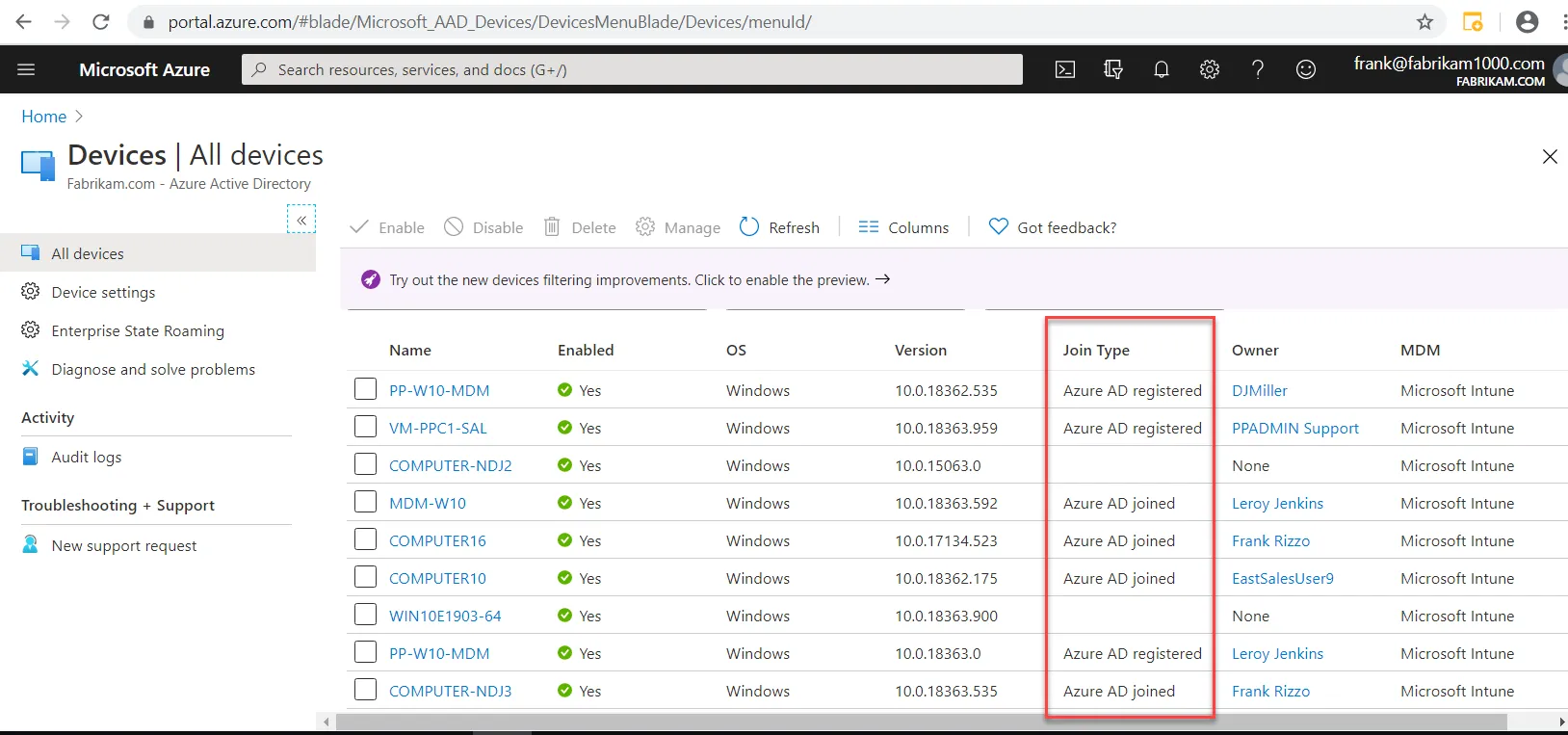

In Azure you can go to Devices > All Devices, then look at the Join Type. You should see four possible fields:
  • Azure AD registered —This is not required for aEndpoint Policy Manager license, as this is not Azure or MDM enrolled.
  • Azure AD joined — This means the machine is joined directly to Azure AD and is not Hybrid (that is, it is not also joined to on-prem AD).
  • Hybrid Azure AD Joined — This means the machine is joined both to Azure AD and to on-prem AD.
  • Blank: Unknown.
200_5_image-20200723102952-3
The problem is that you cannot count each type with this interface unless you have just a few machines. Instead you need to use Powershell and have it do the counting for you.

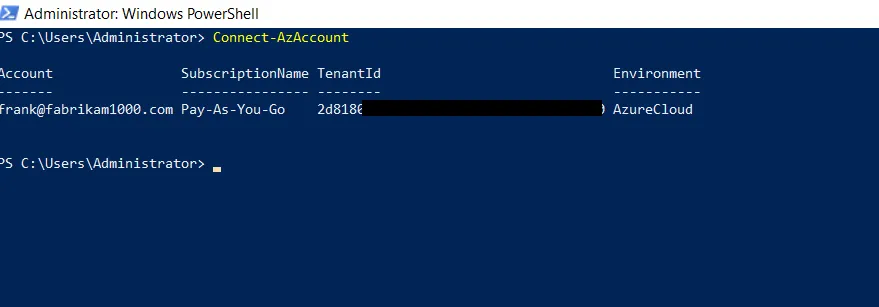

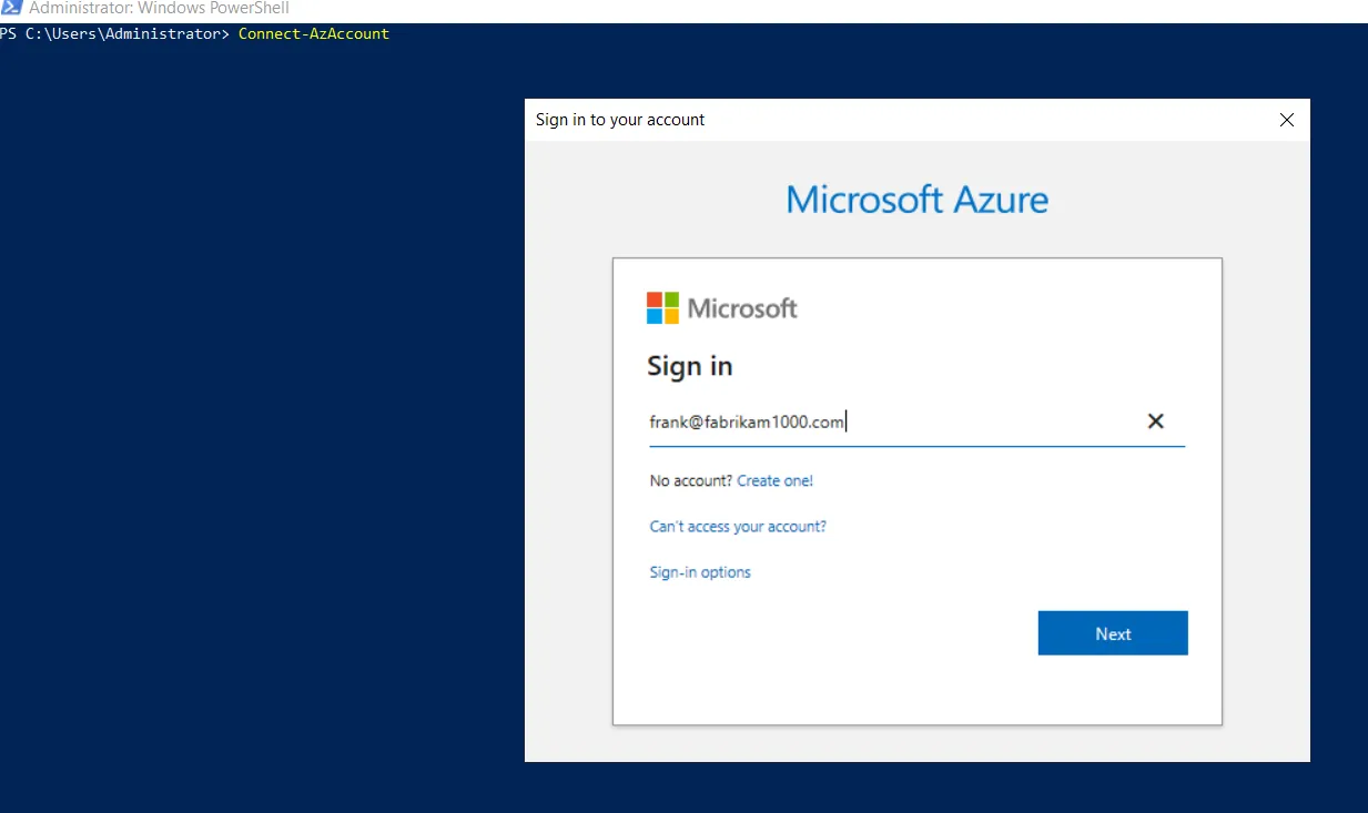

Start out with the Connect-AZAccount cmdlet (not shown). You will get prompted for credentials the first time.
200_9_image-20200724004807-5
The command should finish and return you with a result like this:
200_11_image-20200724004807-6

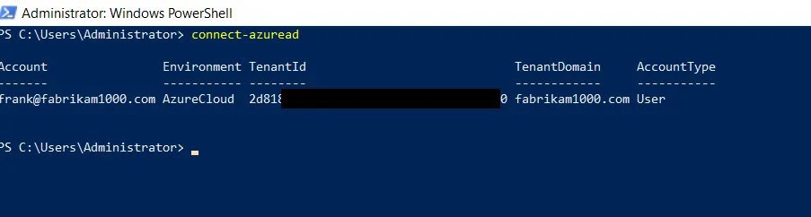

Then use the connect-azuread command and provide credentials again, for a second time.
200_13_image-20200723102952-5
Results of connection are then seen here:
200_15_image-20200723102952-6

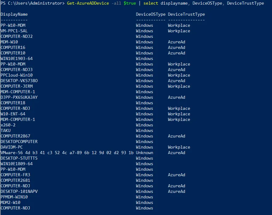

You can then list all Windows 10 devices with the following command:
Get-AzureADDevice -all $true | select displayname, DeviceOSType, DeviceTrustType
200_17_image-20200723102952-7

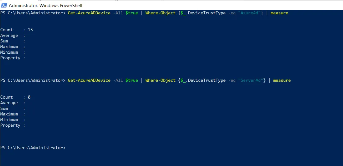

Step 2: Count your Joined to Azure AD only (but not on-prem domain joined machines)
To count Azure AD joined machines, run the first command:
Get-AzureADDevice -All $true | Where-Object {$_.DeviceTrustType -eq "AzureAd"} | measure
Step 3: Count Hybrid Azure AD joined machines (those joined to on-prem AD and also Azure AD)
To count your Hybrid Azure AD joined machines, run this command.
Get-AzureADDevice -All $true | Where-Object {$_.DeviceTrustType -eq "ServerAd"} | measure
Results of your counting:
Results examples are seen here:
200_19_image-20200723102952-8
