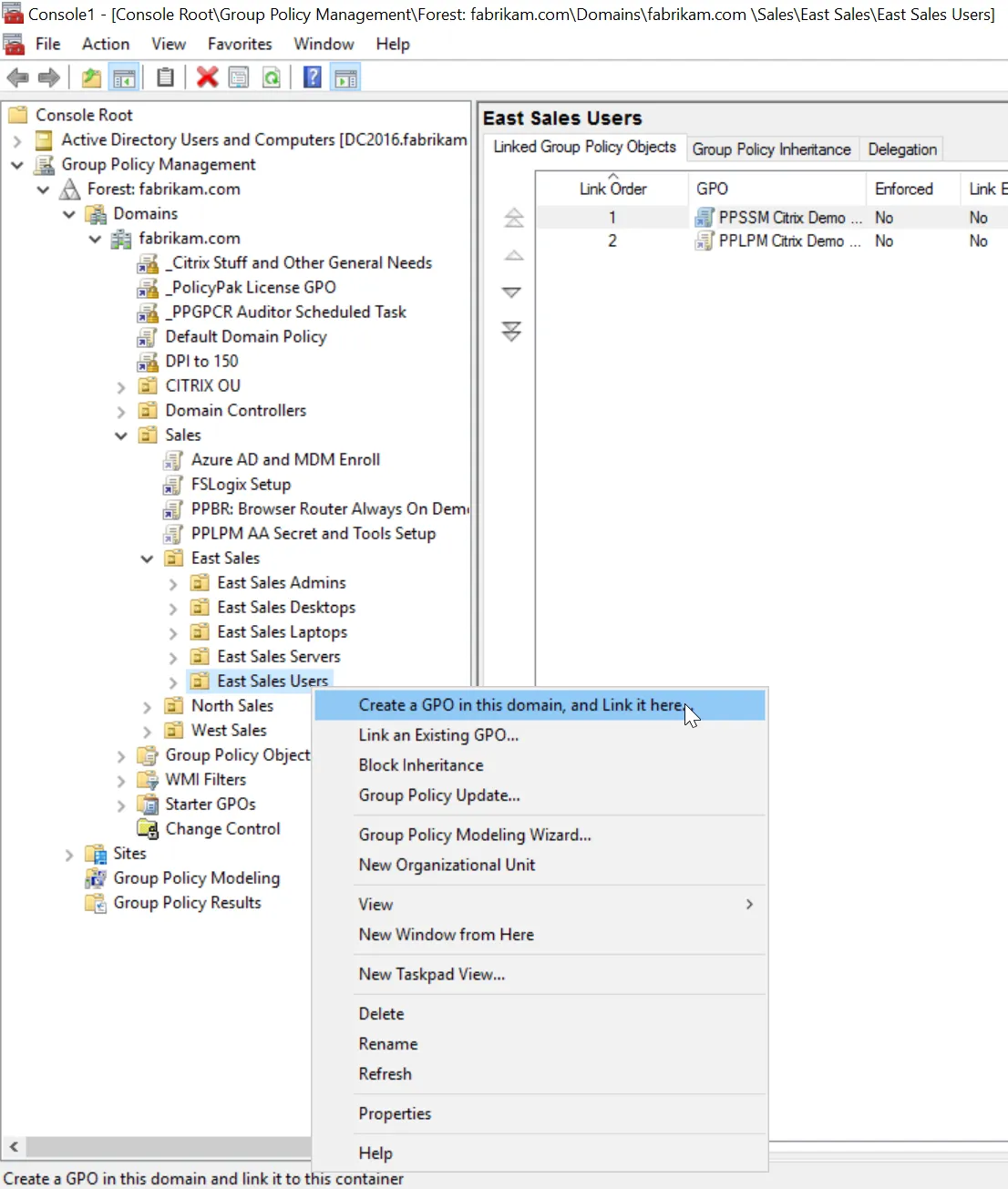

No Azure at all, using traditional Active Directory (usually with Server 2016, 2019, etc.)
In this case there is no Azure really involved at all. Instead, you are using the tried and true Active Directory running Domain Controllers, which comes with Group Policy. Typically, but not always, these servers are on-prem. We will explore the the idea that they don't have to be on-prem a little later.
In this case, you can license Endpoint Policy Manager with Endpoint Policy Manager Group Policy Edition or Endpoint Policy Manager Cloud Edition.

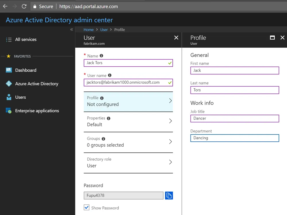

Azure Active Directory (also known as AAD) with or without an MDM service.
Azure Active Directory (AAD) is not the traditional AD in the cloud. It is a directory service which has a job to create identity to services.
It has no Group Policy and has no real device management. There are two ways you can use Azure AD: with and without an MDM service.

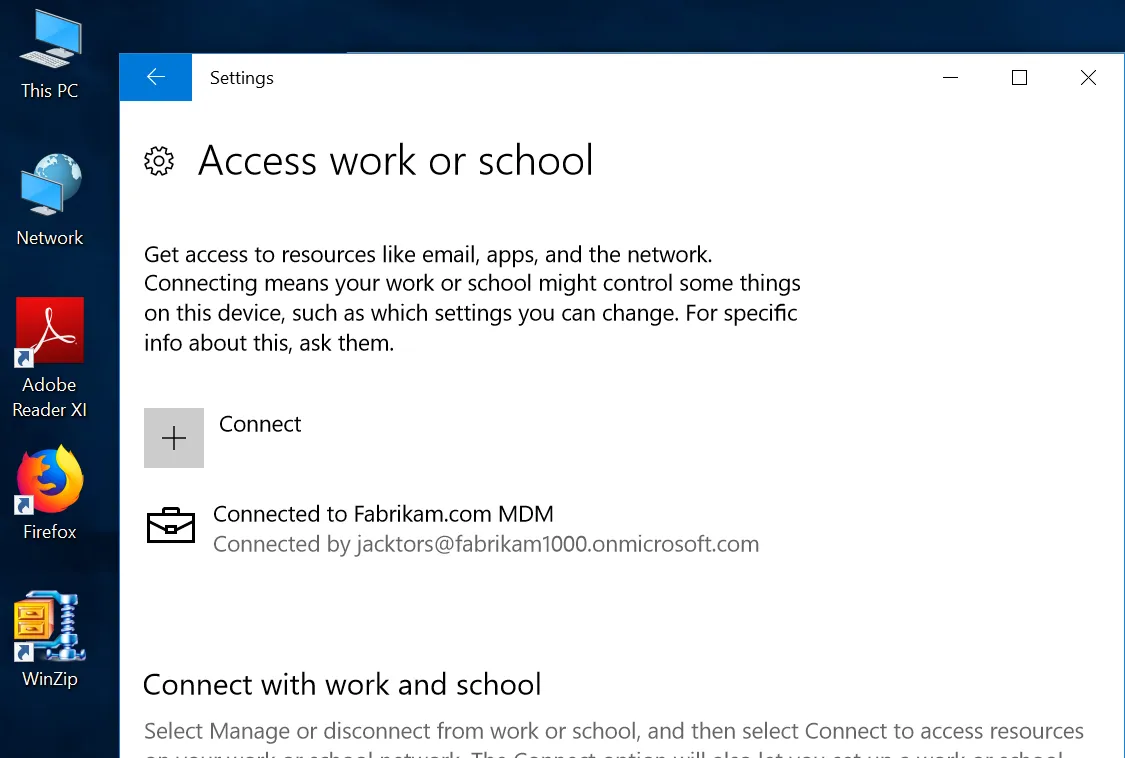

Here is what a machine looks like when it is MDM enrolled and registered in your Azure Active Directory.
As such, you might want to add Endpoint Policy Manager to your existing MDM service to give you the ability to take existing traditional AD Group Policy settings and migrate them to MDM. Additionally, you get all the Endpoint Policy Manager features as well.
