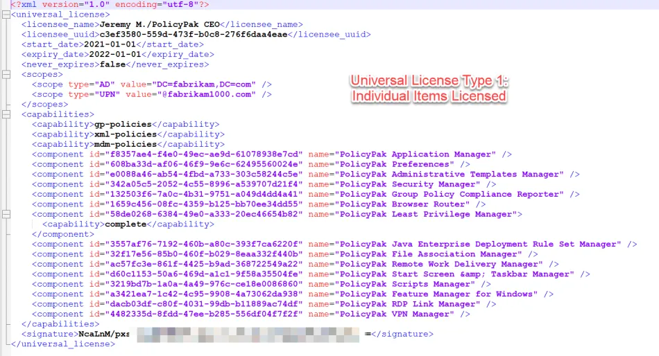

Type 1: Licenses which express specific components you are licensed for. For example:

How to modify Type 1 Licenses:
When your license expresses the specific components you are licensed for, you will see lines in the license file like this:
<component id="608ba33d-af06-46f9-9e6c-62495560024e" name="PolicyPak Preferences" />
And/Or
<component id="32f17e56-85b0-460f-b029-8eaa332f440b" name="PolicyPak File Association Manager" />
To make a specific component stop performing work and processing, you can modify the license for each component you want to affect, like this:
<component id="608ba33d-af06-46f9-9e6c-62495560024e" name="PolicyPak Preferences" enabled="false" />
And/Or
<component id="32f17e56-85b0-460f-b029-8eaa332f440b" name="PolicyPak File Association Manager" enabled="false" />
NOTE: For the last component in the section you need to use:
enabled="false" > instead of enabled="false" />
For example:
<component id="58de0268-6384-49e0-a333-20ec46654b82" name="PolicyPak Least Privilege Manager" enabled="false" >

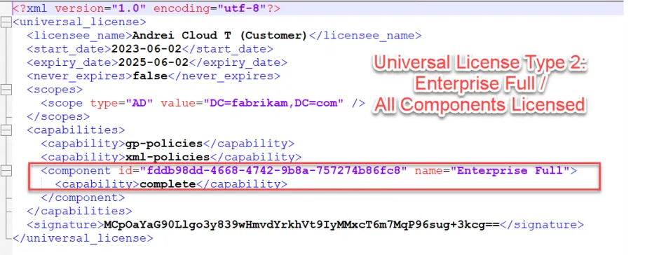

How to Modify a Type 2 License:
CAUTION: This procedure will only work when the endpoint is running a CSE build later than 23.8.
This is not expected to work on CSE 23.6 (which will accept Enterprise Full licenses, but will not
accept the <disabled>
block. Additionally, only MMC snap-ins 23.8 and later will accept Enterprise
Full licenses with the <disabled>
block.

<?xml version="1.0" encoding="utf-8"?>
<universal_license>
<licensee_name>Your Company </licensee_name>
<licensee_uuid>f5bc0afd-0280-495b-bfea-c6812f2361d1</licensee_uuid>
<start_date>2023-03-15</start_date>
<expiry_date>2026-03-15</expiry_date>
<never_expires>false</never_expires>
<scopes>
<scope type="AD" value="DC=fabrikam,DC=com" />
<scope type="UPN" value="*@fabrikam1000.com" />
</scopes>
<capabilities>
<capability>gp-policies</capability>
<capability>xml-policies</capability>
<capability>mdm-policies</capability>
<component id="fddb98dd-4668-4742-9b8a-757274b86fc8" name="Universal Product Component">
<capability>complete</capability>
</component>
</capabilities>
<disabled>
<component id="1659C456-08FC-4359-B125-BB70EE34DD55" name="PolicyPak Browser Router"/>
<component id="8a67684e-f09b-48dc-ad85-17c014ae5560" name="PolicyPak Preferences 2.0"/>
</disabled>
<signature>Mw9Fj+XXXXXXXXXXXXXXXXXXXXXXXXXXXXXXXXX==</signature>
</universal_license>

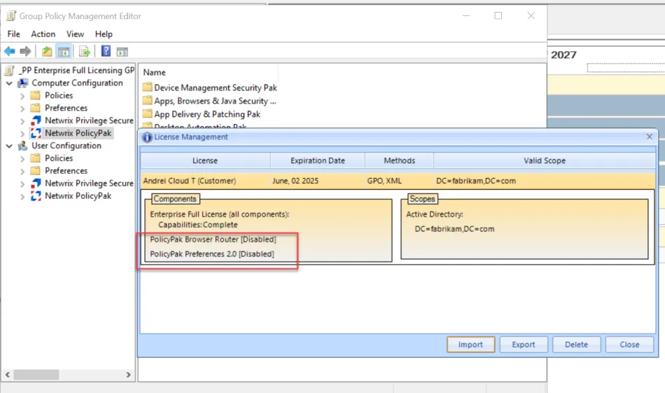

Next steps after License XML modification / Import into MMC Console
The license is now ready to deploy via any method, like Group Policy or MSI wrap-up for use with an MDM provider like Intune.
Note that the 23.8 and later MMC is preferred for any modified licenses that you've created. The MMC
console will express which components you have placed in the <disabled>
blocks.
The Group Policy Settings Report will also express this as well.

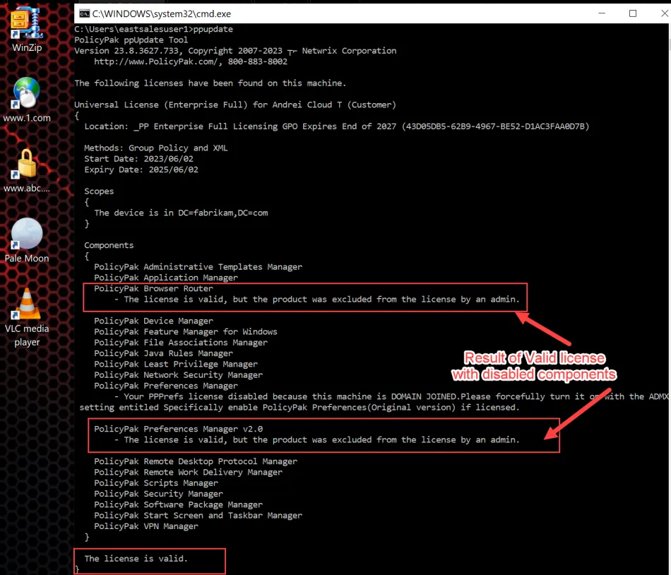

Result of unlicensing specific component(s):
After the computer picks up the new license (via GPO, MDM, etc.) you can verify via the
PPUPDATE
command if the computer will stop processing that component.
The result of modified components via blocked license can be seen in this example.
