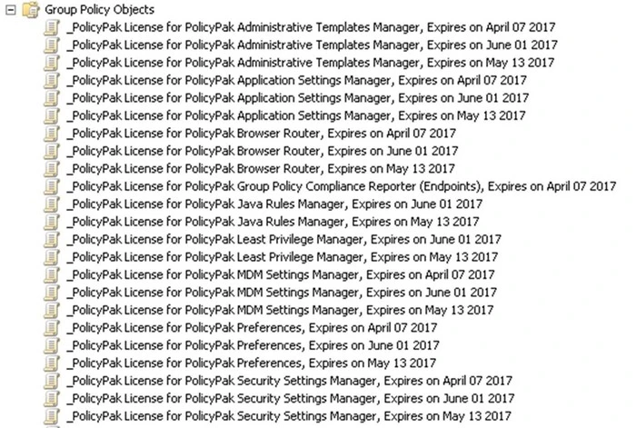

I just installed new license files / new GPOs. Should I keep or delete the old license files / GPOs?
You do not need to keep every license GPO around that is created by LT.
You can delete old/ expired licensing GPOs, as well as anything else you do not need found in this screen:
275_1_lt-faq-111
You have two options:
  • Option 1 — One GPO per component license, the latest license you have.
  • Option 2 — A single GPO with the latest component licenses you have.
