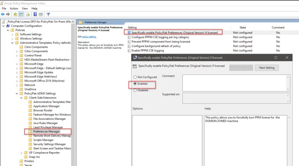

Your PPPrefs license is disabled because this machine is domain joined. Please forcefully turn it on with the ADMX setting entitled 'Specifically enable Endpoint Policy Manager Preferences (Original version) if licensed.'

Therefore, as an additional precaution to prevent conflicts in domain joined machines, staring in build 2682 this license must be set to ENABLED=TRUE (or omitted) and we now require this component (and only this component) to be explicitly enabled via ADMX setting, as seen below:
Starting with build 2682, it will now take two steps for Endpoint Policy Manager Preferences to be enabled:
Step 1 – The Universal license file must have the line
<component id="608ba33d-af06-46f9-9e6c-62495560024e" name="PolicyPak Preferences" enabled="true" />
or
<component id="608ba33d-af06-46f9-9e6c-62495560024e" name="PolicyPak Preferences"/>
Step 2 – The ADMX expressed earlier must explicitly be set to enabled.
Then and only then will Endpoint Policy Manager Preferences attempt to process GPPreferences items with domain joined machines.

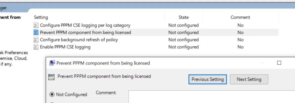

NOTE: If Endpoint Policy Manager Preferences license is disabled by ADMX policy (see below), then PolicyPak Preferences will always be unlicensed and disabled (even if the aforementioned Specifically enable PolicyPak Preferences (Original version) if licensed ADMX setting is set.
