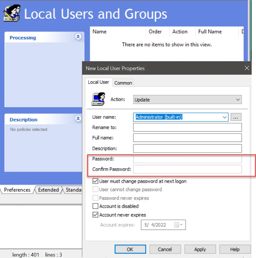

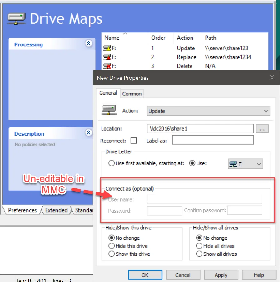

Step 1 – If you want to use a Group Policy Preferences item along with a password field, start by populating your Preferences item (on-prem recommended) with as much data as you can, noting that the Connect as (or other fields) are not changeable in the MMC editor. Below are two examples.

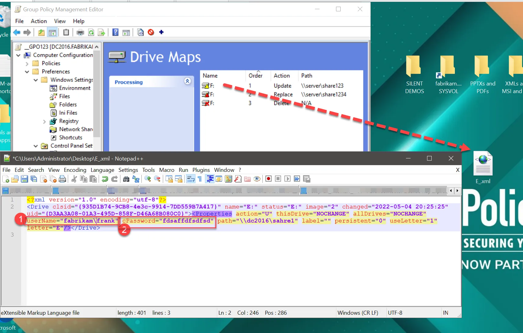

Step 2 – Once you have the item, drag it to the desktop and open it for editing.  The goal is to enter the missing details by hand, typically the cPassword field.
916_3_image004
Step 3 – To do get a cPassword, you need to provide an encrypted value in quotes.
