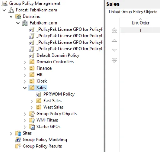

Start out on your GPMC management station by creating a group policy object (GPO) and linking it to your users. In this example we have a GPO created and linked to the East Sales Users organizational unit (OU).
