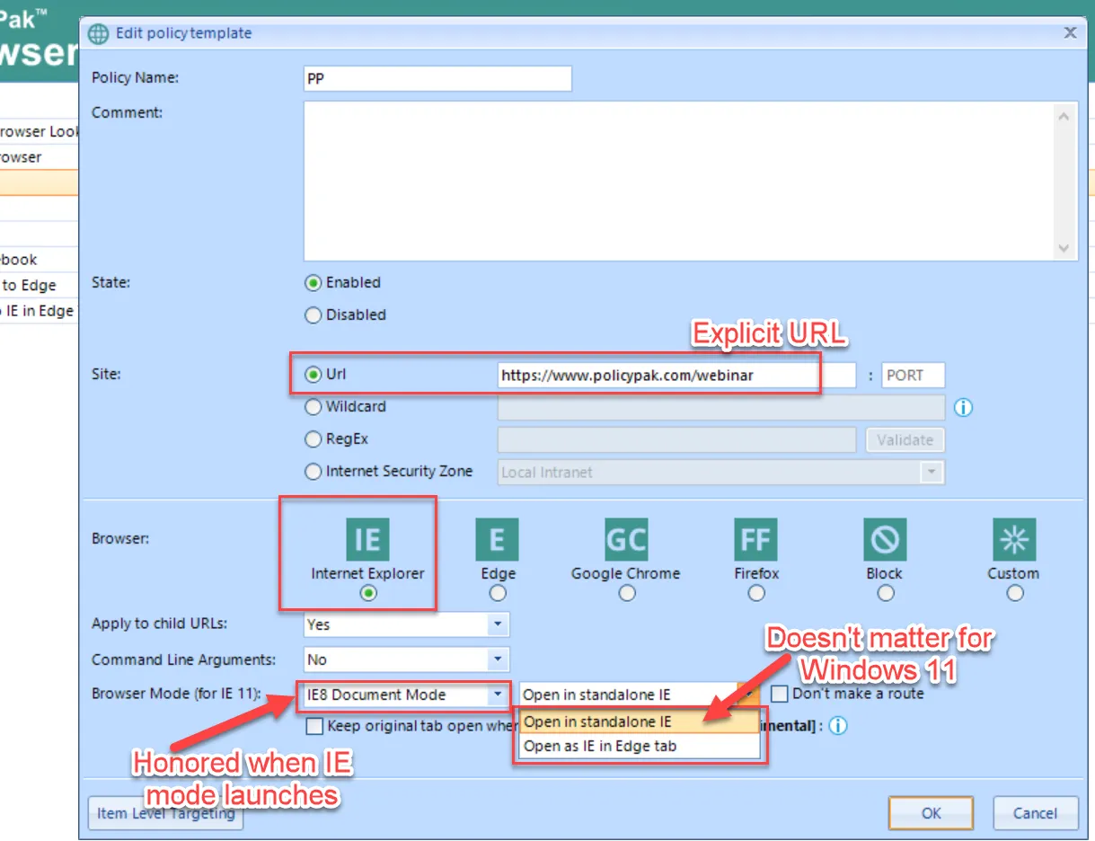

Example 1: Explicit URL specifying Internet Explorer.
If you have an explicit route to a URL and specify Internet Explorer, Endpoint Policy Manager Browser Router will attempt to invoke IE in Edge mode. An explicit route could be something like https://www.endpointpolicymanager.com/webinar.
An example can be seen below. Note it doesn't matter if the pulldown is set for Open in standalone IE or Open as IE in Edge tab is set. Those settings only matter for Windows 10 and are ignored in Windows 11.

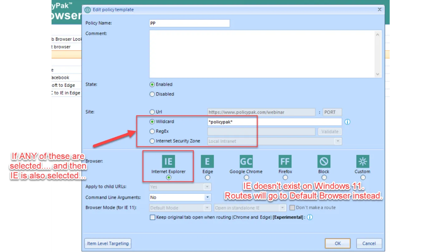

Example 2: Using Wildcards (or RegEx or Internet Security Zone) and attempting to set the browser to Internet Explorer
Since there is no IE 11 in Windows 11, existing routes set like what's seen here cannot work as expected.
Starting with Endpoint Policy Manager CSE 3068 on Windows 11, Endpoint Policy Manager Browser Router will route these to the Default Browser.

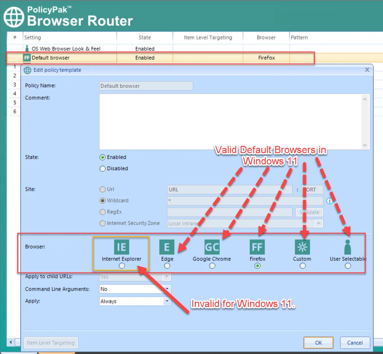

How are Default Browser Policies handled (With Windows 11)?
Note there is a Endpoint Policy Manager Browser Router policy to set Default Browser which you might have already set. Windows 11 and Endpoint Policy Manager CSE version 3068 and later will see this and make a decision accordingly if you've set this to Internet Explorer.
NOTE: Windows 10 will honor the Internet explorer setting, but Windows 11 needs to have a plan.
- If you use Endpoint Policy Manager Browser Router to specify a Default Browser (Edge, Chrome, Firefox, Custom, or User Selectable), you will get what you expect.
- If you have selected nothing (that is, you have no Endpoint Policy Manager Browser Router Default Browser policy) then the default will be the User's selected browser.
- If you select Internet Explorer as your Default Browser, then CSE version 3068 and later on Windows 11 will choose Edge automatically.
- If you select a Default Browser (like Firefox or Chrome) but the browser is absent on the machine, Endpoint Policy Manager CSE version 3068 and later on Windows 11 will choose Edge automatically.
