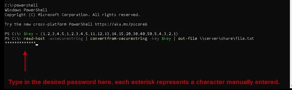

Create the password file:
$key = (1,2,3,4,5,1,2,3,4,5,11,12,13,14,15,20,30,40,50,5,4,3,2,1)
read-host -assecurestring | convertfrom-securestring -key $key | out-file \\server\share\file.txt

If running PowerShell from CMD:
923_2_image-20221221103111-2

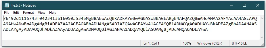

The resulting encrypted password is then stored at a secure location that is accessible from the endpoints (in this case a file on a secure network share (\\server\share\file.txt).
923_3_image-20221221103111-3

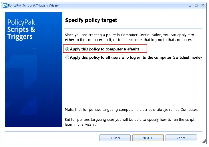

The next step is to create a computer side PowerShell policy in Endpoint Policy Manager Scripts & Triggers.
923_4_image-20221221103111-4

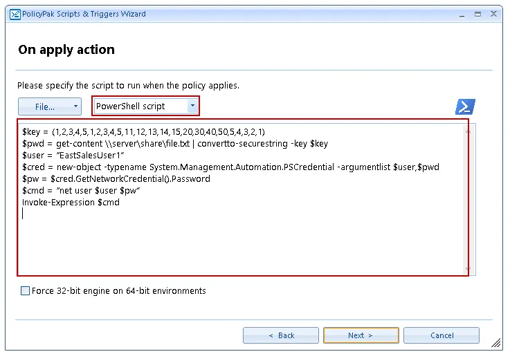

Then at the "On Apply action" screen choose PowerShell script for the type of script from the dropdown, and then paste in the script below after editing it to reflect your Security Key, and the corresponding local username on the endpoints in your environment that you wish to update.
$pwd = get-content \\server\share\file.txt | convertto-securestring -key $key
$user = "EastSalesUser1"
$cred = new-object -typename System.Management.Automation.PSCredential -argumentlist $user,$pwd
$pw = $cred.GetNetworkCredential().Password
$cmd = "net user $user $pw"
Invoke-Expression $cmd
This script will read the file.txt from the secure network share and then use that information to update any local user account you have defined in your script.
In the example below we are setting the password for a local user called "EastSalesUser1", see $user below).
923_5_image-20221221103111-5
