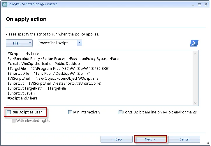

Step 6 – At the "On apply action" screen select "PowerShell script" from the dropdown.
Step 7 – In the main text window, paste in the script below and then click "Next".

Step 8 – Before clicking "Next" make sure that the "Run script as user" option is unchecked.
