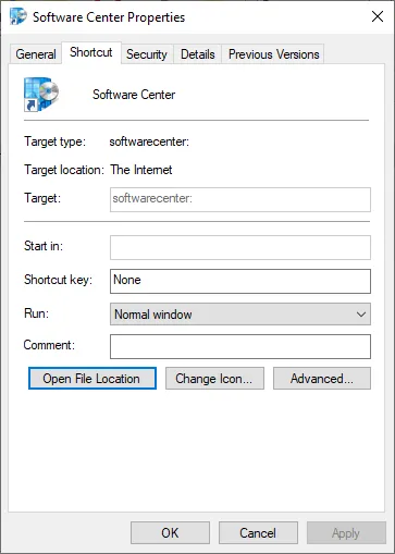

The normal shortcut for the SCCM Software Center looks like this; but Netwrix Endpoint Policy Manager (formerly PolicyPak) Start Screen & Taskbar Manager doesn't support this kind of link.
However, you can perform the following steps instead to get the same effect.

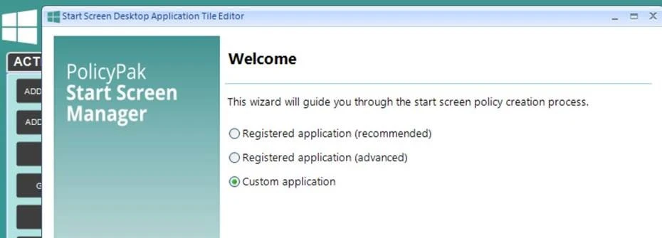

Using Endpoint Policy Manager Start Screen or Endpoint Policy Manager Taskbar Manager, create a link
for a Custom application like this…

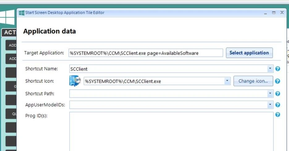

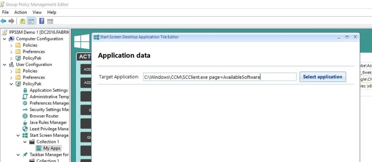

Then, point it toward
%SYSTEMROOT%\CCM\SCClient.exe page=AvailableSoftware
Like what's seen here.

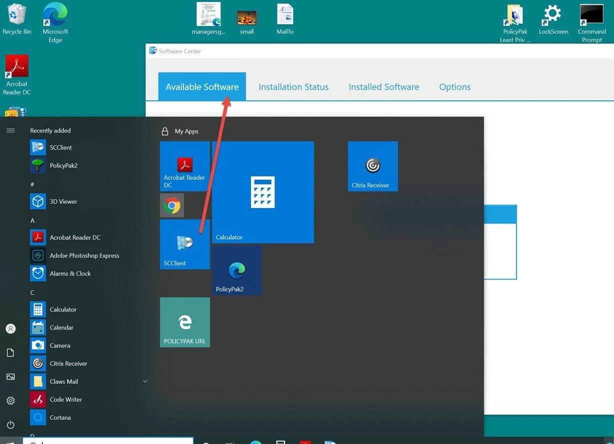

Final results should look like this…
