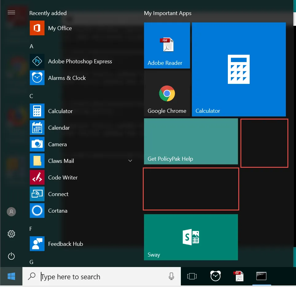

Option 1 - Gap: In Figure 39 blank areas that have been "gapped" are highlighted in red. This is where the icons would go when the application is correctly deployed to the endpoint.
collections_policy_settings_6
Figure 39. Using the gap placeholder mode.

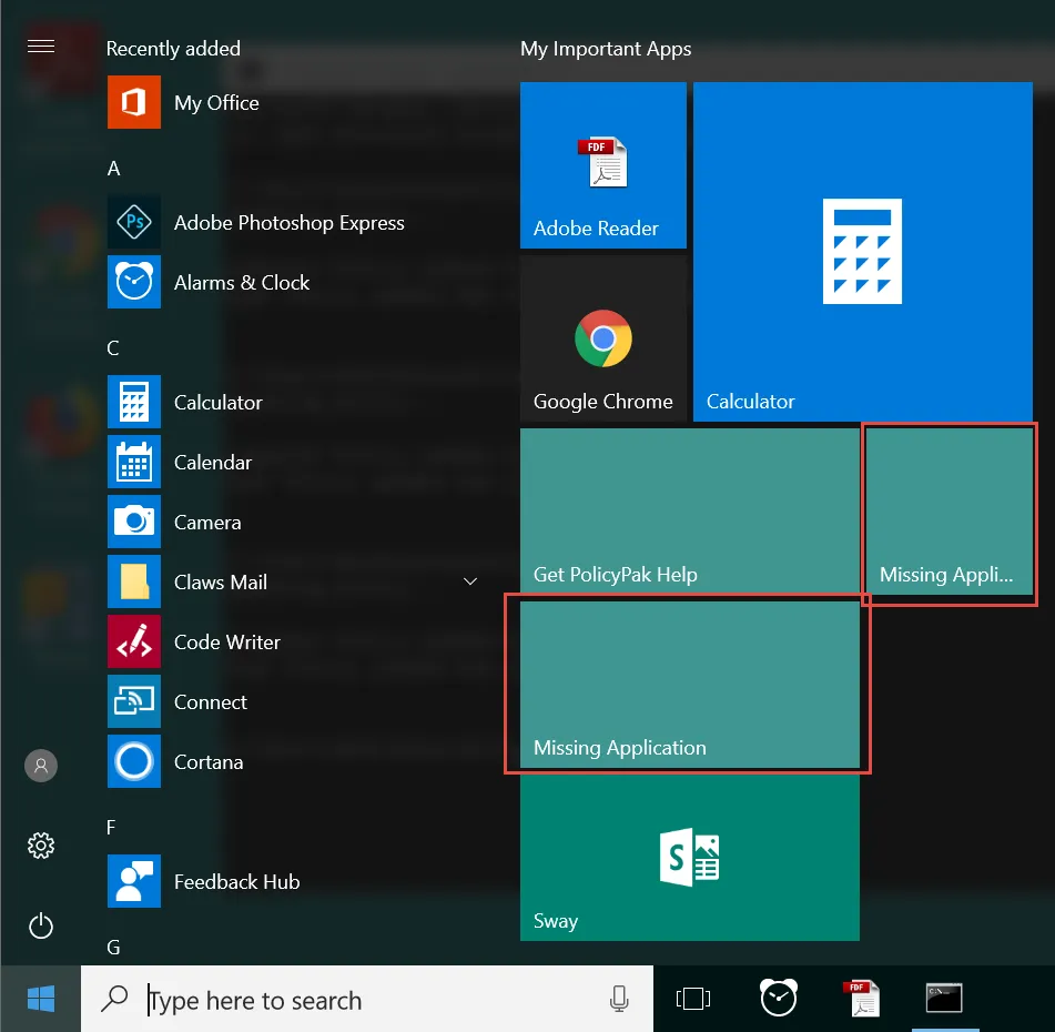

Option 2 - Edge Link: In Figure 40, missing applications are noted with the words "Missing Application" (highlighted in red).
collections_policy_settings_7
Figure 40. Using the Edge link placeholder mode.

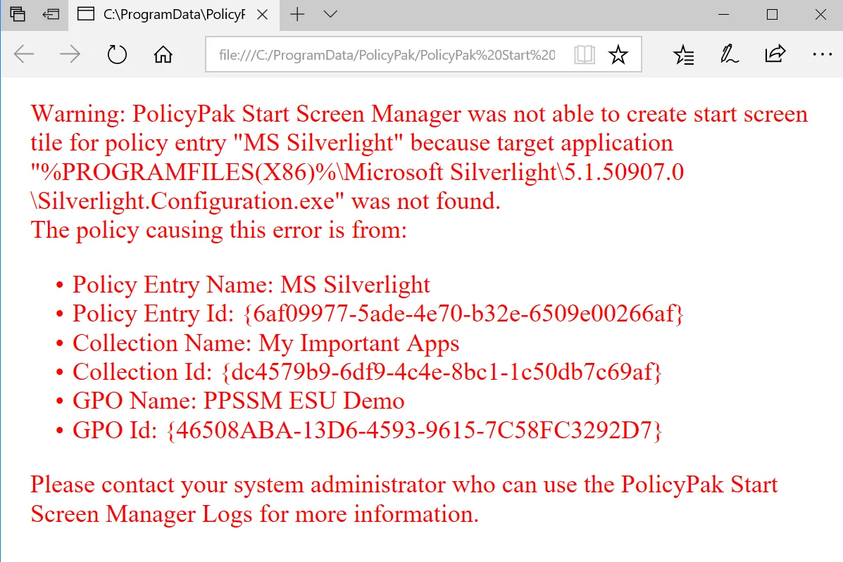

When you click the Missing Application tile, you are alerted to the nature of the error, as shown in Figure 41.
collections_policy_settings_8
Figure 41. Details of an error when Edge tiles are used.
In this way, users can tell you about missing applications and give you the diagnostic information you need in order to deploy the application or correct the Endpoint Policy Manager Start Screen policy.

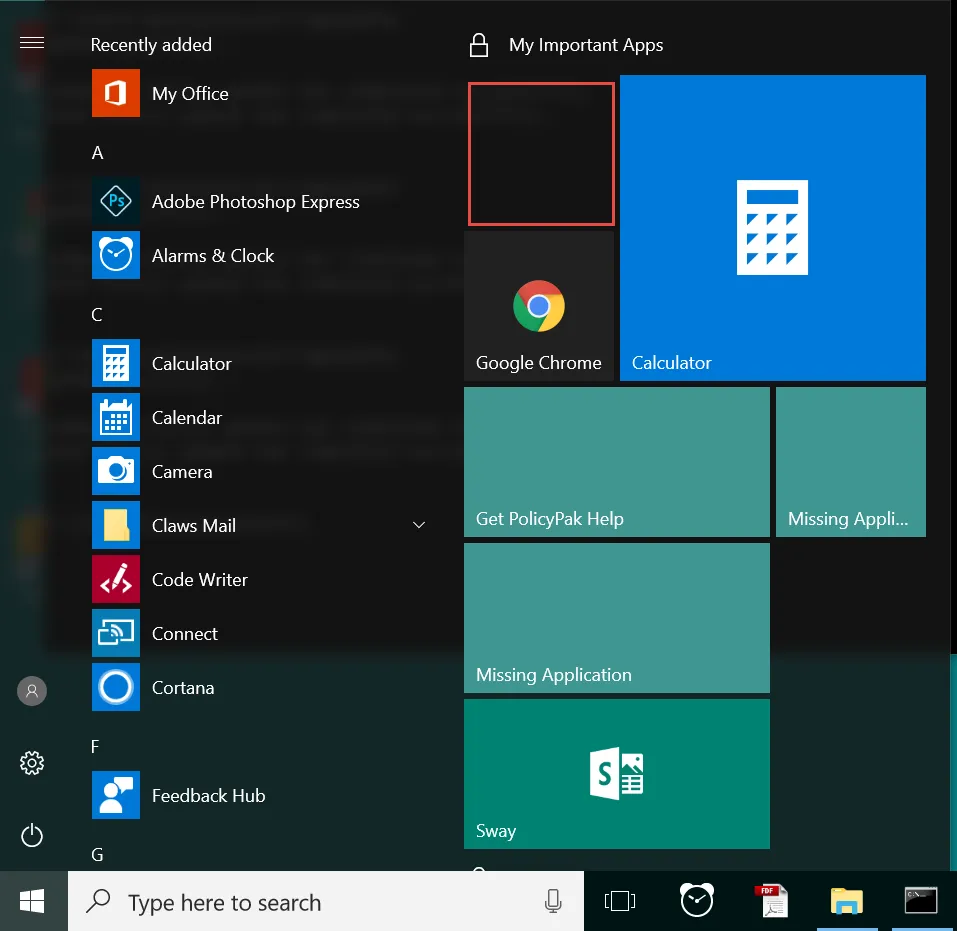

One extra note here about missing applications is that if Item-Level Targeting is used on an application icon, and it evaluates to FALSE, then the result is always a gap. For instance, if you wanted Adobe Reader to only appear when the machine was a laptop, but you were really using a desktop (evaluated with Item-Level Targeting), then the result would be as shown in Figure 42.
collections_policy_settings_9
Figure 42. Applications with Item-Level Targeting evaluating to FALSE will always have a gap.
The application is not shown and there is no Edge tile to explain why. This is expected when Item-Level Targeting for an application tile evaluates to False.
