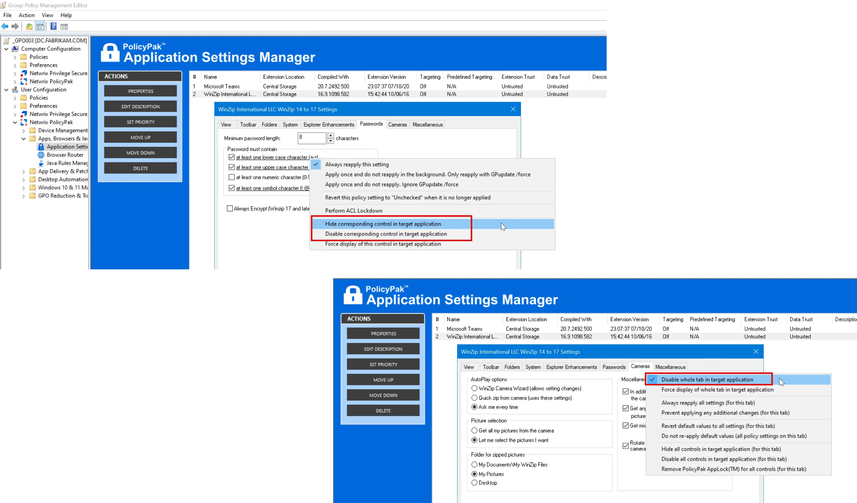

Its goal is to hide specific UI elements in Win32 applications, Eclipse IDE (aka Java Control Panel applets), and Firefox.
An example of hiding or disabling elements in a Win32 application can be seen here.

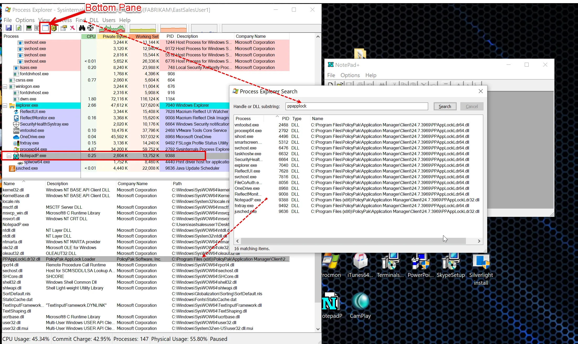

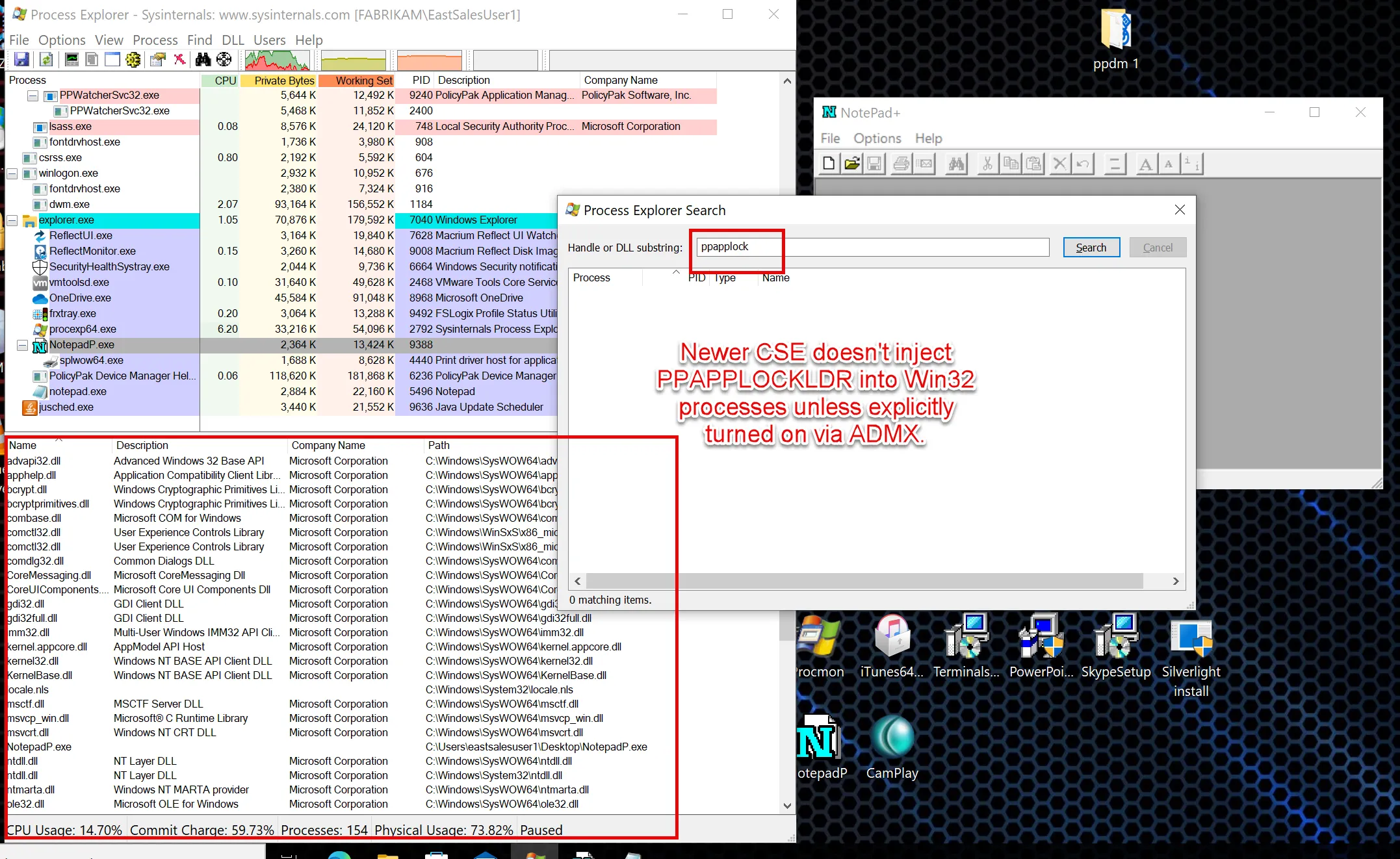

You can witness PPAppLockLdr64.dll injected into processes by using Process Explorer. An example can be seen here with Win32 app NotepadP. Using the Process Explorer Search you may also look for other hooked processes with PPAppLockLdr64.dll.
applock1
  • For CSEs before 24.9, AppLock is ON, and you might want to turn it off because of interference or because you are directed by Endpoint Policy Manager support.
  • Starting with CSE 24.9, AppLock is OFF, and if you want to turn it on you may do so to restore the functionality if needed.

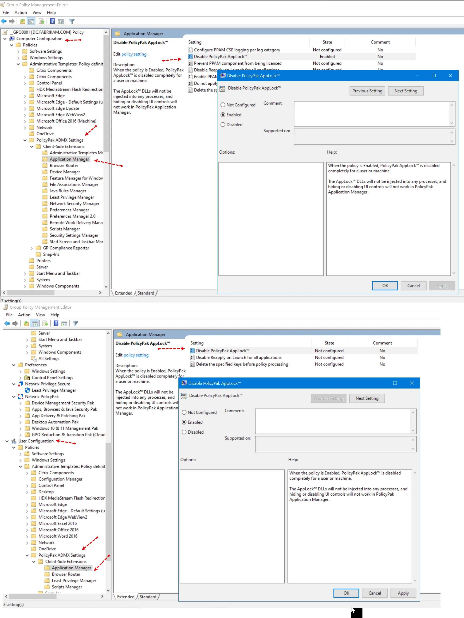

If you're using an older set of ADMX settings, you will find a setting named "Disable Endpoint Policy Manager AppLock" (which exists on both User and Computer Side):
applock5
When the "Disable Endpoint Policy Manager Applock(TM)" setting is set to "Enabled" this will TURN OFF the AppLock service for any CSEs. However, the state status of "Enabled" makes it unclear because you're "Enabling" a policy which disables a setting.

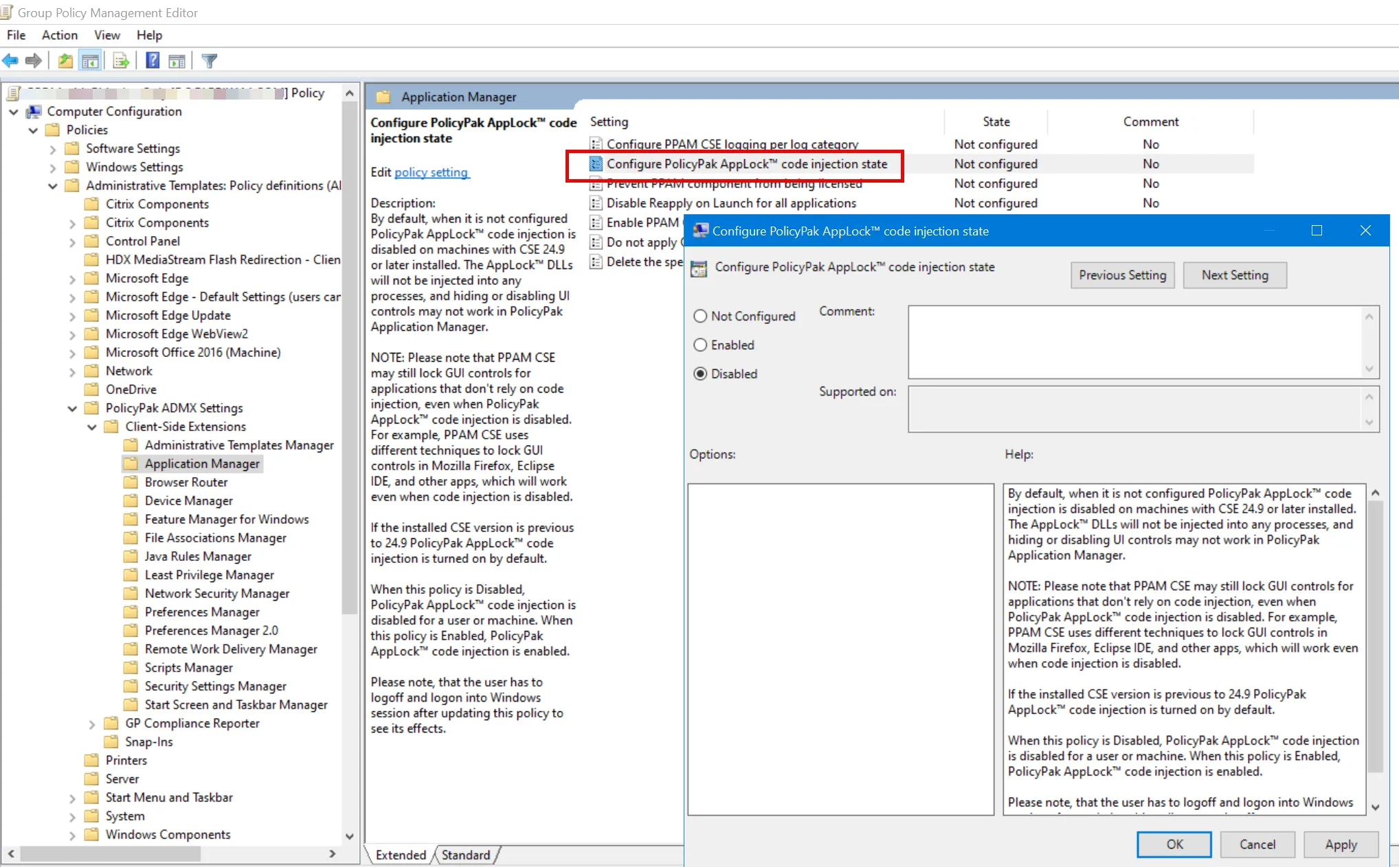

Therefore, if you're using newer ADMX settings, the setting has been renamed to "Configure Endpoint Policy Manager AppLock(TM) code injection state." And the setting will automatically be changed from the policy state of "Enabled" (which is unclear) to clearer, more obvious-to-understand-state of "Disabled."
Remember though that CSE 24.9 and later already has AppLock turned OFF so no specific action is needed here if you want the CSE to have this function off. However, if you wanted to re-enable it for CSE 24.9 and later, you would set this value to Enabled.
But again, if you were to upgrade older ADMX settings to newer ADMX settings, you will see a policy name change (to Configure Endpoint Policy Manager AppLock code injection state) and also a state change better reflecting the goals for disabling the AppLock service.
You will see this in a few places. When you edit the policy, you will notice the old policy is absent and replaced with the new policy name like what's seen here.

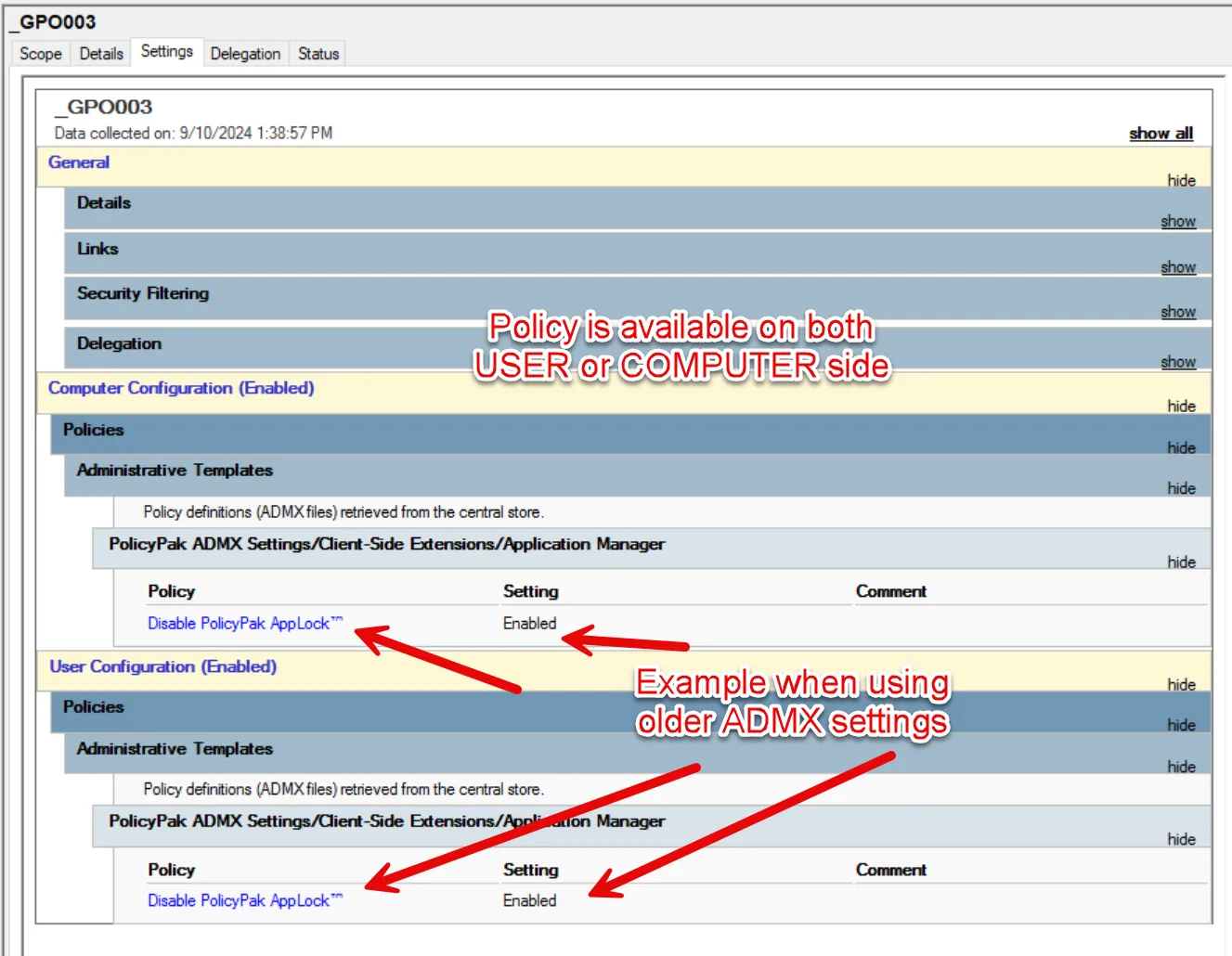

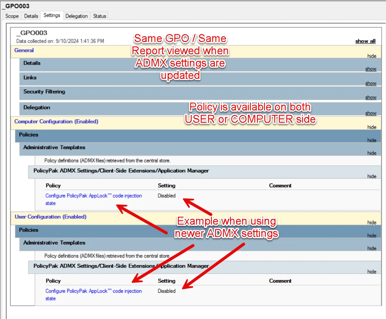

And, any existing GPOs with the old policy name will automatically start using the new policy name and new state. Here's an example GPO with the old name and old state:
applock7
applock8
NOTE: You might need to close the GPMC and re-open it to have the GPMC refresh the ADMX / ADML files and reflect a change. Then re-run the GPO setting report to verify your change.
