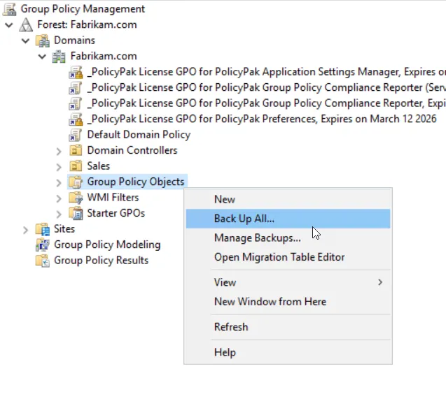

The Endpoint Policy Manager Application Settings Manager data inside a GPO is backed up and restored with normal GPMC backup procedures, as seen in Figure 90.
backup_restore_and_xml_export
Figure 90. Backing up data with normal GPMC backup procedures.
If a GPO is ever deleted, its data can be quickly restored using the GPMC's "Manage Backups" option, also seen in Figure 89.
When restoring, the Endpoint Policy Manager Application Settings Manager data and all the modes (Enforcement, Reversion, and Endpoint Policy Manager AppLock™) are restored.

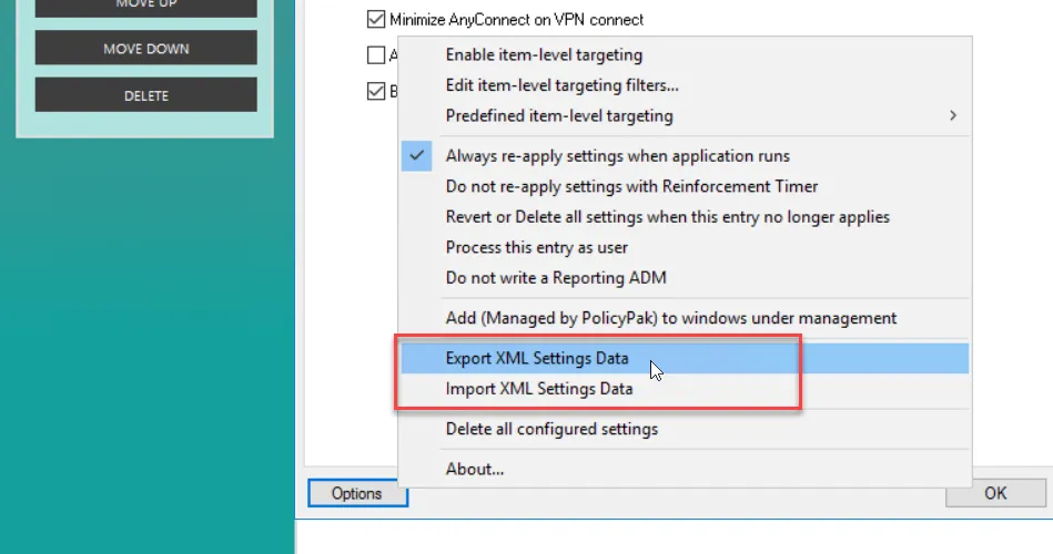

The exact settings you specified inside an AppSet within a GPO can be exported and imported. This might be useful if you have to test out different scenarios (perhaps again and again) but don't want to start fresh every time with the defaults you set within the AppSet. You might also want to configure a group of settings within an AppSet and share those exact settings with another administrator for later implementation.
The idea of exporting is simple: use your AppSet, set your settings, click on the Options button, and then select "Export" to export the data, as seen in Figure 91.
backup_restore_and_xml_export_1
Figure 91. The exact settings you specified inside a Pak within a GPO can be exported and, later, imported by selecting one of these options.
You will be prompted for a location to save your data. Be sure to give a name that makes sense for your AppSet, configuration scenario, or test case. Note that the file is an XML file and can only be used to import data into the same (or very similarly configured) AppSet. It cannot be loaded into the Endpoint Policy Manager DesignStudio or used for any other purpose.
When you're ready, you can reverse the process by using the Endpoint Policy Manager | Import function to import your previously exported settings. Note that an import will only change elements that are defined within the XML you are importing. That is, the import process may overwrite some existing values, and it may also leave existing values alone. Again, only values defined in the XML are changed upon import.
