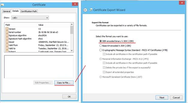

Step 3 – The most common reason certificates fail to import is because they are the WRONG FORMAT.
Endpoint Policy Manager only imports certificates which are ALREADY in what's called the BINARY DER format.
Full details on how to do this are in the document Endpoint Policy Manager Application Settings Manager – Using the Firefox Pak.PDF Located in the customer portal.
If you are UNSURE if your cert is BINARY DER or not, here's what you can do to ENSURE that it is BINARY DER.
If the CERT is a-ok inside Firefox ALREADY, you can then EXPORT it like this to ensure it is a BINARY DER file.
214_1_image002
When you save, save it as a .DER extension.

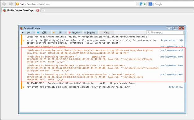

Step 5 – Is the Endpoint Policy Manager Firefox Plug in working?
You can also use Firefox's log by being on any page and clicking Ctrl+Shift+J.
In the log below certificates being added to the proper stores. You can also see ERROR CONDITIONS as well which are helpful for troubleshooting.
