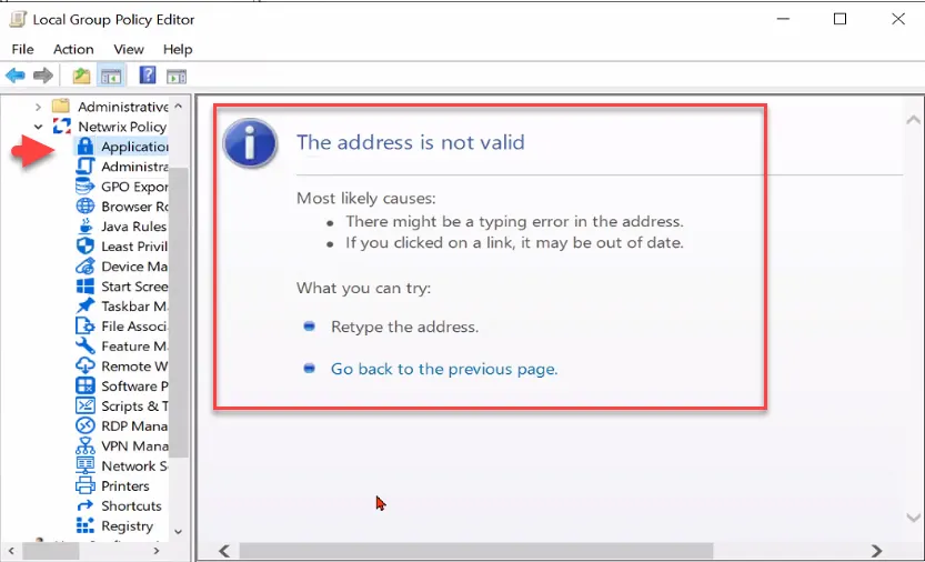

The node for Endpoint Policy Manager Application Settings Manager component is not loading in the MMC snap-in, and shows a "The address is not valid" message.
Problem:
The Endpoint Policy Manager Application Settings Manager (ASM) node is not visible or working properly in Group Policy Management Console (GPMC) and/or Group Policy Editor (GPEDIT).

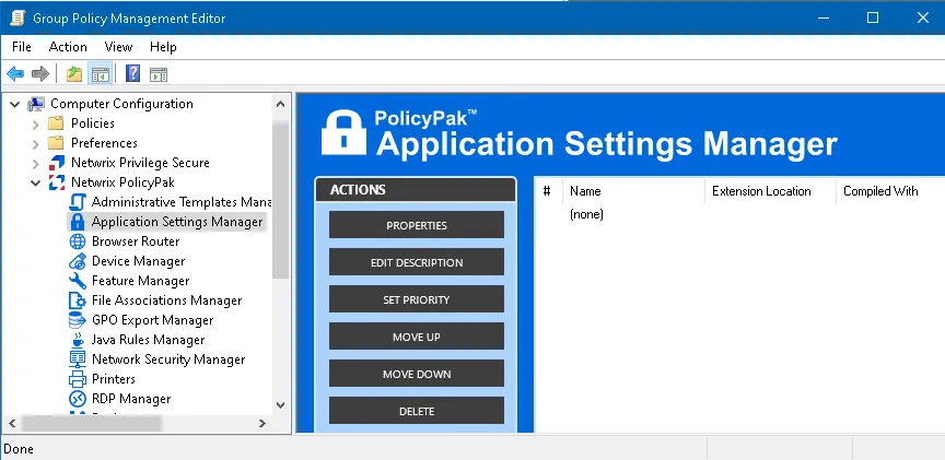

Step 4 – After reinstall, open GPMC or GPEDIT, and verify that the Application Settings Manager (ASM) node is now visible and functioning normally.
Step 5 – Now logout from the built-in administrator account and back in using a Domain Admin user account to test and confirm that the ASM node is visible and functioning normally in GPMC.
Step 6 – As a final verification step, log out of the Machine and log back in as the original user and confirm that the ASM node remained operational in both GPEDIT and GPMC.
The ASM node should look similar to screen shot below.
