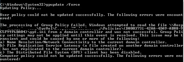

  • You should always begin by running gpupdate from the workstation that is experiencing inconsistent results. If you get a failure notice such as the one below, than there is a GPO delivery problem at large.
3_1_troubleshooting-grou-policy-replication2
NOTE:
It's very possible the first GPO to express an error one that contains Endpoint Policy Manager directives. But it's equally likely that it's another GPO as well.
