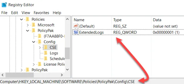

Go to HKLM\SOFTWARE\Policies\PolicyPak\Config\CSE\ and create a REG_DWORD named ExtendedLogs to a value of 1. An example can be seen in Figure 96.
troubleshooting_policypak_624x284
Figure 96. The creation and naming of REG_DWORD.
