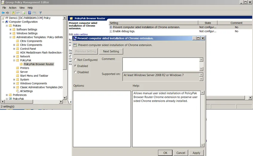

Then, the policy setting which must be applied to the computer side which is called PREVENT COMPUTER SIDED INSTALLATION OF CHROME EXTENSION

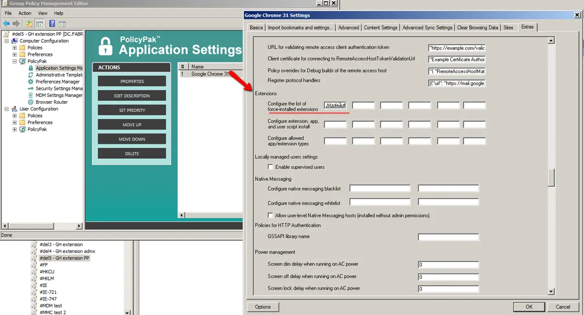

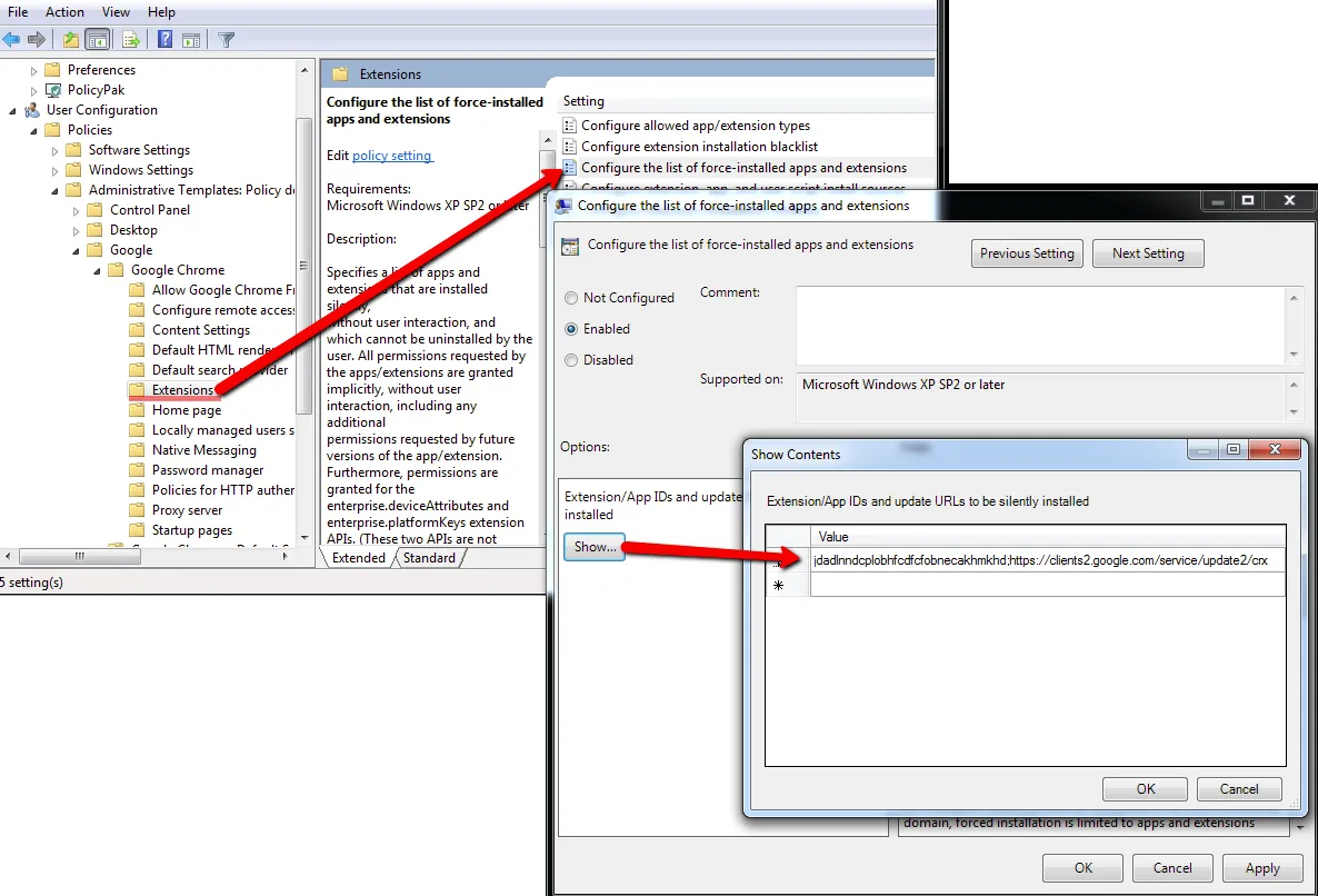

Then… Using Chrome's own ADMX setting named "Configure the list of force-installed apps and extensions" (seen below) to manually add the Endpoint Policy Manager Browser Router using Chrome's ADMX setting on USER or COMPUTER side.
171_2_image006
Use this string found in this article:
What is the Chrome Extension ID for all the published versions of Endpoint Policy Manager Browser Router Client Side Extension?
For instance, an example string might look like …
fmbfiodledfjldlhiemaadmgppoeklbn;https://clients2.google.com/service/update2/crx
Which will manually install the Endpoint Policy Manager Browser Router Chrome Extension. Or using Endpoint Policy Manager Application Settings Manager and our Chrome Pak, you can use this field (user or computer side.)
171_3_image009
Use the same string:
fmbfiodledfjldlhiemaadmgppoeklbn;https://clients2.google.com/service/update2/crx.
Which will manually install the Endpoint Policy Manager Browser Router Chrome Extension alongside the optional extensions you wish for Chrome.
