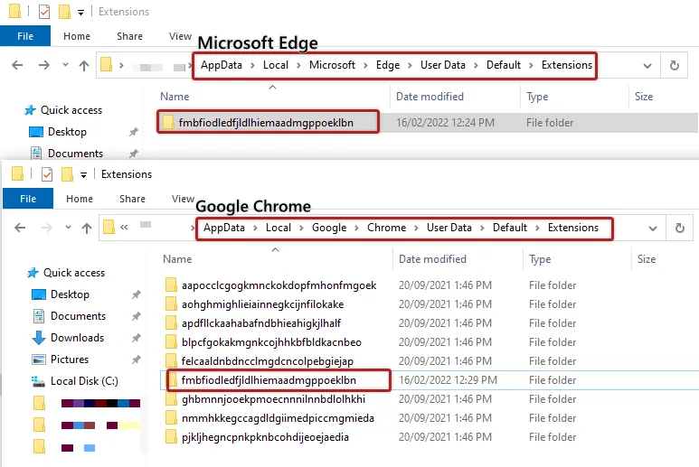

Step 1 – Remove the directory fmbfiodledfjldlhiemaadmgppoeklbn from %LocalAppData%\Google\Chrome\User Data\Default\Extensions\
Step 2 – Remove the directory fmbfiodledfjldlhiemaadmgppoeklbn from %LocalAppData%\Microsoft\Edge\User Data\Default\Extensions\

Step 1 – BR Extension folder location.
870_1_image-20220217002324-1

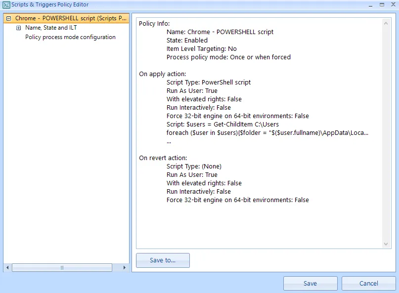

Step 2 – Create a User-side PP Scripts Manager policy. Use the Google Chrome PS script from PS Scripts section.
870_2_image-20220217002324-2

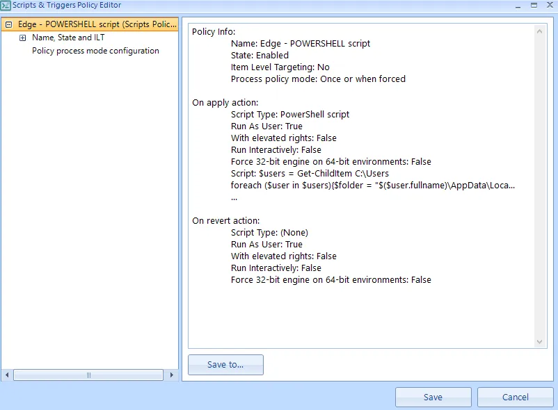

Step 3 – Create a User-side PP Scripts Manager policy. Use the Microsoft Edge PS script from PS Scripts section.
870_3_image-20220217002324-3

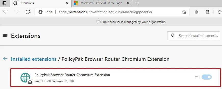

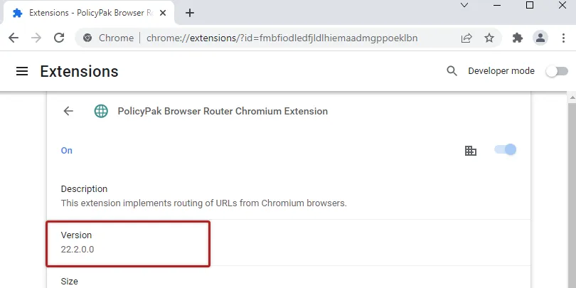

Step 6 – Verify the Endpoint Policy Manager Browser Router extension of each Browser as shown below.
Microsoft Edge:
870_4_image-20220217002324-4
Google Chrome:
870_5_image-20220217002324-5
