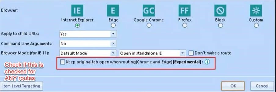

Step 3 – Check to see if this flag is set in ANY routes. A check here could "bleed" from one route into another website. This setting is not supported, and as such you might have to remove it from all routes.

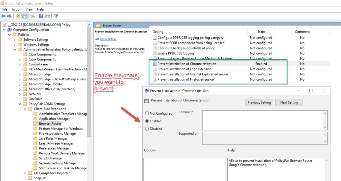

Step 5 – AFTER you install the latest CSE, you might want to attempt to disable the in-Browser Extensions for the affected browser, but keep Browser Router operating. Here's how to do that (see screenshot below.)
